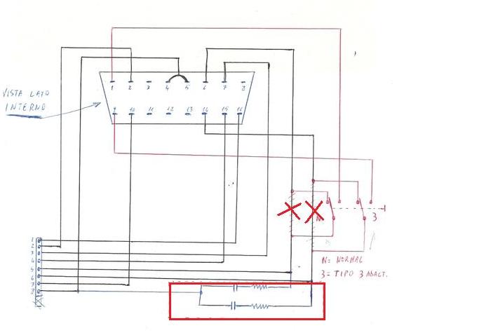

So I need to check if the connections between the board and OBD connector. Do you have the correct pinout (from 1 to 8 of the circuit)?
edit.. I found this: http://imageshack.us/photo/my-images/14/74476962.jpg Could you double check if it is correct? So I will check if it mine is the same.
Thanks!
Hello Laserbit
This information is wrong, not pin 8
What are the components in the red frame??
Have you added these components???
Remove this! This is wrong!
And also remove the lines with the red X, but you had already recognized.
Unbenannt markiert.jpg (28.24 KiB) Viewed 9662 times
laserbit
Posts: 10
Joined: 05 May 2013, 12:22
Post by laserbit »
Obviously the parts marked with X are the orginal connection that I removed with the Switch introduction, the other components are for the old ELM327, mine has such components already integrated on the back of the board. Now I tried to solder the wirescoming fro the board on pins 5 and 6 directly on the OBD pins 1 and 9, in order to exclude a switch malfunction. I will keep you updated on the test result! ;)

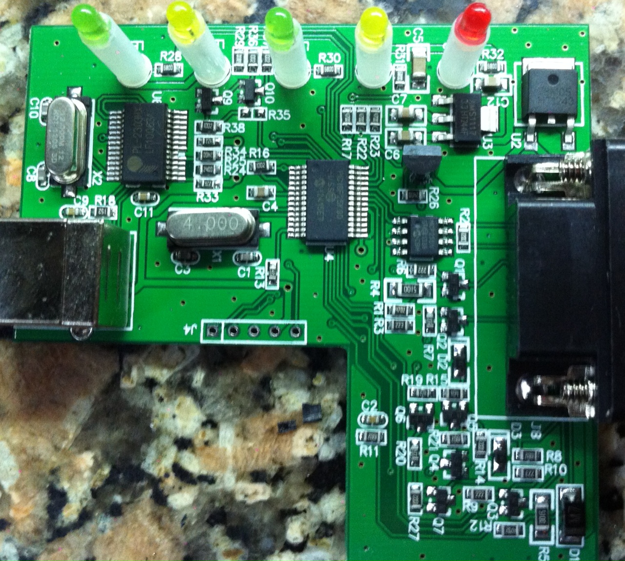

Hi, I have a V1.5a ELM327 with which I can communicate only to the engine. What do I have to change to enter the body? I attached the photo.
elm327 v1.5a
elm327 v1.5a
