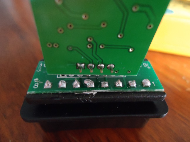

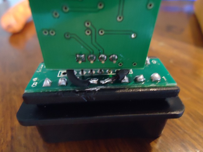

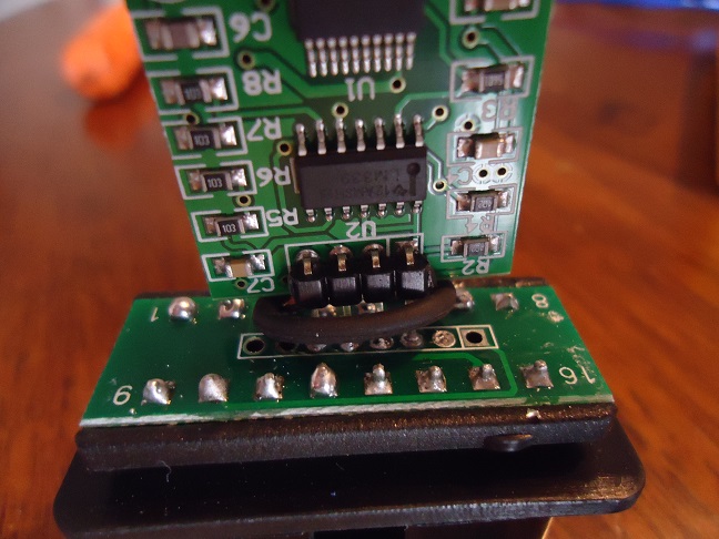

My 3 pin adapter connects chassis ground (battery negative) to pin 5 of female OBDC conector, but KKL Vag-com needs this connection to pin 4 (5 is idle). So, I made the bridge like follows: The other side of the board: Now, everything is working fine. So, if you must use this combination of cable adapter/KKL Vag-com interface be carefull about this pinnage issue.

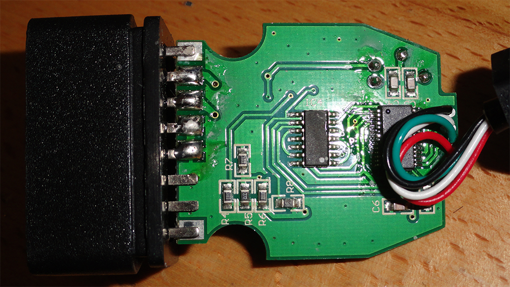

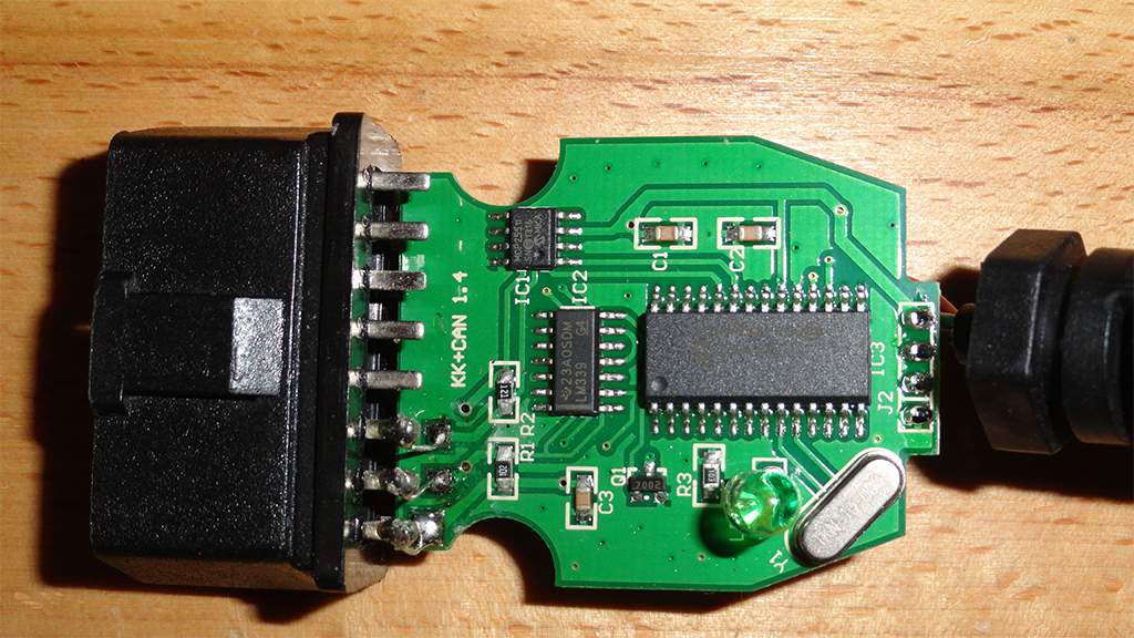

Hello, I have one VAG-K+Can 1.4 Full comander, she work good, but I have a quastion can I make somethink to work this interace with any version of VCDS? Thanks
