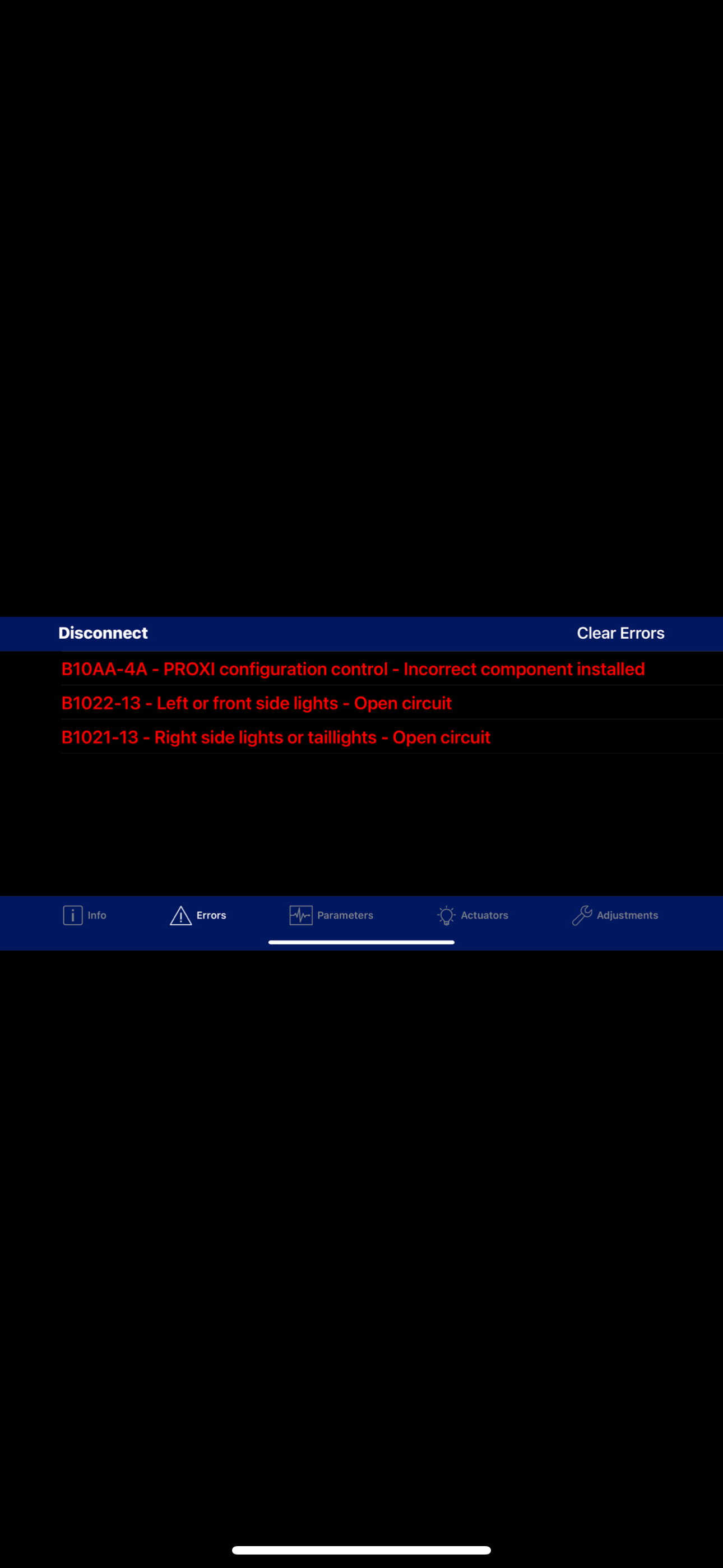

Hi hoping someone mite be able to shed some light as I’m getting very near to chucking the towel in, I’ve got a Fiat Abarth 595 MY17 I’ve got a fault that pops up when I turn my lights on saying (Check parking lights) & fault codes on Multicuescan are :
B1022-13 - Left or front side lights - Open circuit
B1021-13 - Right side lights or taillights - Open circuit

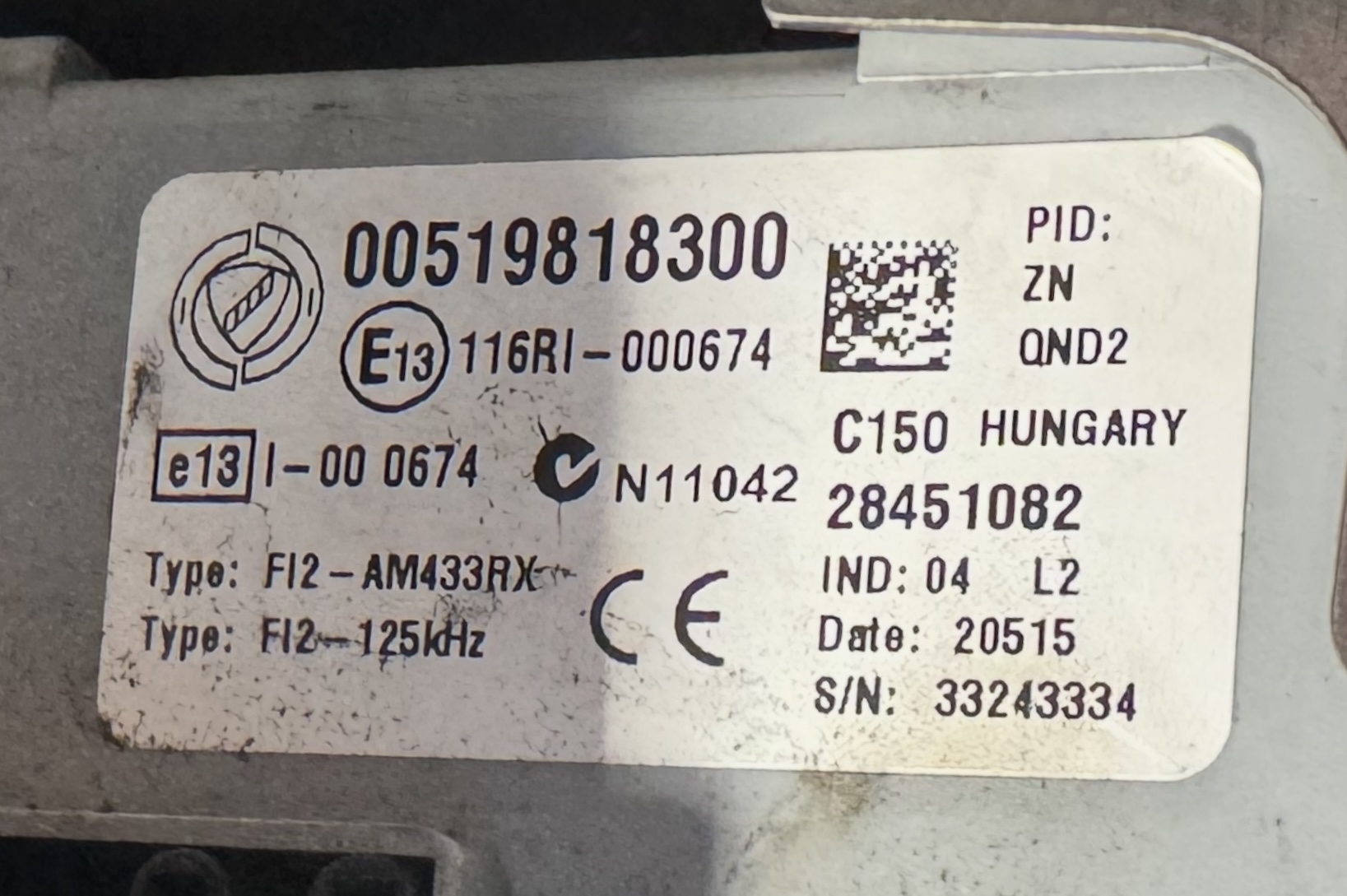

Also to make things harder the car was previously stolen & the key I have isn’t the original & on closer inspection I don’t think the BCM is original or has definitely been removed at some point which makes sense to have a different key, so if this maybe points anything in the right direction? Everything else works ok just seems to be side lights front & rear…

This is what’s fitted if it’s even correct… maybe why I’m getting this issue?
