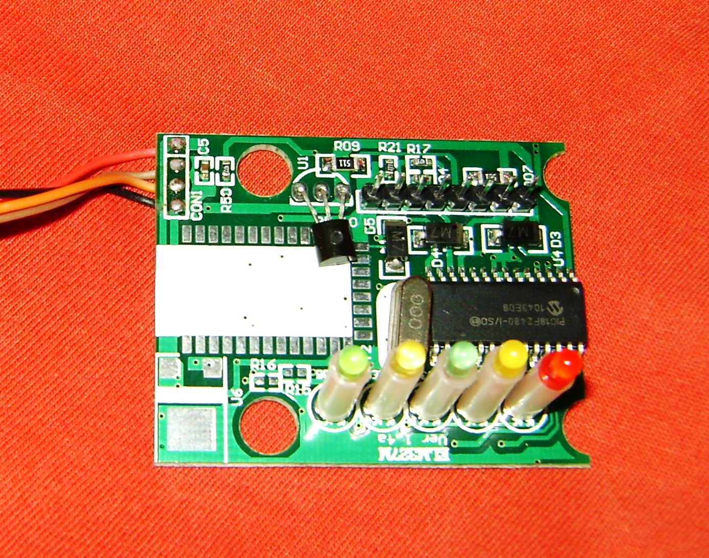

I have ELM327 v1.4a.(by on- board.). I've Alfa 147 2.0 Selespeed.I want to connect to Vdc,ABS.
multiecuscan.Net -->Supported Vehicles diagrams--> ELM327--> Table Adapter1(ELM1).
I do ELM1 (1,7,9,12 pins bridge).But,ELM327->Cannot ecu.Check serialports and pins.
I can ecu and automatic transmission.Did I something missing?
Otherwise,Do you need to VAG-COM to buy.

Forgot to ask you, do you have installed DIP switch o your ELM or you using adapter cable #1?
osmangdk
Posts: 10
Joined: 27 Jul 2011, 12:52
Post by osmangdk »
I make adapter cable1,but don't use.
I Don't know DIP Switch.
R04 not destroy.
If,I removed r04 ,does it work ELM327.
Thank you for everything.
I have ELM 327 interface as shown on page # 6 of this topic:
viewtopic.php?f=5&t=1493&start=50
I had to remove resistor 04 because it did not worked! When I removed the resistor my ELM327 interface started to work!
If your EM327 interface is same as shown on page #6 than you should remove resistor 04.
But if your EM327 interface is not same as shown on page #6 do not remove resistor 04.

Hi. Thank you for answering my questions.
I added board photos ELM327.
There are two things in a different resistance.
How do you think?
Do you think should remove R04.Thank you.

Post by mattydr67 »
Hi m8
Yes remove the resistor R04 like Mr. Alfa156sarajevo said and all will be ok.
You're interface will start to work on CAN
osmangdk
Posts: 10
Post by osmangdk »
Thank you for everything.I tried.
