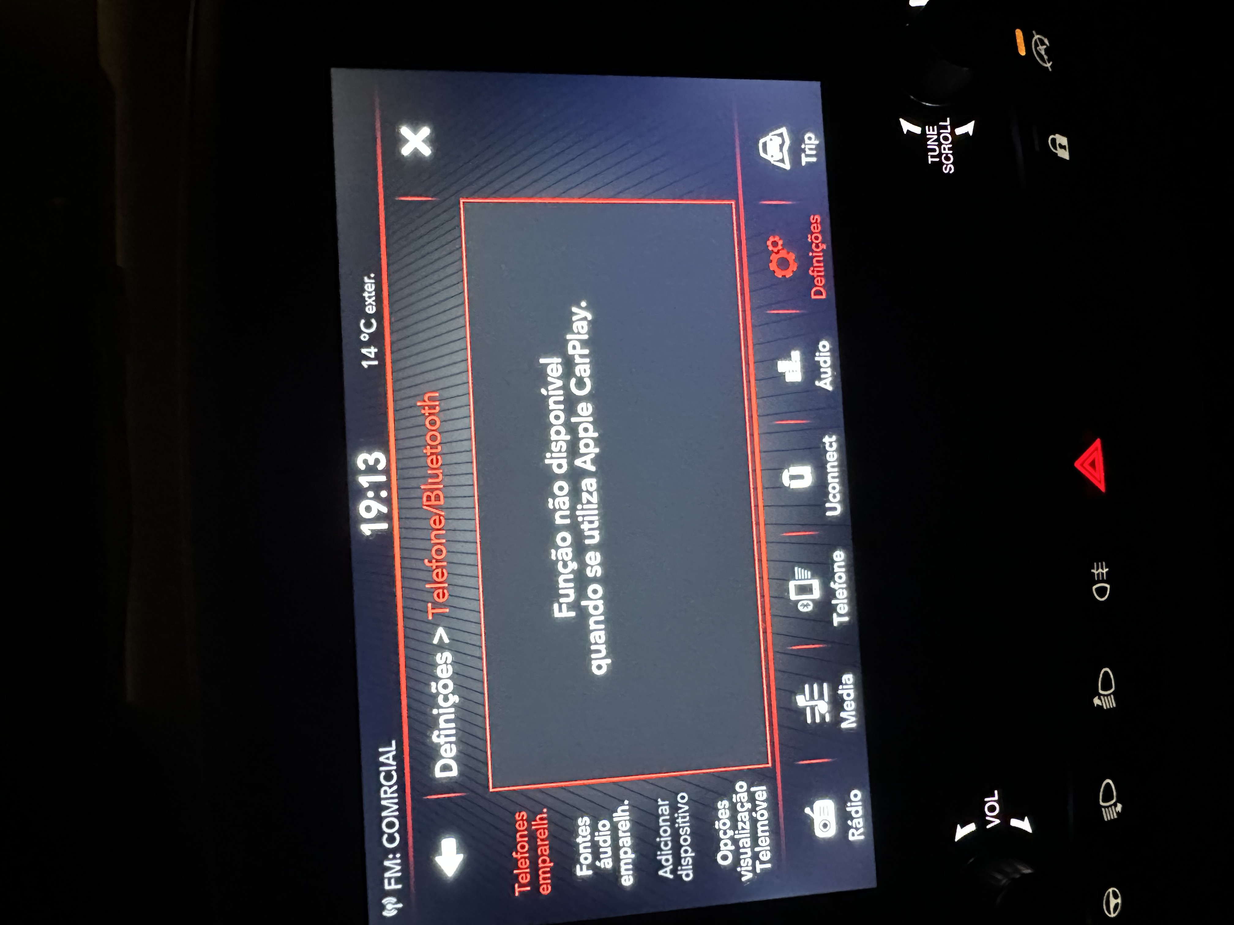

I tried. No errors, no CarPlay nor android auto. If I Connect my iPhone with usb, it takes me (on the phone) to configure CarPlay), but i only get connection like if it is an ipod. Looks like something regarding usb module configuration?
I also have a Otto u2 play (for wireless CarPlay), if I Connect it and try to go to Bluetooth options on the radio, i see intermitent info that CarPlay is working.

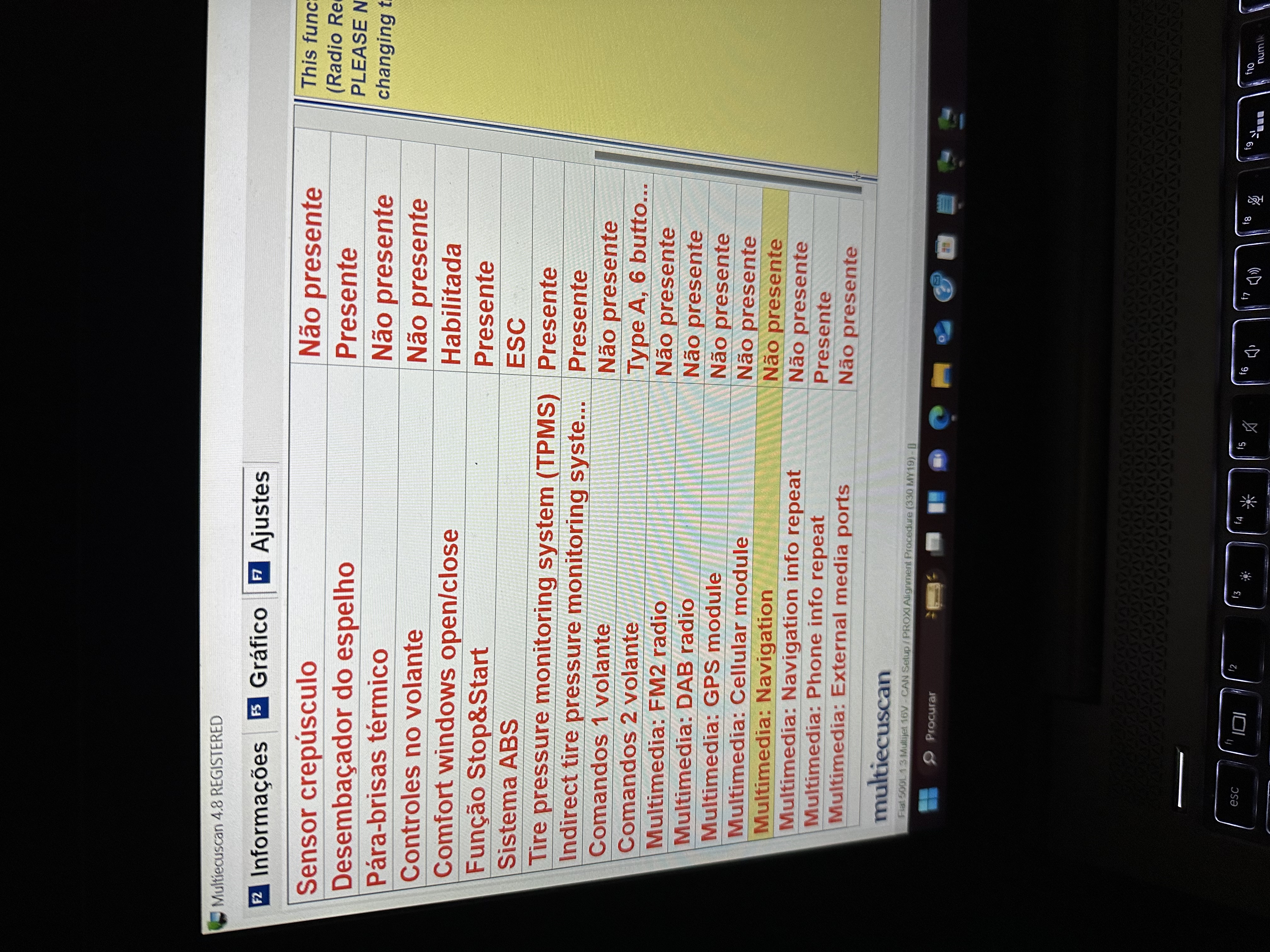

If I forget all devices, when I connect the phone to the radio (usb) i see the CarPlay logo. After that, I see nothing (only charging and Apple Music opened).
On my radio I see this intermittent. (IMG_3507, last photo). Left side options, the 4th one, also intermittent,
I also send more photos (multiecuscan).

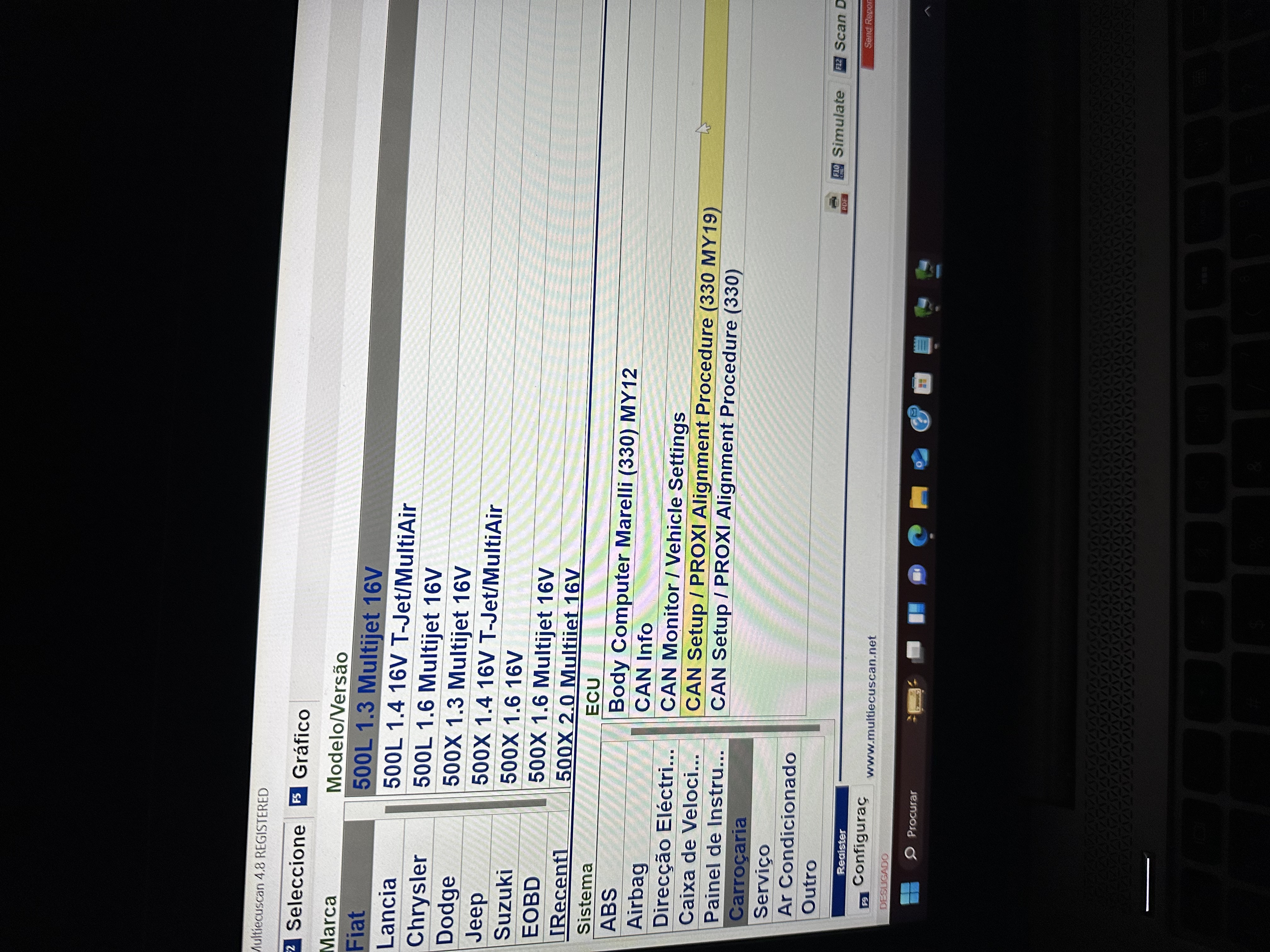

Do you use body computer 2019? If so, can you try the other without a year.

abarthmultijet wrote: 15 Feb 2025, 10:46 Do you use body computer 2019? If so, can you try the other without a year.
I use it both (not to upload the last one you gave me). I Will do it. Will report it after.
I tried it. Still no CarPlay, same things… but i have an error (time out error on IPC/NQS FAILED! Timeout error.

Edit: i enabled aux and GPS… CarPlay and Android auto is working. I gess the problem was aux disabled. Thank you for your help! 👍
