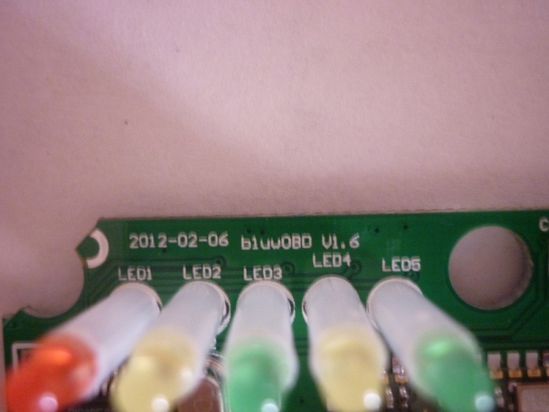

And your pictures are very difficult to recognize

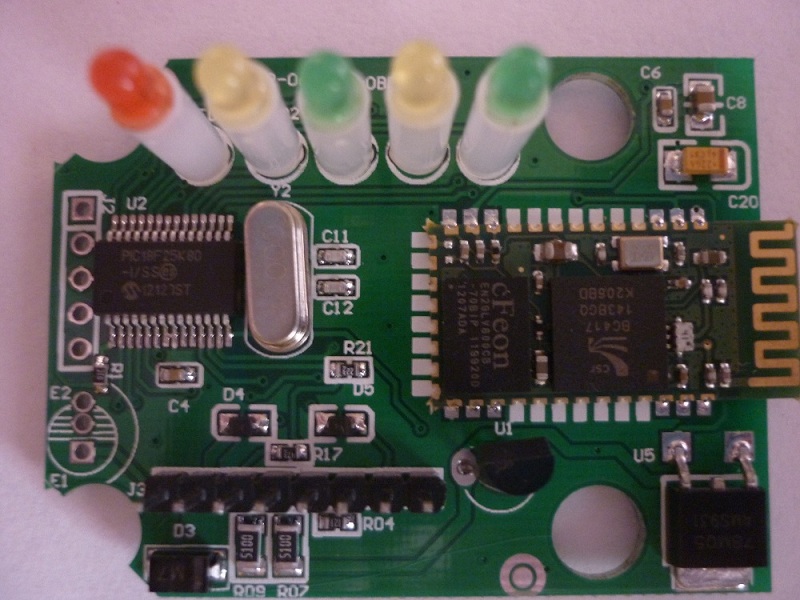

With your ELM you should test also get the body, please make a better picture. To see if your ELM also has this annoying resistor

this is my elm only without bluetooth what can i do? thanks
Re: Connection problems with ELM327
Remove the red marked resistor R04
It should also make the body tie no more problems
