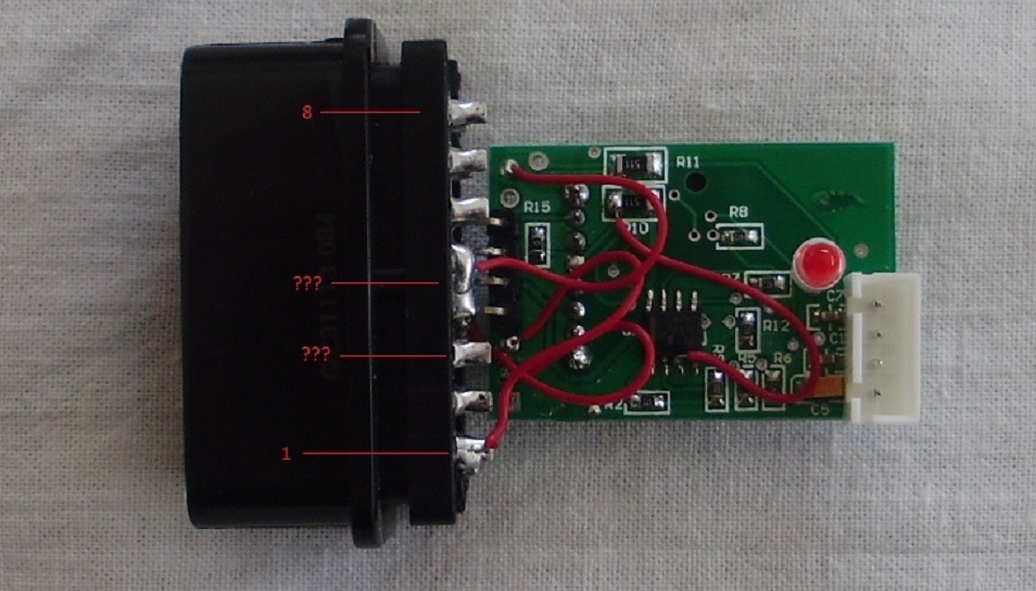

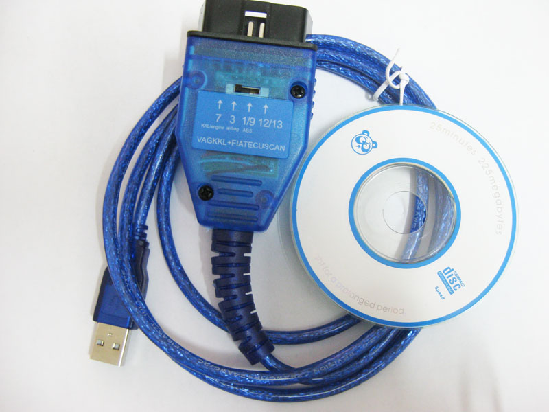

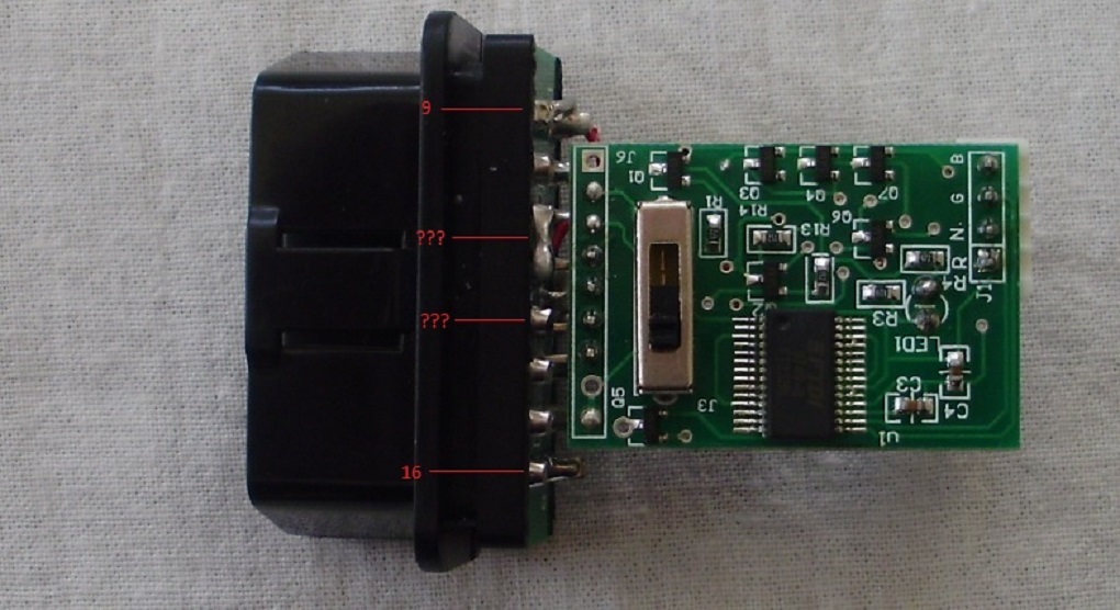

Hahaha Check this out! My new chineese VAGKKL cable..
Airbag is soldered to pin4-5, instead of pin3! :D
ESP is soldered to pin11-12, instead of pin12-13. :D
After the modification it works properly.. So first of all you should check the cable for correct pinout. 8-)

Gatter wrote:Hahaha Check this out! My new chineese VAGKKL cable..
Here is pinout for MES:
pin 1 - ABS
pin 3 - Airbag
pin 7 - Engine/Gearbox
pin 9 - EPS
pin 12 - XENON
On all OBD2 interfaces no matter for which group are they made (Vw, Audi, Ford...) pins 4 and 5 are always connected (soldered) together and on pin 16 is always plus (+) from battery.

Yes you're right, XENON is on the 12 pin.
But my main problem was the Airbag line. Which was soldered to pin 4-5, instead of pin 3! (Red cable)
