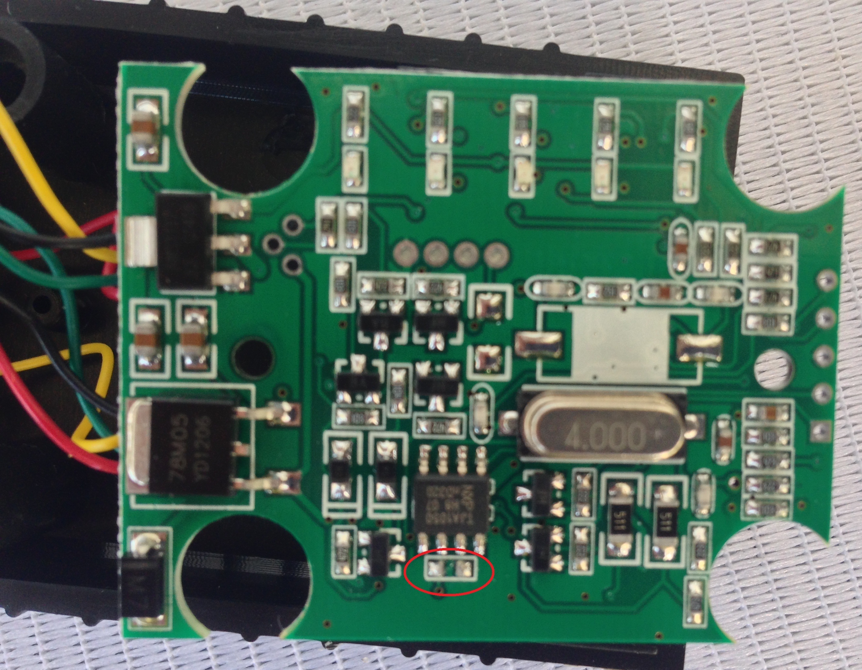

Quick reply @ Alfaeddy , thank you for your support
I removed the bridge resistor which you have marked on attached picture and now I am able to connect to Electric Steering , ABS , Air Bag and other CAN modules .
I have test the interface on Fiat Punto 188 and Alfa Romeo 147
Best regards,
edoixxx wrote:Quick reply @ Alfaeddy , thank you for your support
Best regards,
Schön das ich dir helfen konnte :D
Grüße Eddy

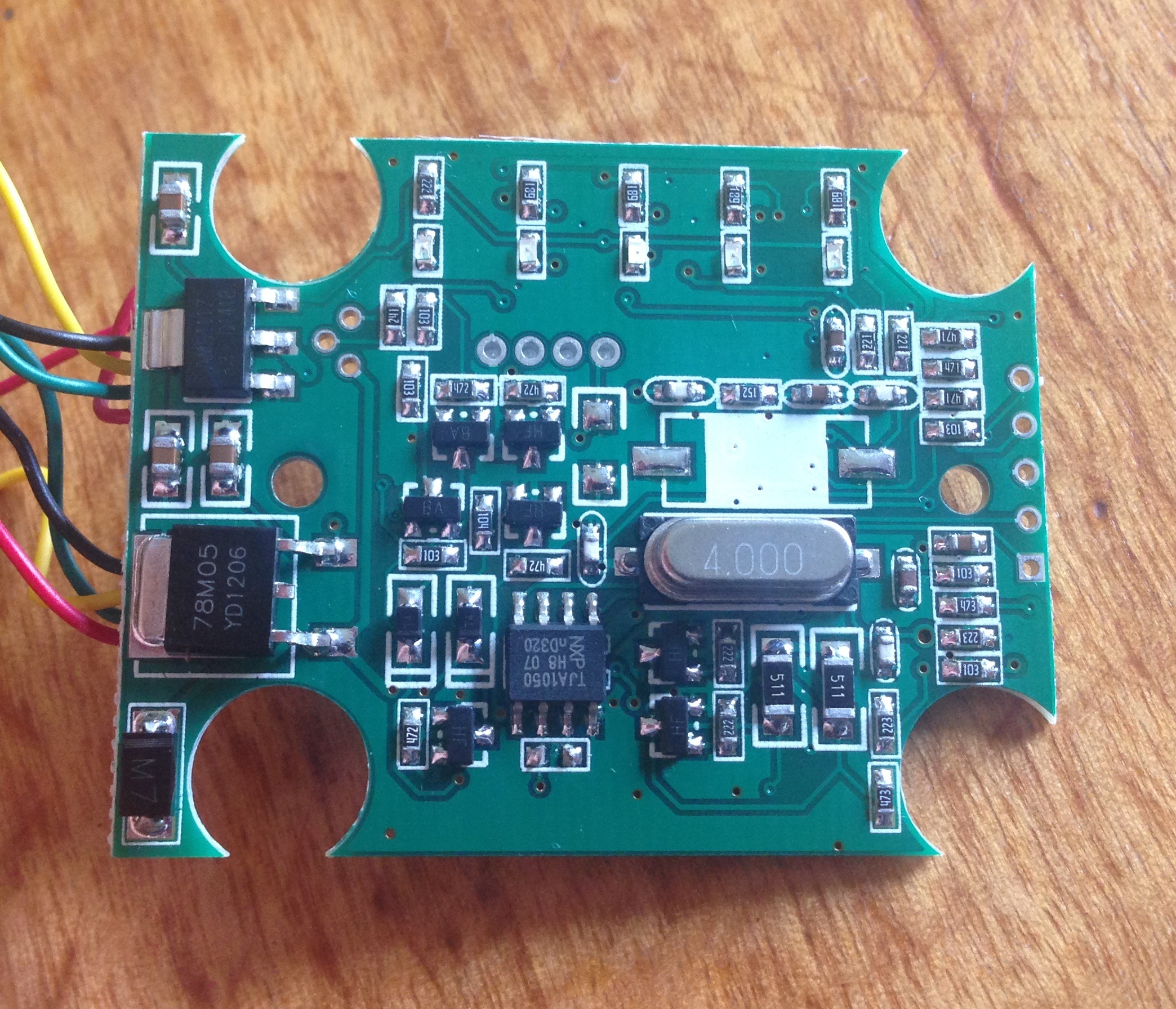

Hi, i bought the the ELM 327 v1.5a and the circuit board isn't like any i see here.
Can someone help me identify where I need to desolder or where to put the resistors and capacitors on the board.
http://postimg.org/image/lf2i50tl5/
http://postimg.org/image/5q2mhchcn/

To me it looks like problem with ELM versions, when scanning for interfaces in message i got one version (ELM 327 1.4!), when testing connection in the response command i can see other (ELM327 v1.5) and looks like warning message said ELM 327 1.3! is needed.
Tried to remove 120 Ohm resistor (one labelled with 121) but nothing changed (see attached image).
According to http://multiecuscan.net/SupportedVehiclesList.aspx i should be able to connect to Injection and Abs without adapter, but without success. Then i've changed wires to match Adapter 3 (ELM C19) in order to be able to connect to other CAN modules, but that doesn't help also, got same error again.
Using software like EOBD Facile, Torque and ScanTool i'm able to connect, but there is problem with MultiScan.
Does anyone has idea what could be the problem. Is my ELM not compatible with my car? Or i've removed wrong resistor?
Photo 22.6.14 12 14 41.jpg (1.65 MiB) Viewed 9017 times
You have already some attempts, only
Which driver do you have installed?
try this
After your letter you have the Punto `12?
is read only via CAN bus. ?
Your picture is unfortunately very bad you can hardly recognize the components.
Therefore, I can not tell whether you have the correct Resistor removed you.
Moreover, despite these Resistors of the interface test should be displayed as OK.
Only the compound thus does not operate.
Which interface is this exactly?
And do even a better picture.
from the rear side to
edit:
I again looked at your interface somewhat
The boards construction I do not know

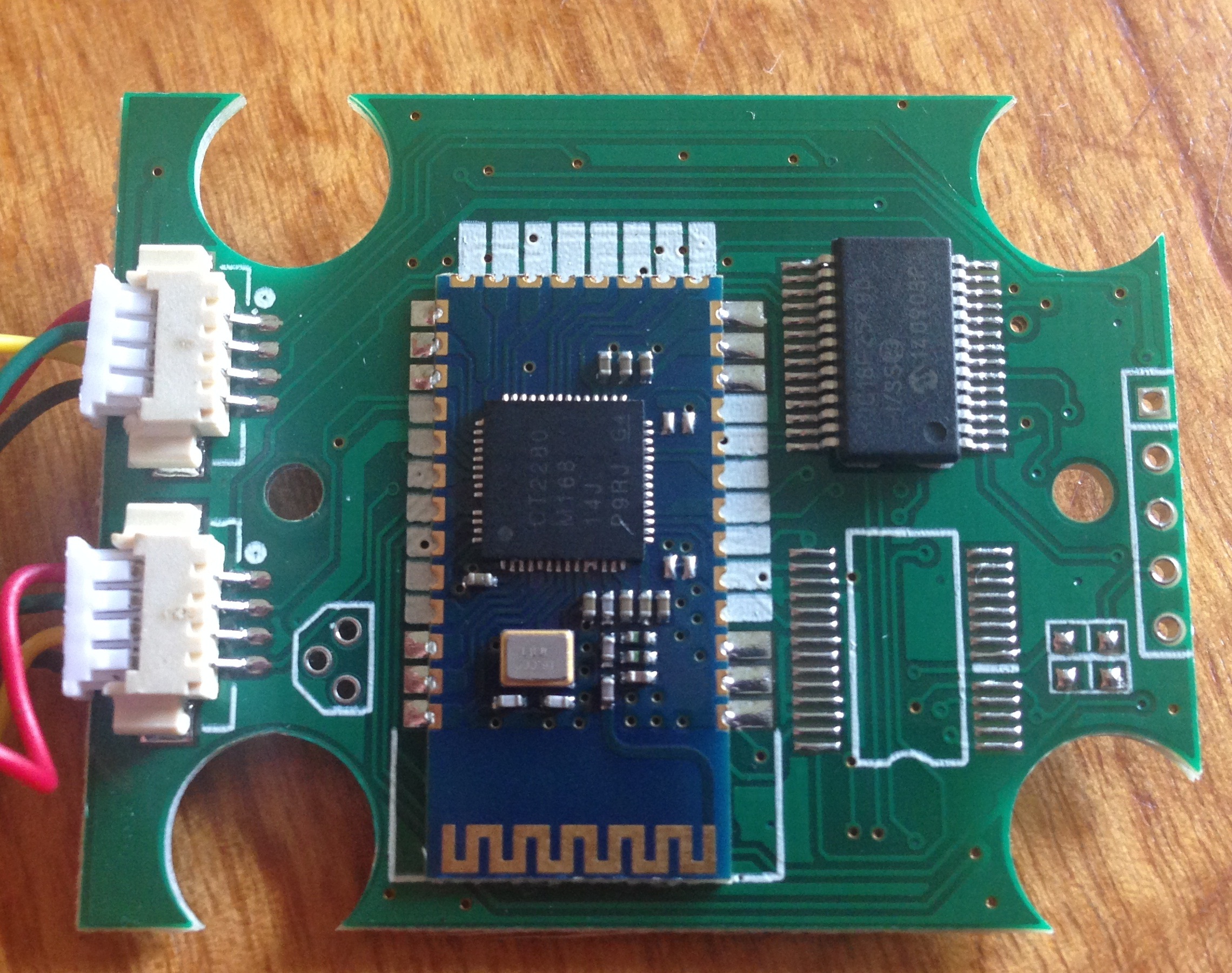

Make please a picture of the back
koret
Joined: 22 Jun 2014, 09:49
Post by koret »
Hi Alfaeddy, thanks for your quick replay.
I have Grande Punto 2006 year, engine 1.2 with 8V. From what i've learned so far, yes it's read only via CAN bus (although i'm not 100% sure).
I haven't installed any specific driver manually, which driver Windows 7 downloaded automatically i'm not sure, but will check and will try today with driver that you've provided.
I've made better images from front and back.
