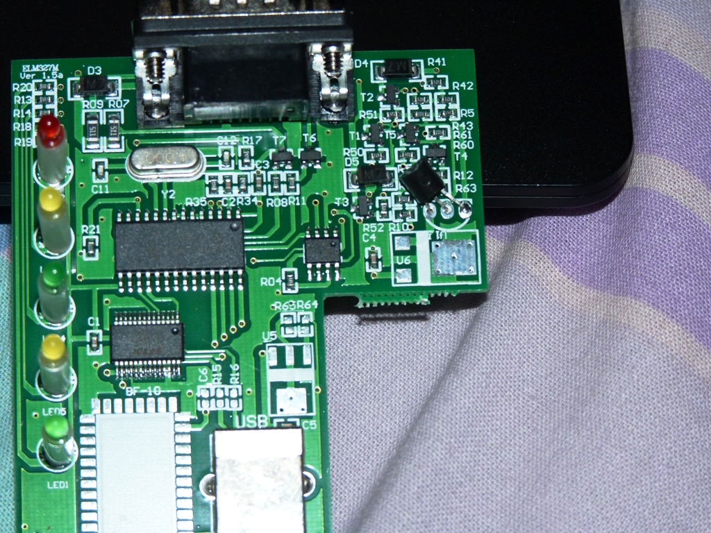

Zwierzak wrote:You have to remove R14 / Musisz usunąć R14
Ahoj a mužeš mi poslat nějake schema zapojeni prosimtě nechci zapojovat a odpojovat na slepo dik

i have an ELM 327 1.5a and i can't connect to body,service etc
on engine is working perfect
if i will remove R04 everything will work ?
R14 or R04 ???
As I can see there R14 must be removed

Zwierzak wrote:
R14 or R04 ???
Ahoj odstranim R14 a co dal musim tam něco přidělat nebo ne

yincar wrote:Hi Yani and all,
My bad interface looks like this. Not sure which version it is. So, do i need to remove R14 and solder 100 ohm resistor and 560pf capacitor like what 1st post did to cure CAN issue?
yincar
Ahoj prosimtě mužeš mi poslat detalnějši připojeni capacitoru a resistoru Děkuji

sprint750 wrote:Hello,
Another cheap 'Chinese clone', from eBay (UK seller, not china or HK), received 3 days ago.
It was sold as ELM 327 1.4 'with a genuine ELM chip'. :?
(For my personal information, I would really like to recognize a genuine ELM chip from a fake one)
Actually everything is working well FES wise, which makes me think it is actually an genuine ELM1.4
- NO communication problems, all ECU are recognized.(Airbag and steering not tested, pins 1-7-9 not soldered yet)
- NO problem to get access to service reset.
- NO installation problem. Just the drivers for FTDI USB to install.
On the last pic we can see the 100 Ohm resistors (R25/R26) for CAN H/L lines with associated capacitor (C14/C15)
Same combo shown by members in the last posts.
Hope it can help you to find the correct interface
Best regards
Sébastien
it seems I do have this one interface. I did soldered additional pins. So, at this time I'm able to connect to engine ECU and ABS in my Alfa 147. Unfortunately I cannot connect to anything else.
