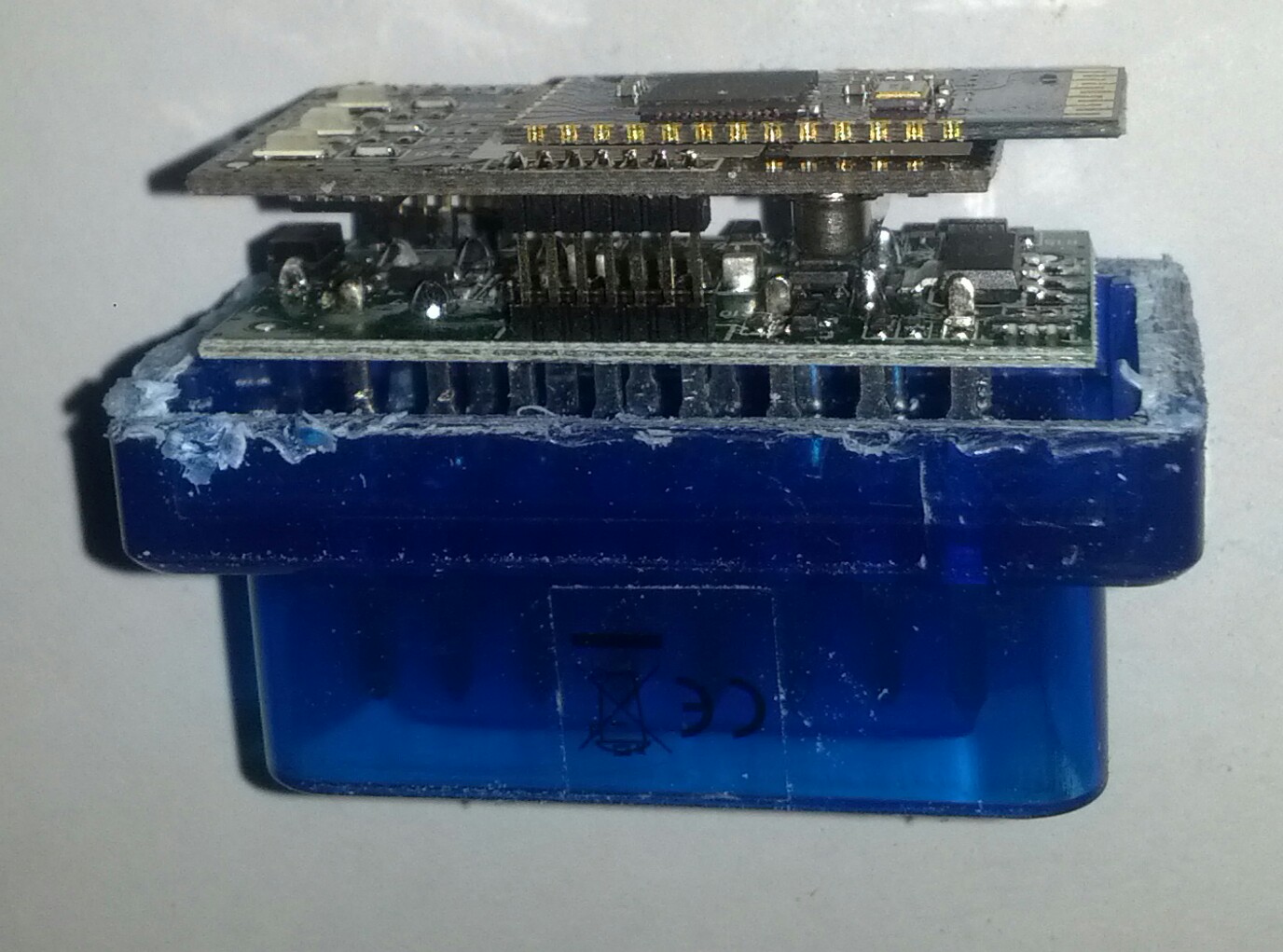

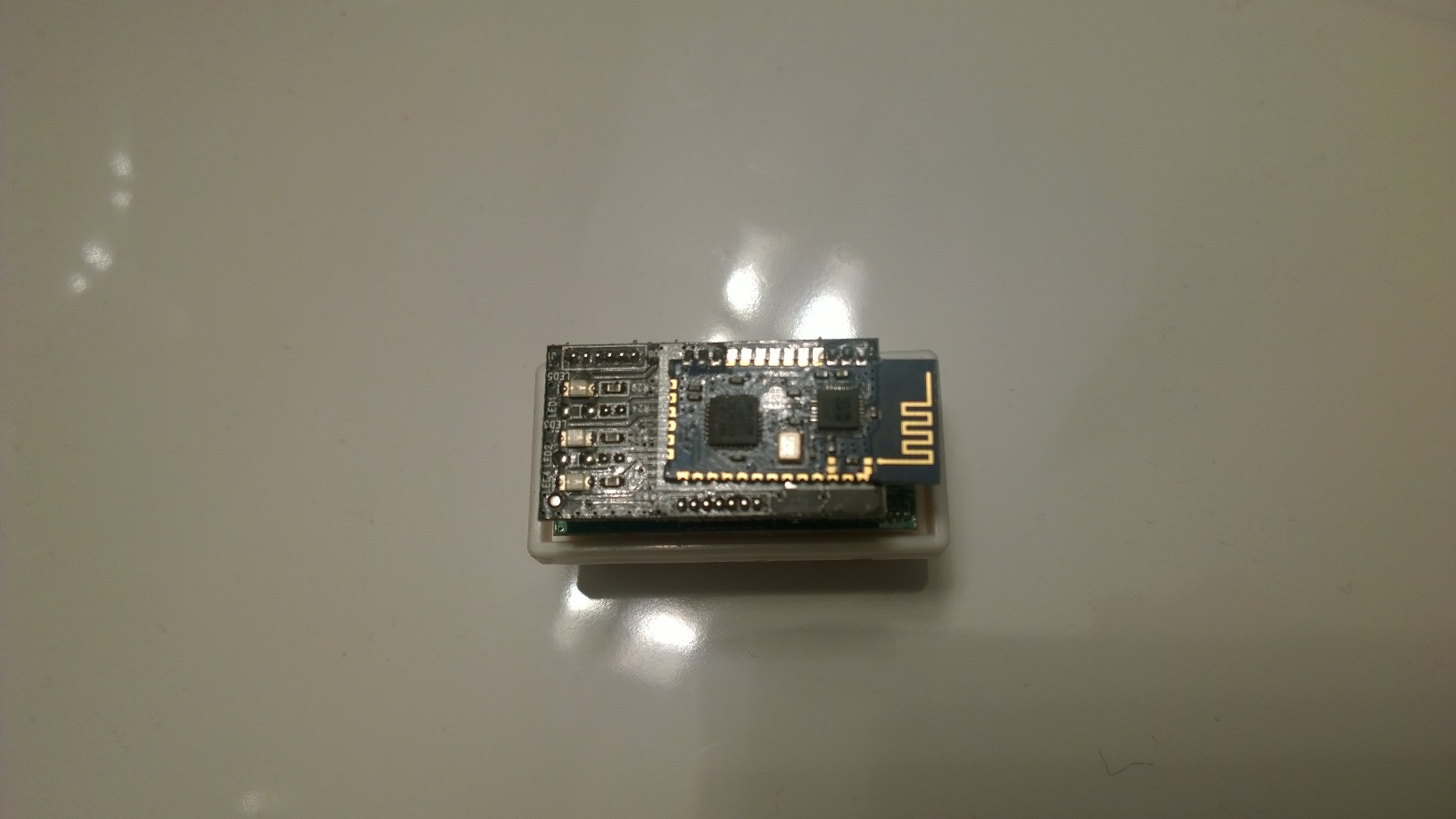

I try to solve my problem. I have Alfa Romeo 159 and I would like to connect to airbags via my ELM327 BT interface. Connection to engine is working well. I spent here some hours, so my question is: Shall I remove resistor 121 after making 2 parts from one interface? I think, that there is a Picture of similar interface here: viewtopic.php?f=5&t=1493&hilit=bluetooth&start=1280
I attach some pictures of my interface, but it's almost nothing to see...

Hello Matees
The bridgeresistor sits on the lower PCB
and is designated R2.
Your boards are soldered together but unfortunately
therefore you get very difficult at this resistor
With some skillful of bridgeresistor has to be removed anyway, even without the boards to separate

Hi Eddy,
thanks a lot for your quick help. Resistor is out now. I will check it tomorrow on my car.

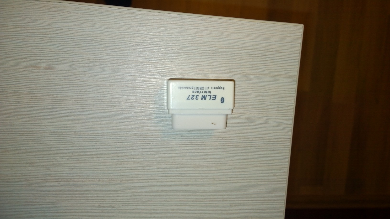

Hi friends...
Sorry for such a noob question but how to you open the elm327 to access the board?
Do you cut the plastic?
Mine is this
Mine is this

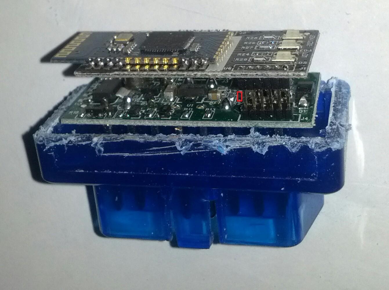

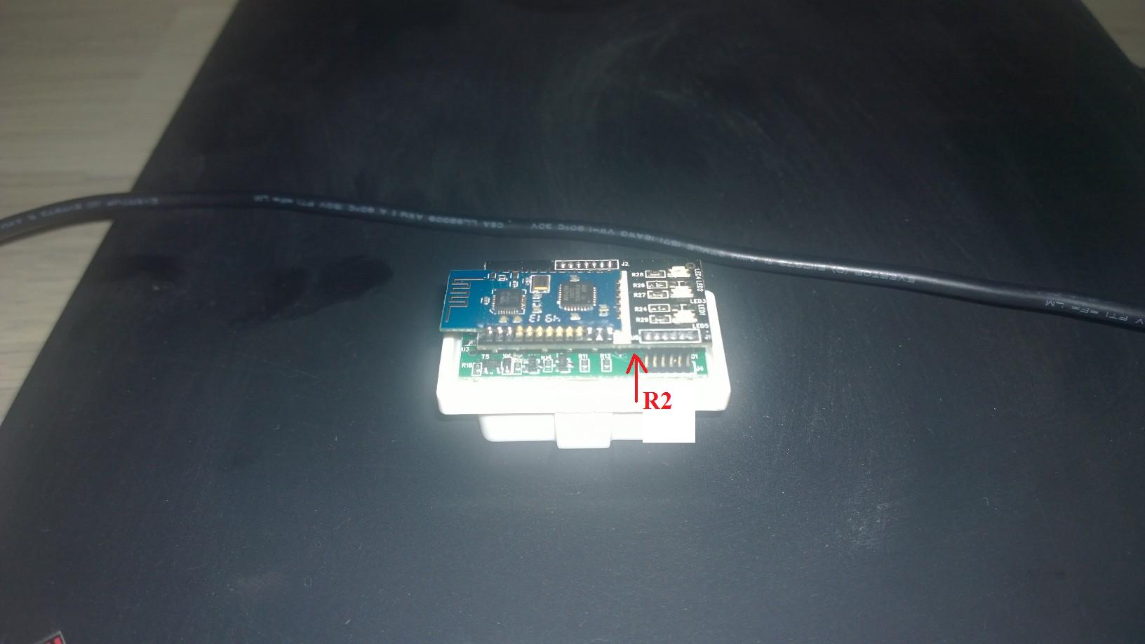

Here is my board.
Can you tell me what resistor needs to go out?
hello
Wow, now that's a violent opening
The components on the board are very difficult to detect
unfavorable angle
But the R2 should be the bridge resistance
There are in this thread several times already this ELM Interface
The second picture is for comparing
unfavorable angle

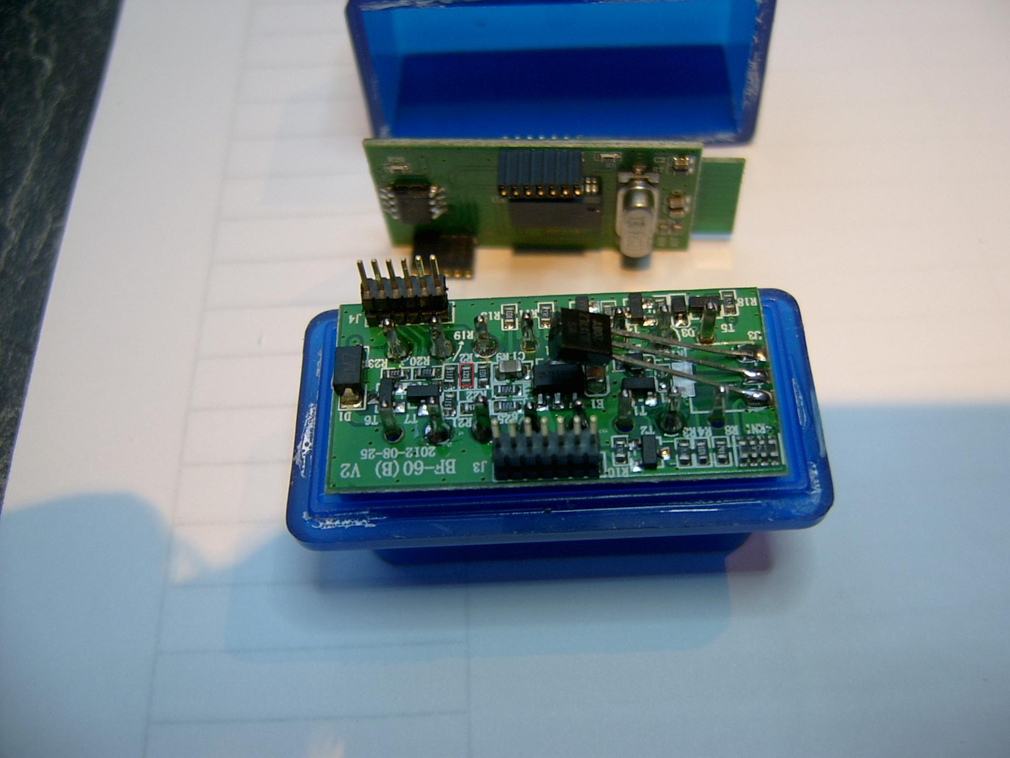

Thanks found the r2 but seems impossible to get there. Is possible to detach the two boards or are they soldered?Alfaeddy wrote:hello
Wow, now that's a violent opening![]()
unfavorable angle

Hello Herpez
The two boards are soldered correctly
If you are careful you can break out the resistor with a stable needle. But beware that the interconnects do not break.
You can also with a desoldering pump desoldering the solder joints and separate the two boards.
Remove resistor and solder the boards again
