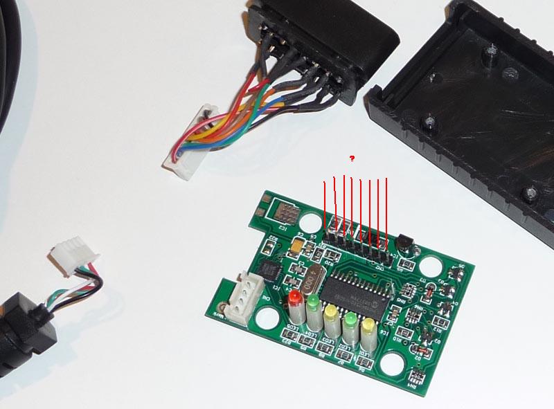

Please is there anyone who can tell me the coresponding pins for ELM327 OBD II connector?
In the pics from left to right, please
Thanks in advance for your support.
This is not easy, there are different configurations boards
but if the first left the ground (-), this can be seen on the board
from left to right.
4 +5 / 10 / 14 / 6 / 15 / 7 / 2 / 16
It is also possible that they recognize ground (-)
15 / 7 / 4 / 14 / 6 / 10 / 2 / 16
