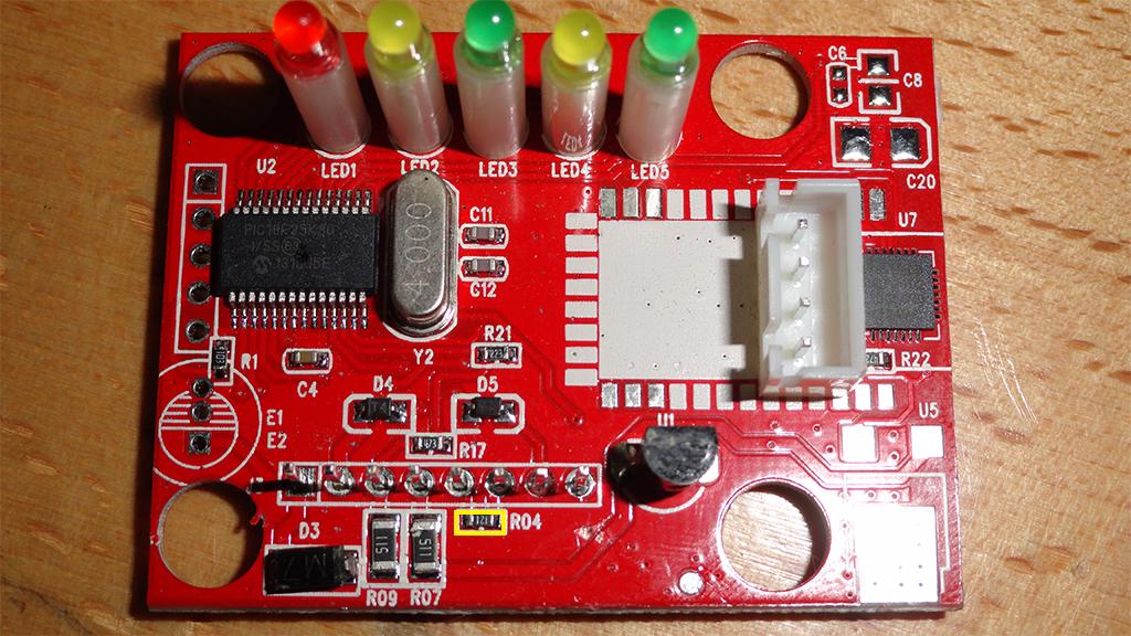

This interface we had very often here
and has been repeatedly described.
With a little search you would have found it quickly.
1 markiert.jpg (147.58 KiB) Viewed 8687 times

@Alfaeddy
I have the Same Interface and i have removed this resistor. But i can't look into my Boardcomputer. I have the Yellow Adapter, too.
i have the Baudrate 38400 and the lowest latence, should i Change my settings?
Sorry for my bad english.
hello PuntoHGT2002
Then it is up to the settings or the driver
which driver you have installed?
on which operating system?

I have Windows 7, and the driver are silabs cp210x and CH340.
Mes says check the kkl cable or your serialports settings.
PuntoHGT2002 wrote:I have Windows 7, and the driver are silabs cp210x and CH340.
Hello PuntoHGT2002
KKL Interface ????????
You have a ELM Interface
And'll try this driver choose from but the CDMv2.10.00

@Eddy
yes i have an elm Interface But mes says check kkl Interface.
@walto
I have installed All 3 drivers because it's only work with the silabs driver
I can look in the vehicle unit without any Adapter But i can't look in the boardcomputer.
Sorry for bad english.
