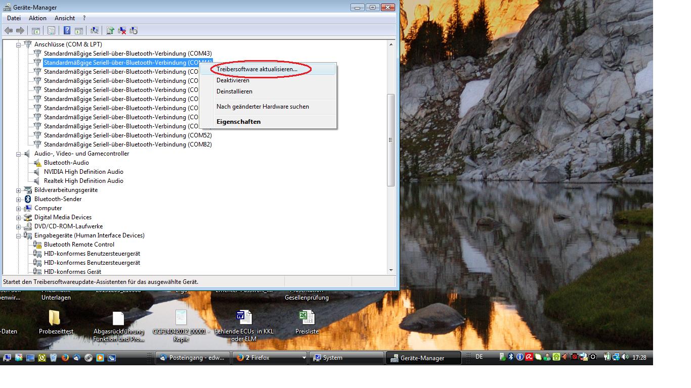

Where do you install the FTDI driver? Update driver for the Port (Serial to Bluetooth etc)?

This is just a example,
Treiber installieren.jpg (185.79 KiB) Viewed 8231 times
However, the connection failure may be due to other settings
These settings have been described over a hundred times.
Only the link failure to the ECU of the Stilo has nothing to do with a bridge resistance in the ELM interface.
