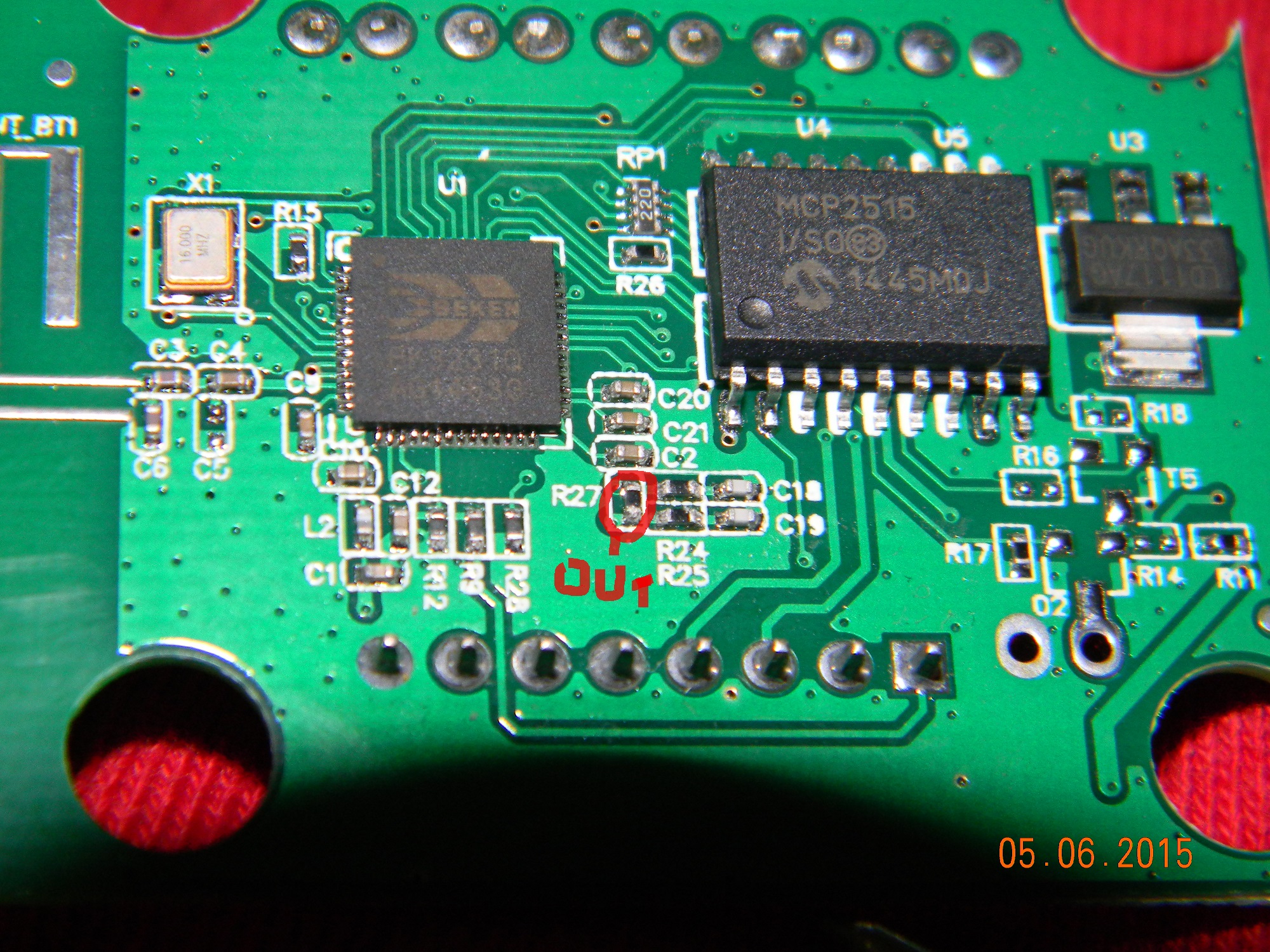

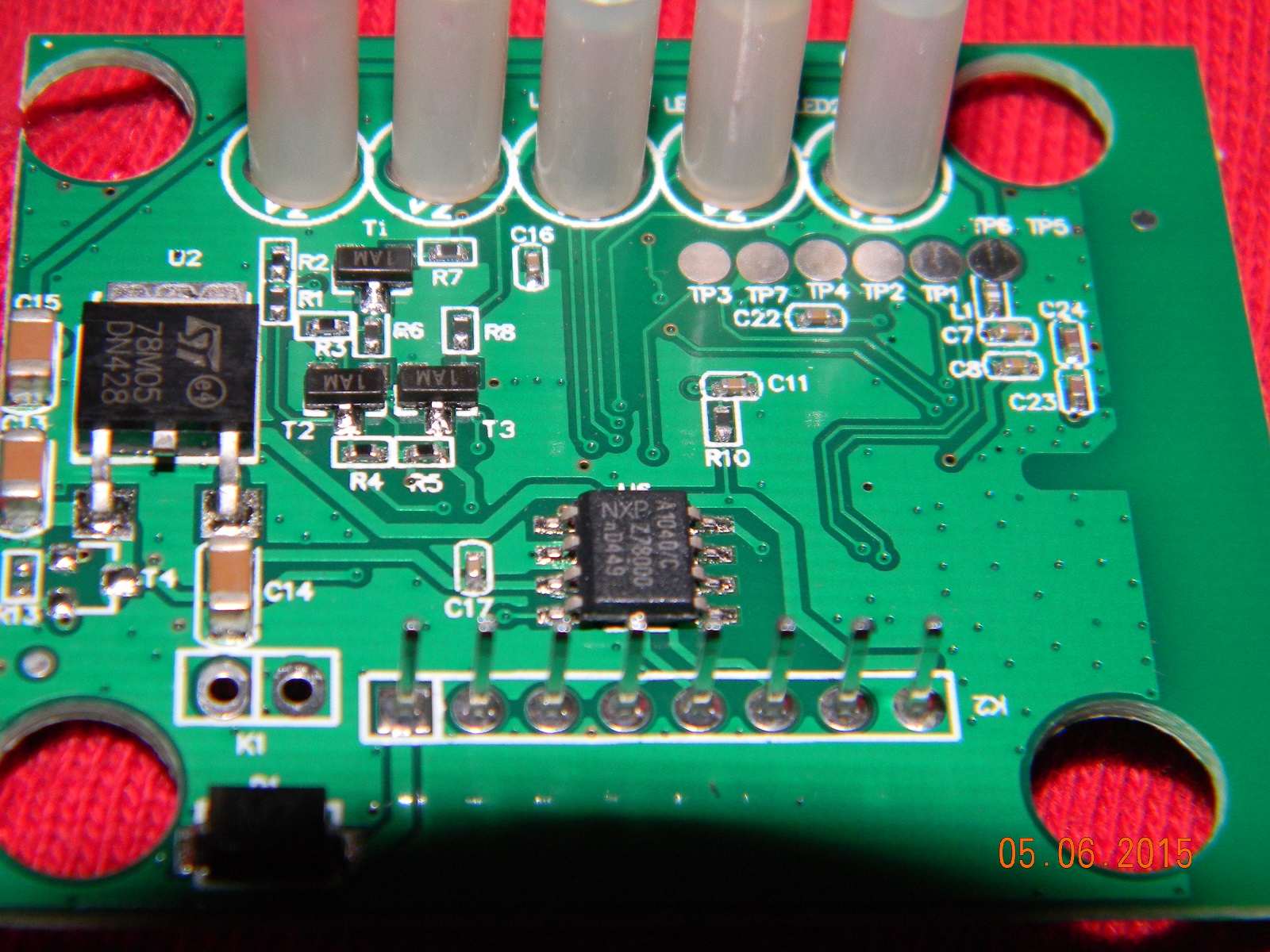

Hello and sorry for my English.
I recently purchased a clone ELM327 Bluetooth (the normal size one - with 5 led), and y have this problem (when y test with FiatEcuScan 3.6.2 registrated):
RESPONSE: ATZ
ELM327 v2.1
ELM327 v2.1
RESPONSE: ?
RESPONSE: ?
RESPONSE: ?
Mention that does not connect to a 2007 Panda 1.2 ( with FES ) , but connects to a BMW 520d engine LCI 2010 and even read / delete errors with Torque program .
With the same Torque seems that tries to connect to Fiat but I seems to give false errors .
I borrowed another interface and is compatible and works fine. So the problem is with this interface.
I even removed a resistor between pin 6 and 14 ( a resistance of 100 ohm have between pins , and after removal does not have any resistance - I hope I did well and is not a wrong resistor
) but not fixed anything.
Please do not tell me that y must throw away...
I've attached two pictures of the interface. ( Has on both sides of the PCB components).
Thanks in advance

Hello Trafic
Unfortunately, I have to tell you what you do not want to hear
Look at your printout of test
It is the interface version v2.1
This version you get with MES not to connect to a control unit
Thanks Alfaeddy
I will use only with Torque, it seems to work with my cars.( Bmw E60, Fiat Panda and Passat B6), only to the engine of course.
