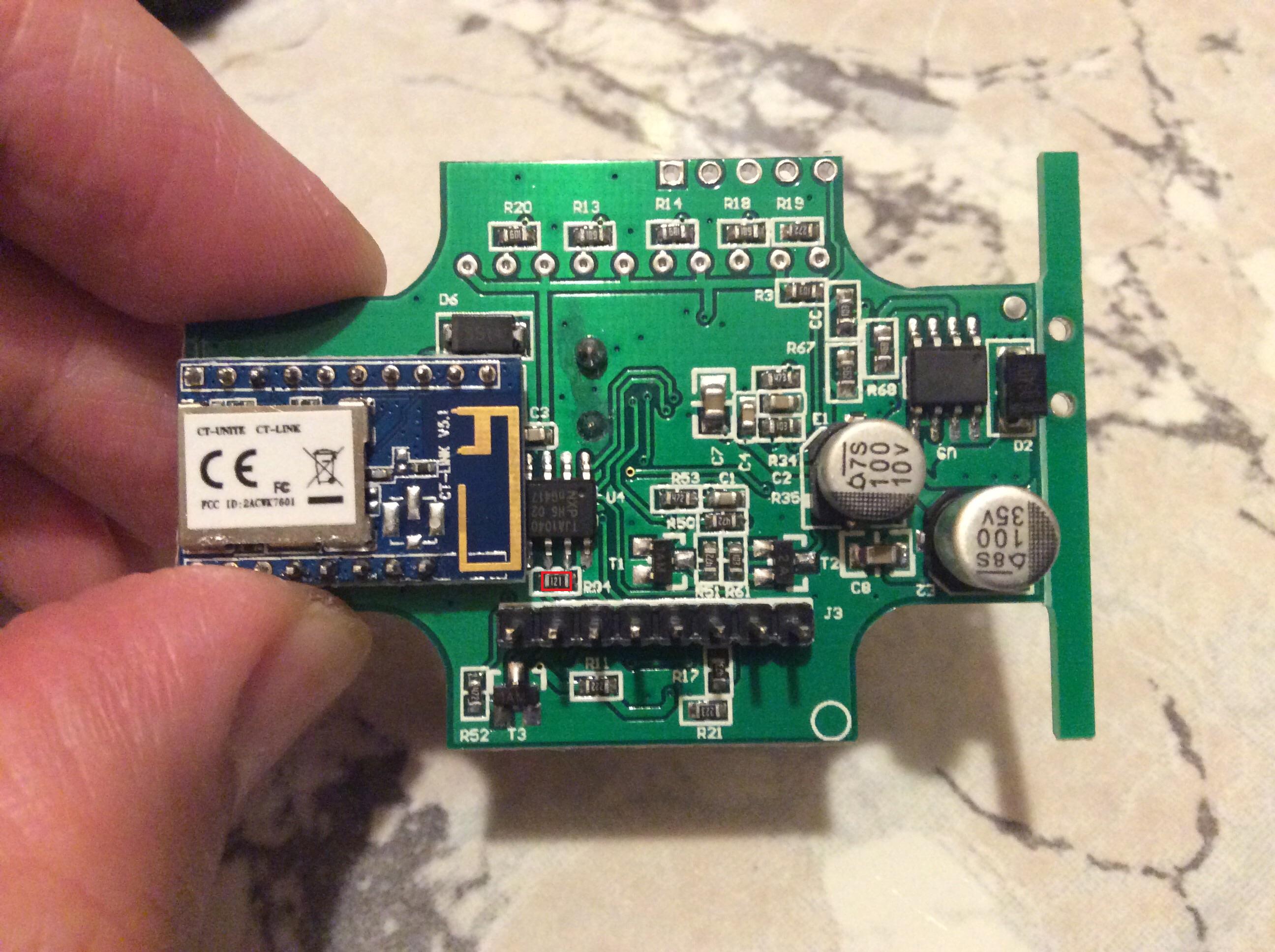

Remove the Resistor in the red Frame
then you can read the CAN Bus from your Alfa 159

Thanks Alfaeddy, I will check it.

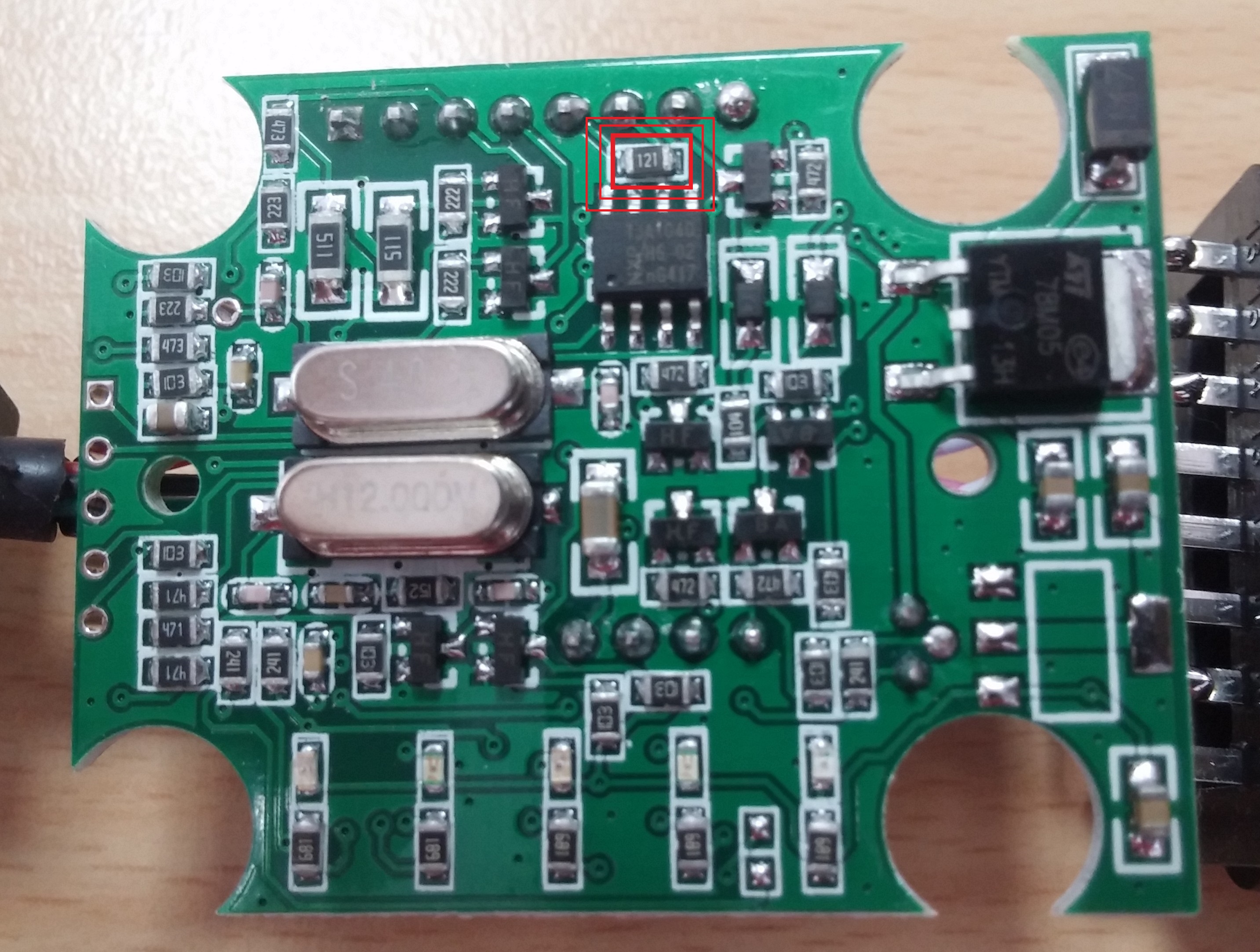

What should I remove from this ELM to have acces to ABS and everything else (besides the ENGINE)? Is that the resitor, between the CAN lines? Thank you.

ello
First of all, what vehicle you want to read ?????
Because very often have connection problems not related to the bridge resistor.
The red marked from you is the bridge resistor Resistor

I dig now the modification, for CAN vehicles you remove the termination resistor (120ohms) and the signals pass through to ELM-type chip. Neat.
