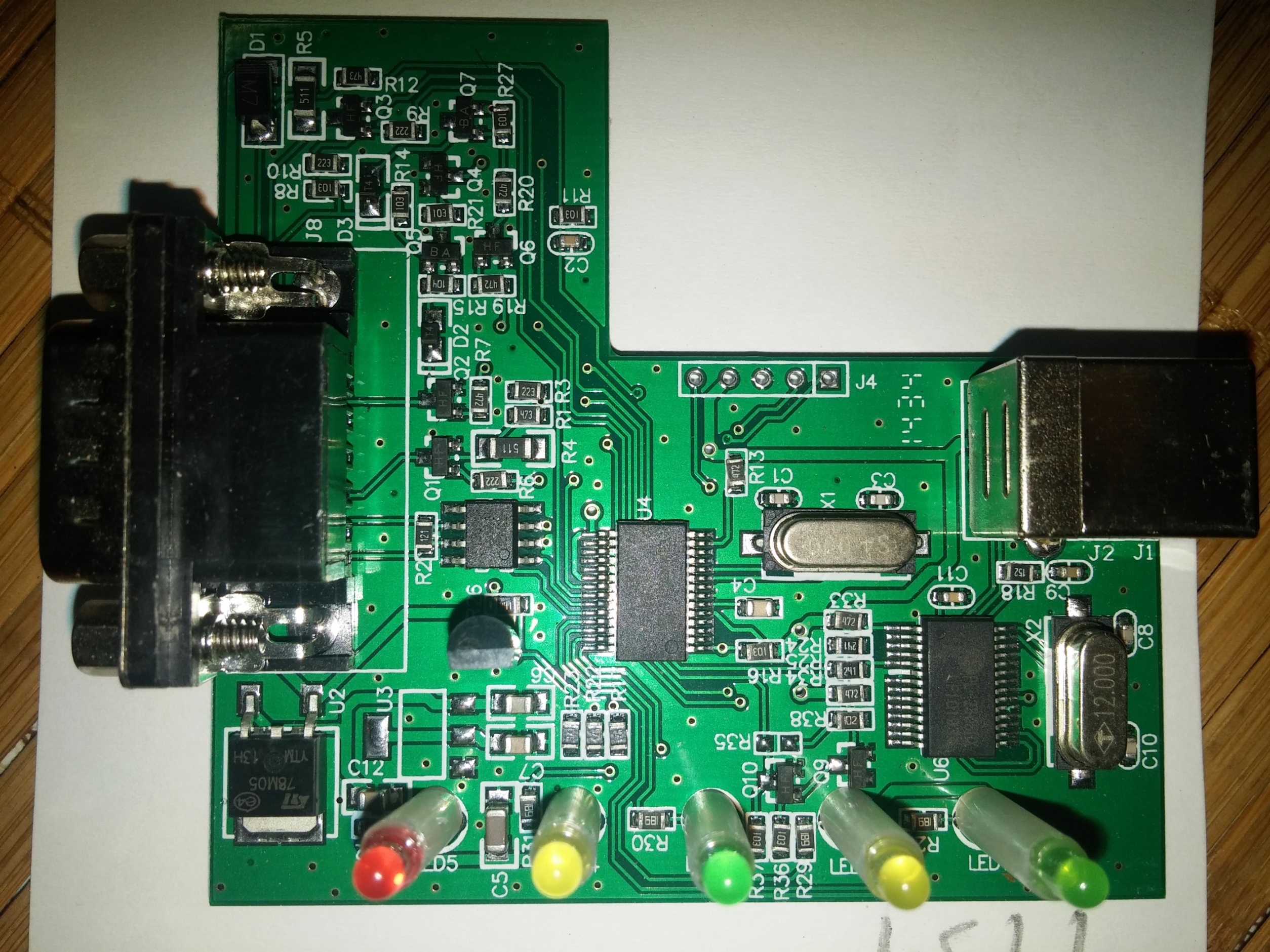

hi, please what resistance should be removed to let me go all the controllers on FIAT STILO 1.9JTD multivagon 2007 and Alfa romeo giulietta 2.0 JTD 2011 ? Figure in Annex
Thank you very much
ELM 327 1.5a
ELM 327 1.5a
Remove the red marked Resistor
file markiert.jpg (596.28 KiB) Viewed 8947 times

Hello, thank you it's better to get almost all controllers. But I can not get on Airbag, Electric Power, ABS FIAT Stilo 1.9JTD Multivagon 2007. Can also start these controllers?
the Alfa Romeo Giulietta 2.0JTD 2011 I do not :(

I ELM327 bluetooth as I modify it so that I can diagnose all the control units?
FIAT Stilo 1.9JTD multivagon 2007 and Alfa Romeo Giulietta 2.0JTD 2011
