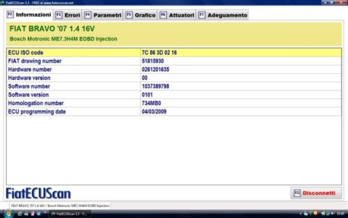

Then I try the star key on Bravo in MAR position and engine off, don't make the start motore bat take the key on MAR.
I have Connected the ELM on the connector of body panel and the software are connected to the electronics car engine .....
motor control
motor control
b6 s.jpg (24.15 KiB) Viewed 12587 times

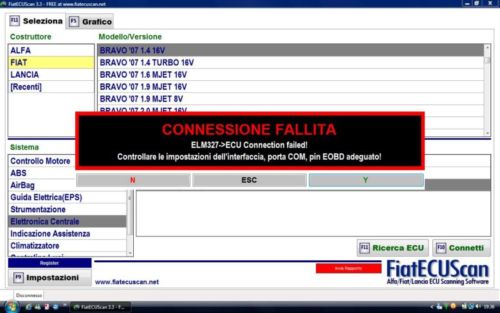

Electronics of the "Body" and "Reset Sevice" , I can't connected to it because it gives me this (italian) screen....
Body and Reset Service
b3 s.jpg (32.66 KiB) Viewed 12587 times

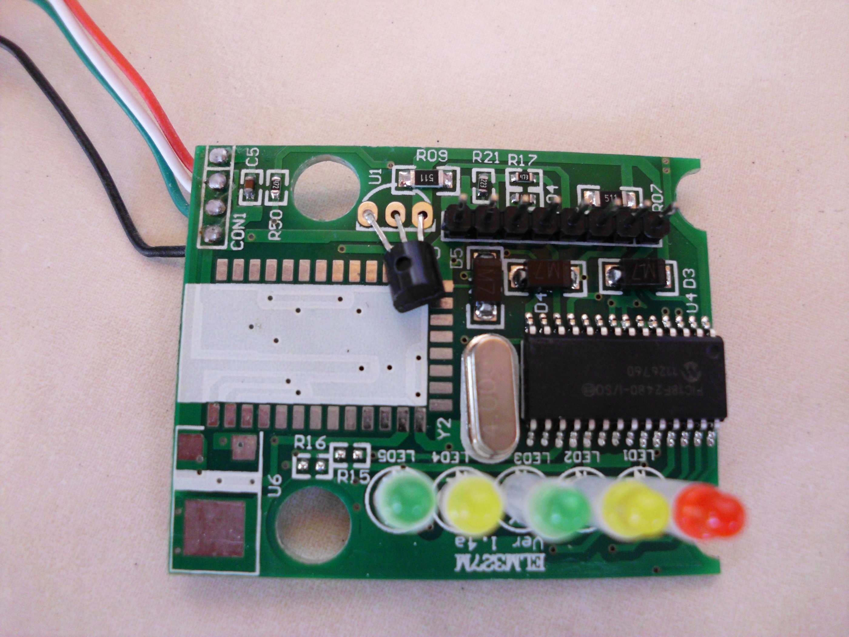

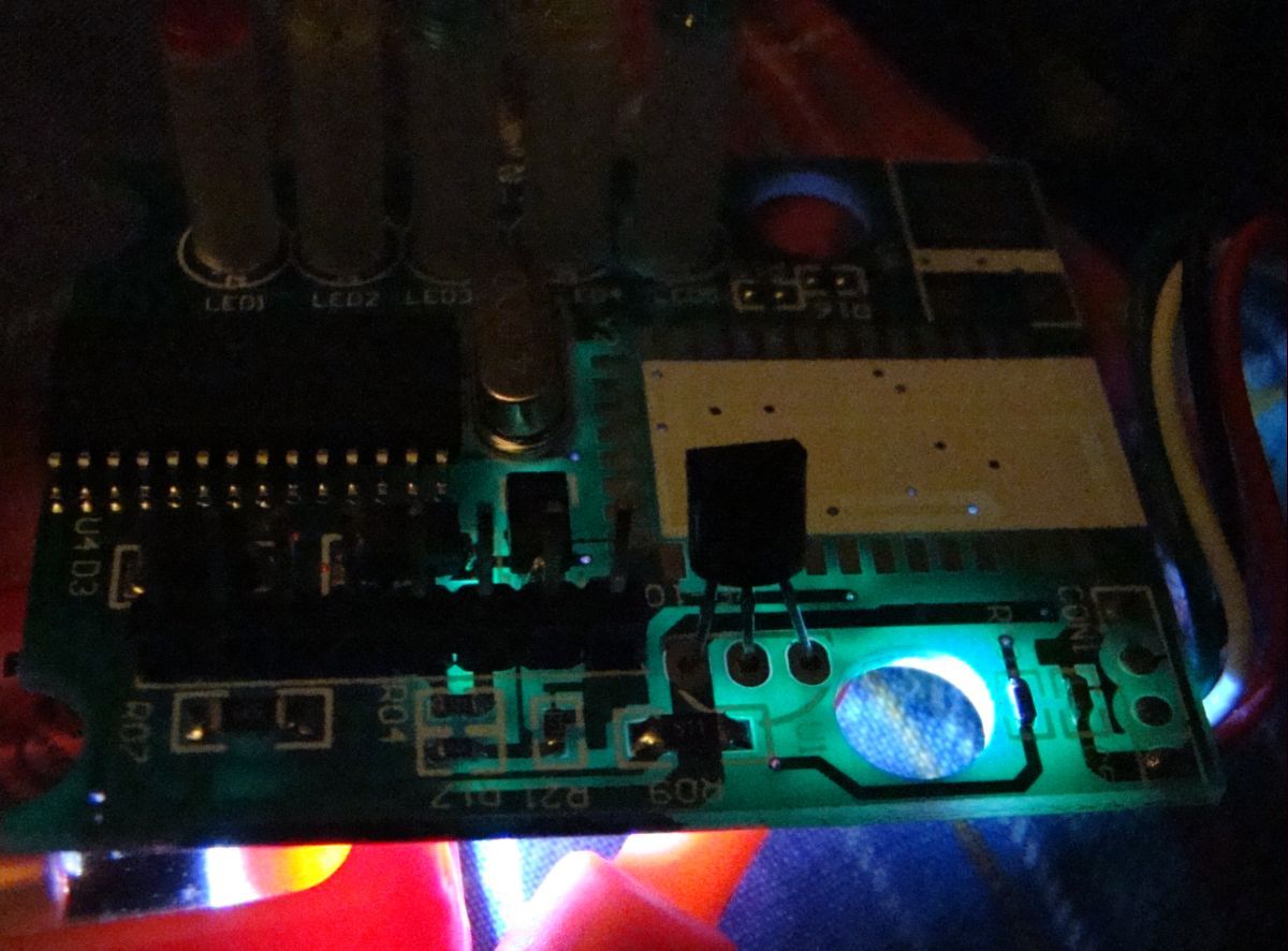

Open the ELM, and I know the 120Ω resistor in parallel to the line hight-low canbus , in the R04 near and conected to the pin of the PCB connector that goes to pin 14-6 of OBD connector .
R04
R04
DSC03673 s.jpg (141.44 KiB) Viewed 12587 times
You think that if I intervene on the line canbus as described in this topic (or the first topic) , I resolve :?:
Bye-Bye !!
Right, you have these 120 ohm resistor (R04) and remove
then you should connect to your service, body manufacture etc.
can

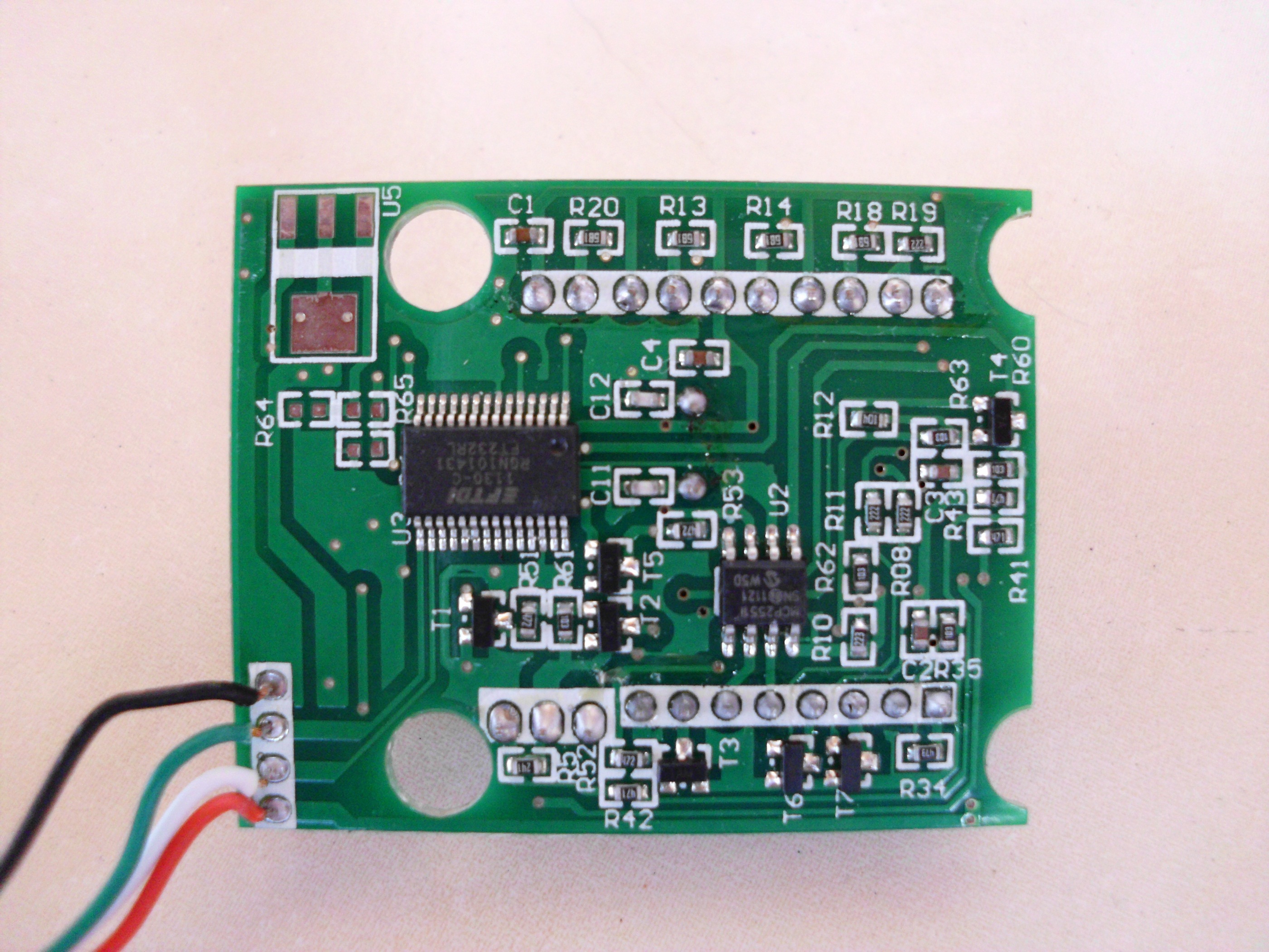

Please can someone help with my board layout? I have the same issue as the rest. I will greatly appreciate it! :D
Unfortunately, your picture from the top of the board made ​​the wrong side
I can not understand the resistance R04, which is of the third pin
the connector covers.
I guess he has a resistance of 120 ohms and connects, the
Pins 3 and 4 of the connector
because they go to the bottom of the MCP2551 and connect its ports
6 + 7
This resistance and remove your ELM also works in the CAN bus system
Or do not you a picture of the other top side to be sure.
