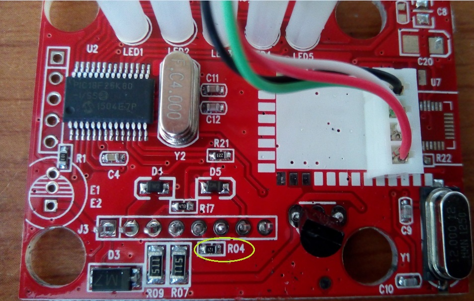

hello there...
i have this elm v1.5a
from what i saw posts above with someone that has PCB like mine, is to remove R04 underneath white plastic...
i removed r04 but i still have conneciton problem (i can connect to ecu and the parameters...but after 30seconds connection disconect).
bit rate is 38400 on FES and com port settings.
i have all tests ok in interface tests on FES...
another IMPORTANT question that i haven't found the answer, with this "hardware changes" on ours Elm327 interfaces, will afect the normal procedure of the interface while using on other protocols (scanmaster for exemple)??
this is my pcb (i have this cable for about 3/4 years)

Hi Alfaeddy,Alfaeddy wrote:Hello lonerunner
After your first contribution I have assumed that you have already established a connection, but no CAN connection get.
Unfortunately, I have to ask the same questions again and again.
Always an absolute test should always be done
With you a setting error or the wrong driver was installed?
First, you need an error test, then you can go on
The driver is correct and interface works in ScanMaster with other car brand tested (with Seat)
The error like on the image i posted appears in multiecuscan, and none ScanMaster, and multiecuscan can't connect to my car Alfa Romeo.
I did removed resistor like you posted in the image but it's the same i still don't have connection to the car, and multiecuscan fails in test. So i guess this interface won't work at all.

I have also problem with conecting to CAN, but I cant find circuit layout similar to mine in previous posts. Which resistor should I remove?
LARGE IMAGE: http://shrani.si/f/m/SN/34vv2TBe/2/wp20 ... 010pro.jpg
Hello Replica
Because your picture is very bad
And little is visible.
I can only rate it
R2 ????
What number is on R2 ?????
I can only rate it
R2 ????
Hello Eddy,
it is number 121. Should be this one?
Thank you
Thank you
REPLICA wrote:Hello Eddy,
Thank you
Yes
