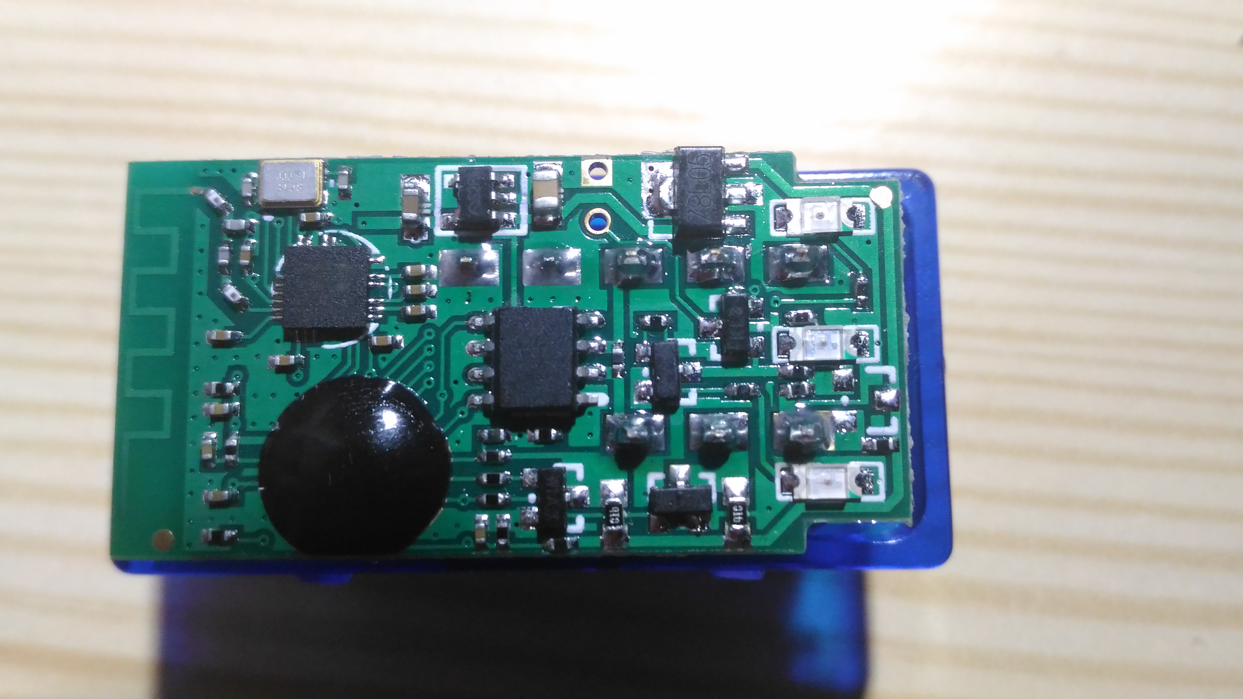

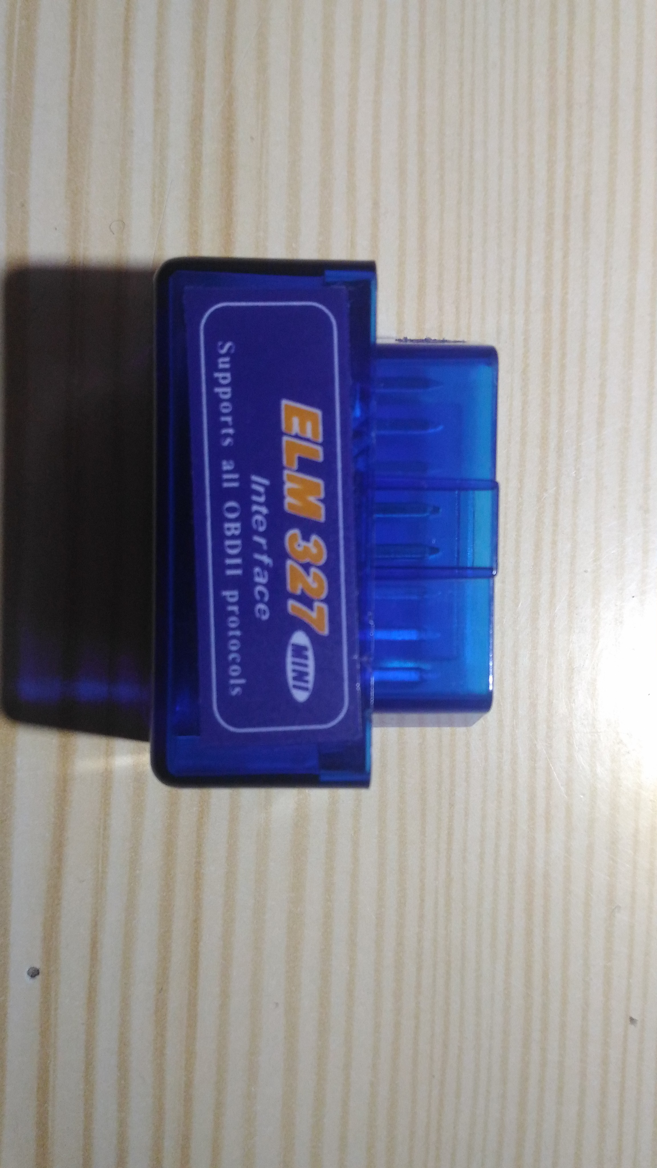

Hello Marianbatu
Check times the Resistor R34, this should have 120 ohms?
Then this is the bridge resistor!
But this alone does not have to do with the display of this interface
Compatible with MES.
Posted: 31 Dec 2016, 12:08
by Marianbatu
thank you eddy,
that was, i don't have any restistance between pin 6 and 14 but the error is the same(this elm can connect to any can module).
Can somebody recomend me a good interface for a fiat grande punto from 2005 1.3 mjet? (that blue one with switch for abs, ecu, esp, airbag is good?)
thank's
