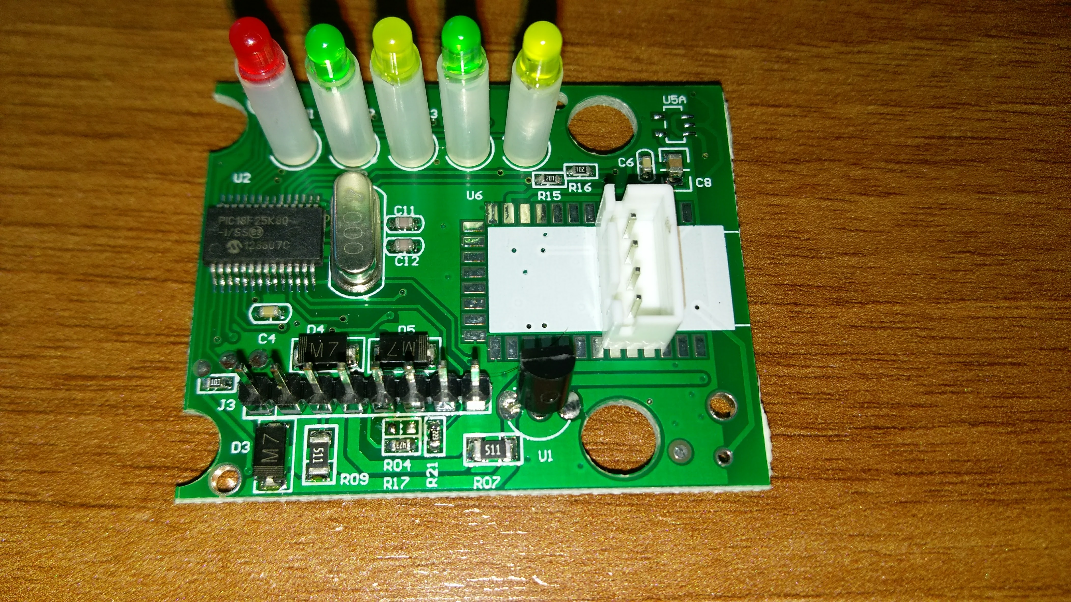

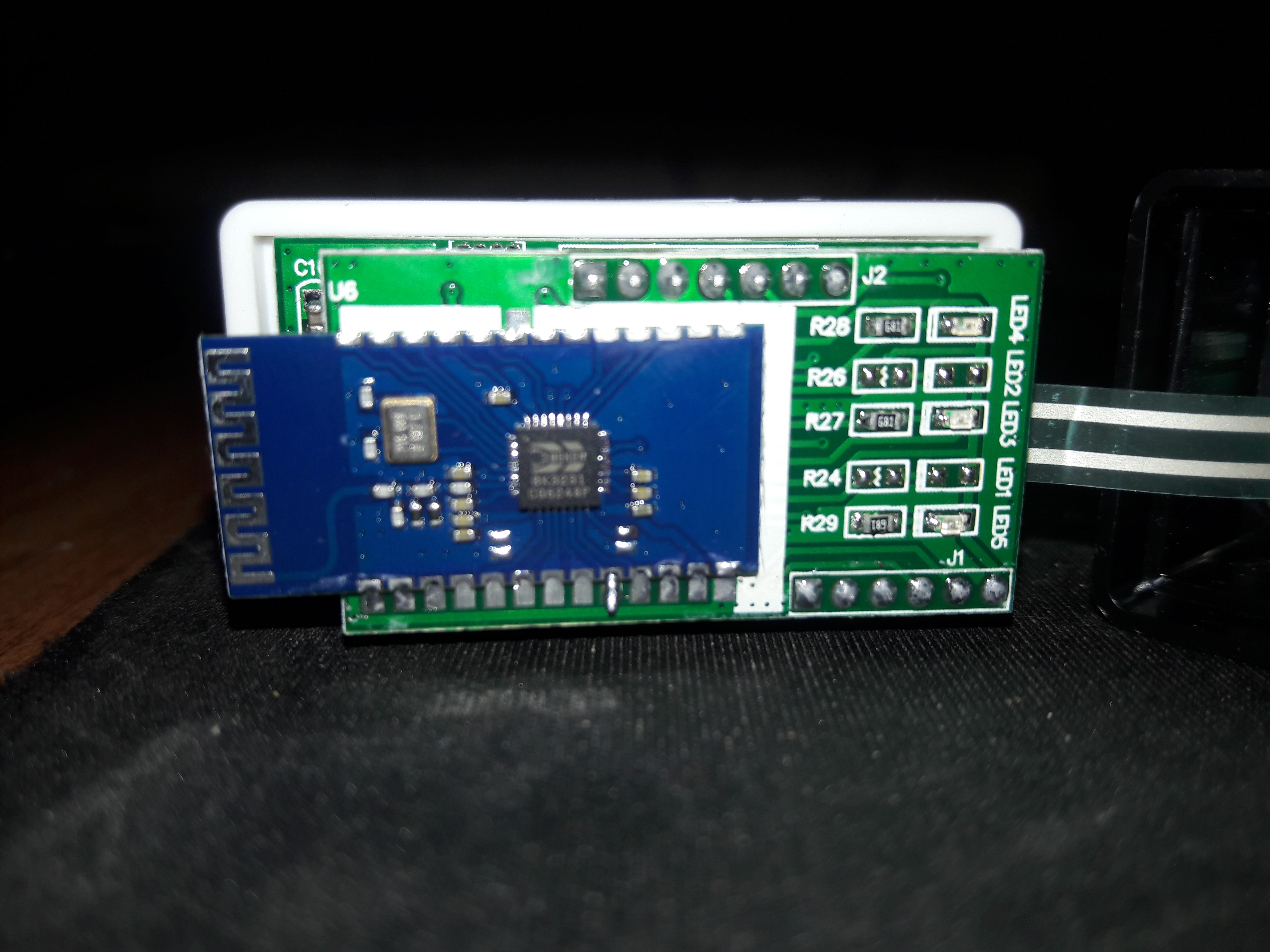

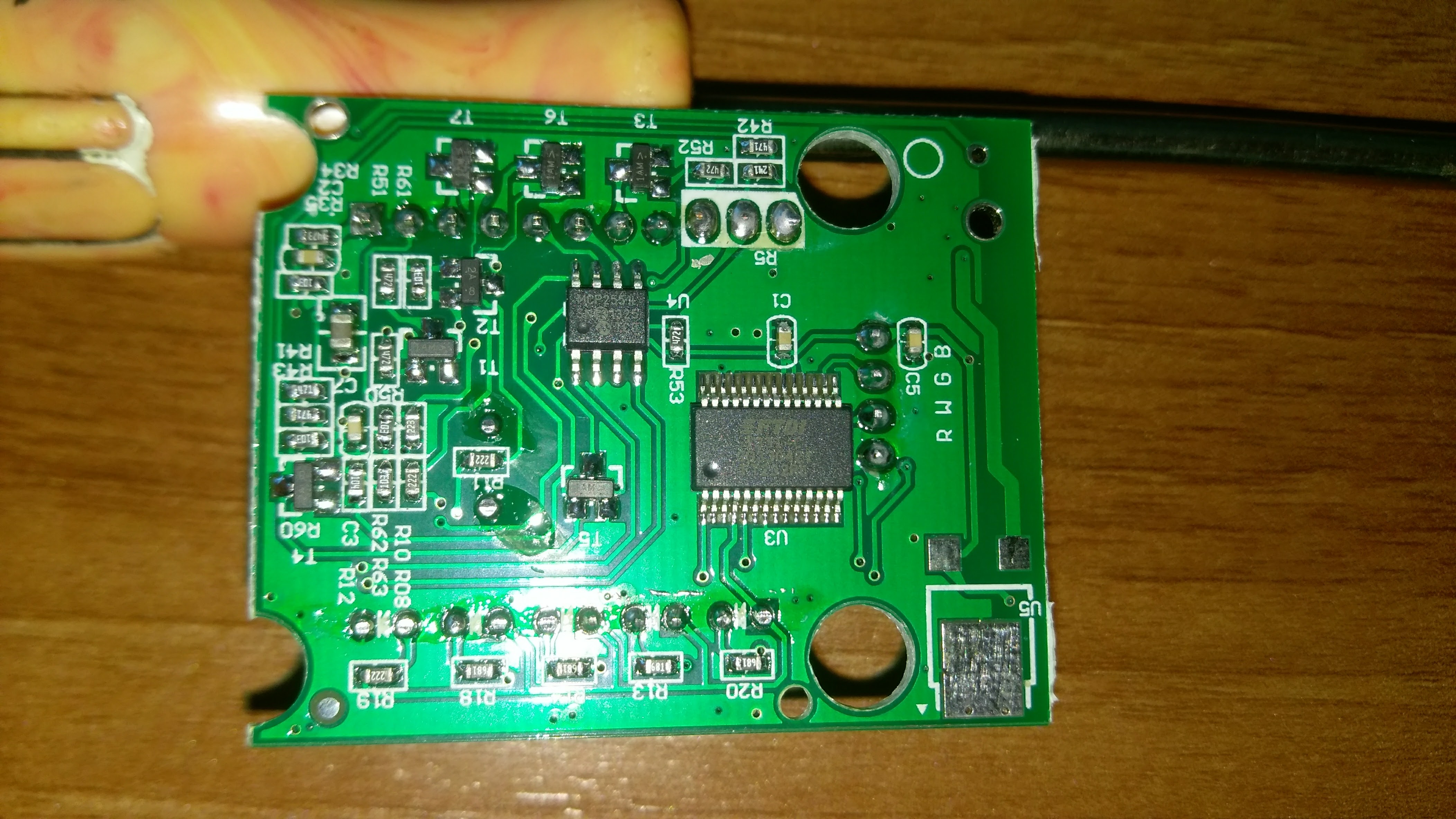

I Have an Alfa 159 and i have always connected successfully with my ELM v1.4 cable to all modules - except ABS of course - for it I use VAG-Com cable with switch.
Unfortunately I changed my laptop recently and now I cannot connect to all modules, although I use the same cable, on the same car, with the same version of FES.
Now I am able to connect only to the engine and the Gearbox ( Aisin - automatic). I am not able to connect to Body or to Service, nor Parktronic or any of the doors' ECUs.
I have opened the ELM and I see that the resistor ( R04), that usually makes this problem is not placed by the producer on the first place - that is why I had no problems with my old laptop.
The only difference now is that all USB ports on mu new laptop are 3.0 - which actually should be better, as far as I know.
I am posting some images of the interface.
Can you give me any idea what to do?
Posted: 16 Feb 2017, 08:35
This is very strange ????
At the interface it is not.
Since it has worked with your old laptop.
The bridge resistor (R4) is not available.
What driver did you use?
Please use this,
Has your laptop only 3.0 usb
Mine also has 2.0 ports
Although I do not believe this is a problem.
Make times a screen of the interface test and set this here

Hm,
now when you say - I remembered that I have not installed these drivers for ftdichip, but the COM port works OK - the cable is up on COM3, I have reduced the latency to 1.
The interface test runs OK - all is OK.
I will install the drivers and try again and revert. If it does not happen with these drivers, I will test also all ECUs with my VAC-COM cable.
Posted: 16 Feb 2017, 10:18
by yavoryankov
I installed the drivers for FTDI chip and reinstalled the driver for the COM port. My Win 10 says that there is no need to change the driver.
I tested on car, but the situation is the same... FES says that ELM327-> ECU connection is not possible
The last resort I have is to try with my old laptop, which I reinstalled and now I have to install all the things back on it.

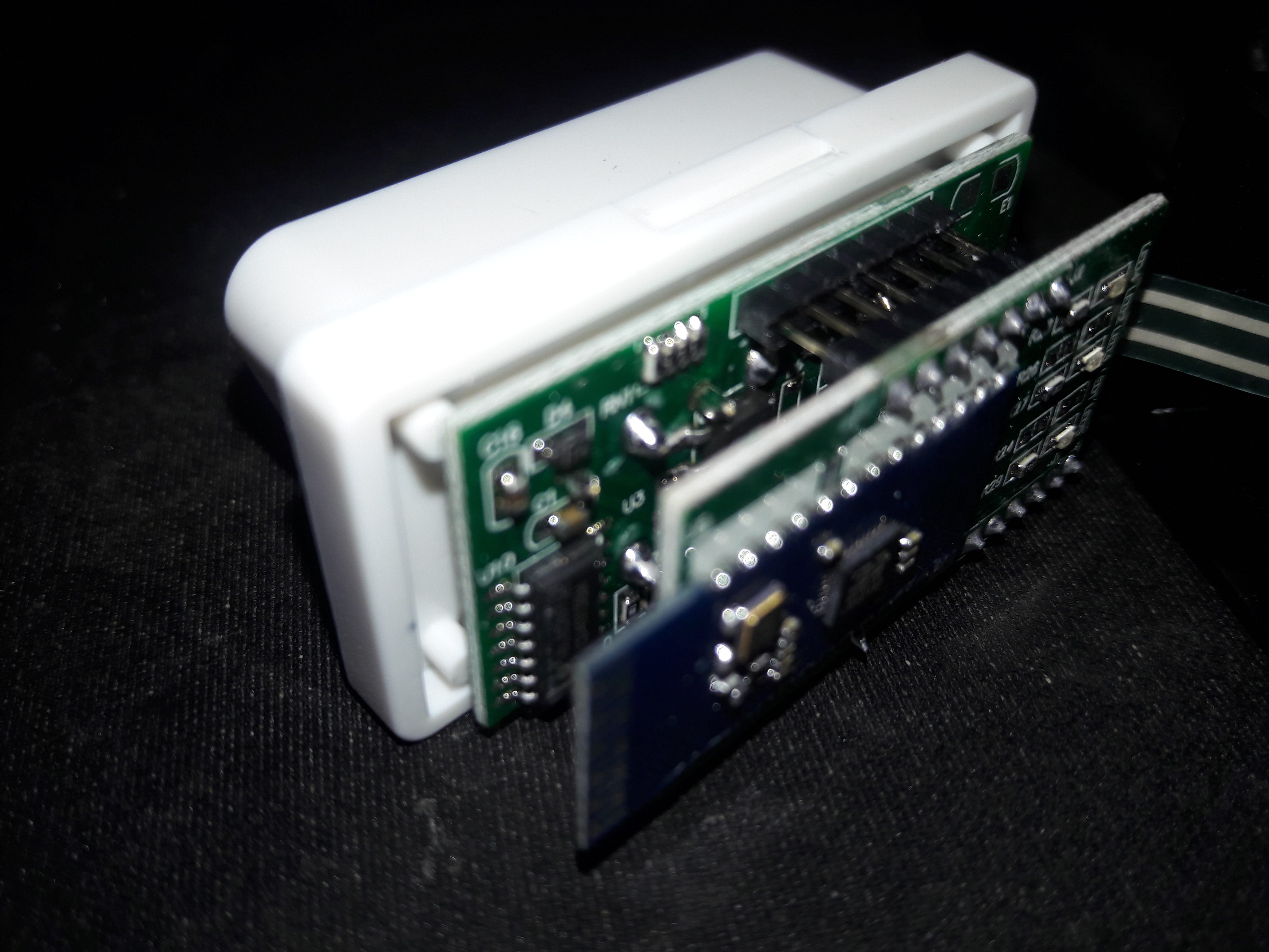

Posted: 28 Feb 2017, 18:51
by anonimo76
Hello !! I have to remove the resistor R2 "121"?
Thank you very much!!!
http://it.tinypic.com/r/21cw30z/9
http://i63.tinypic.com/21cw30z.jpg
Posted: 01 Mar 2017, 21:47
bigwolfys wrote:Hello. Who can faced with elm327? car Fiat Punto 2 1.2 v8 2000 read only engine. Where it is installed this resistor?
I understand need to unsolder the top board and see what is on the bottom?
And again, to connect to your Motorecu of the Punto, no Resistor must be removed.
Since the motor is not read via CAN bus.
If it does not work, then also with other protocols not.
The resistor of the possible CAN problems is below the first board
