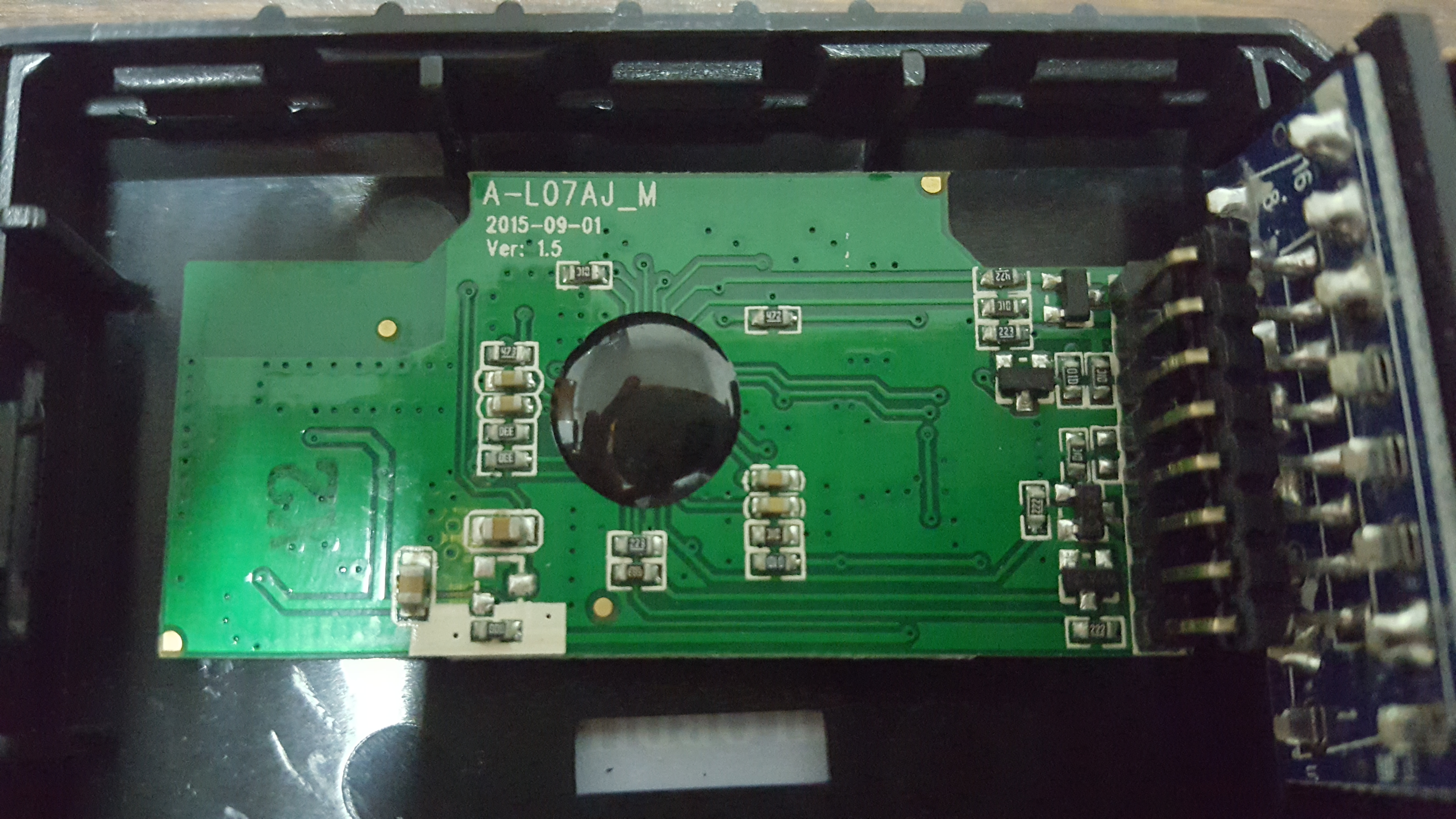

New to the forum but I'll jump straight in with a query...
I recently bought a cheapish "Pumpkin" branded wifi Elm327 box assuming that I'd probably have to modify it and remove the 120ohm resistor to get it to work correctly.
The error I get in MES is consistent with incorrect CAN termination. However, the PCB doesn't seem to have a 120ohm resistor. In fact, the resistance between can high/low pins appears to be 48.4k rather than the expected 120ohm.
Image of the board:
Any thoughts?
Or do I just buy another. If so, any decent uk amazon sellers with quick delivery?
