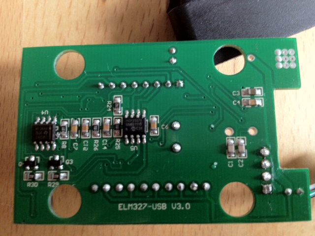

Hi Im having a ELM327-USB V3.0 v1.4 Interface, I can connect to CAN Setup/ Proxy Alignment, CAN Info, Boot, Drivers Door, but I can't connect to Service Interval Reset on my Alfa 147 2.0 TS '01.
Do I have to destroy any Resistor?
Thank you in advance
Rafael
elm327-USB V3.0 back.JPG (114 KiB) Viewed 10669 times
elm327-USB V3.0 front.JPG (168.33 KiB) Viewed 10669 times
When I see your interface is really none of which where a
Resistance must be removed.
I can not detect.
Or even make you a picture from the top of the connector
At the bottom of everything is OK.
Did you work with the ELM interface connects to your engine control unit
can do?

There seems to be quite a few ELM327 clone with different layout. The issue is the way CAN signals are connected, that is pin 6 and 14 of the ECU connector. You have to trace them, determine if there is just a 100 ohm resistance between them and no RC. If you are not familiar with electronic, better ask around you someone who does. This to avoid damaging your unit. It is a 15 min. job.

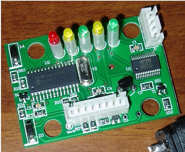

I have this ELM 327 USB firmavare revision 1.3a or something I need to modify? if anything, this version is ok
if you need to do something please let me select the picture
http://imageshack.us/photo/my-images/684/elm1.jpg
http://imageshack.us/photo/my-images/29/elm2c.jpg

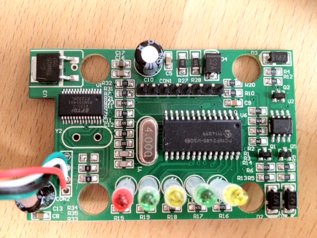

i have an old piece from ELMSCAN5 USB tool original its H/W Ver.1.4 and F/W Ver.1.1 Mfg. date 24 April 2007 its the old large board i dont have the bad wrong 120ohm resistor ,,i have the 2 100ohm resistor like the circuit from ELM Electronics website ...aim trying to connect to My Linea 2009 but it says the following log :
RESPONSE: ?
RESPONSE: ?
RESPONSE: ?
RESPONSE: ?
I think iam facing an old elm327chip program !!! please advice do i need a new chip or small modification or a new tool ,,, below is the link for the tool i have
[http://imageshack.us/photo/my-images/81 ... n5usb.jpg/]
Your ElmScan 5 is too old. Version 1.1 does not work with FES
I have a ElmScan 5 V 1.3 and this works very well.
It uses some resistors to solder anything.
The software on the chip is not the right one.
Buy yourself a different interface
greeting
