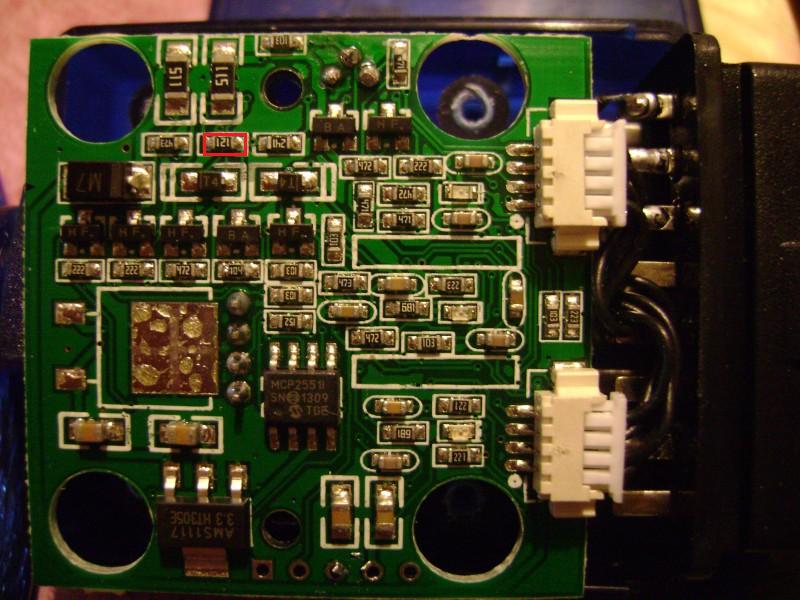

CAN bus protocols not to read?
According to a user, this red resitor
then remove the CAN bus problem should be resolved.
Mini ELM markiert.jpg (80.86 KiB) Viewed 9876 times
I assume no warranty for the data.

but in a previus post you said that this resistance should not be the right one...is it?
Re: Elm 327 v.1.5 (V Gate Bluetooth) Connect problem
This interface I have not and do not therefore know the structure of the board
therefore I said that I do not know
But Anomio76 described in this post, he has removed the resistor
and now this ELM works
viewtopic.php?f=5&t=1493&p=13587#p13586

Mine is a little bit different, do you think is r2 that one to remove?
As anemonio67 already writes remove the label
including you find the screws.
Yes, I think R2 (121) is the bridge resistor
controlling nor whether the solder pins go under to pin 6 + 14. ?
Then R2 is correct

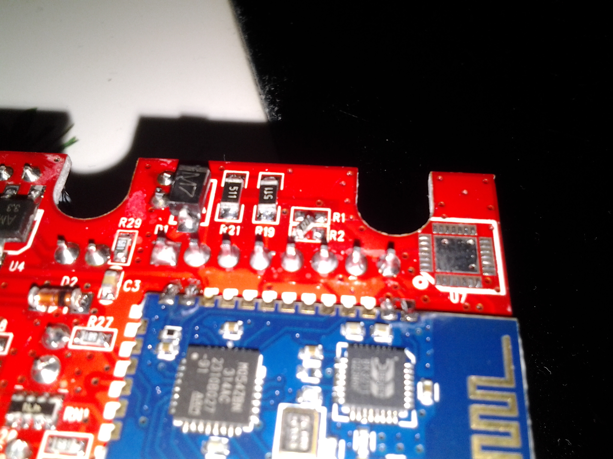

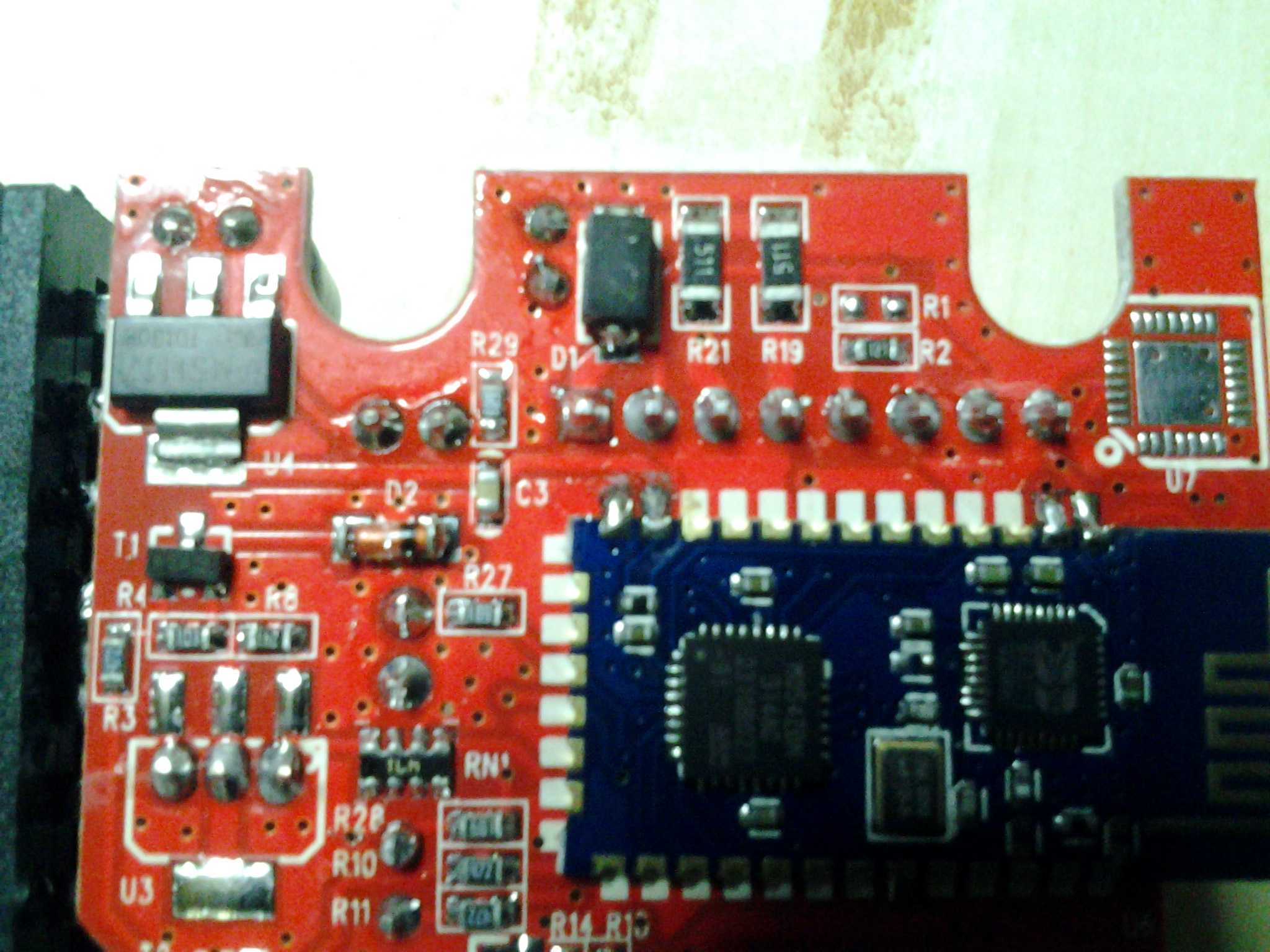

Hi.
I have a Vgate Bluetooth ELM interface v1.5 too.
Outside look identical to the one in this thread, but when I opened it to remove that resistor, I found that inside it's different.
Can you help me to identify the resistor?
Thanks a lot.
Full size:
http://imageshack.com/a/img834/9863/q47p.jpg
http://imageshack.com/a/img577/540/0nu6.jpg
