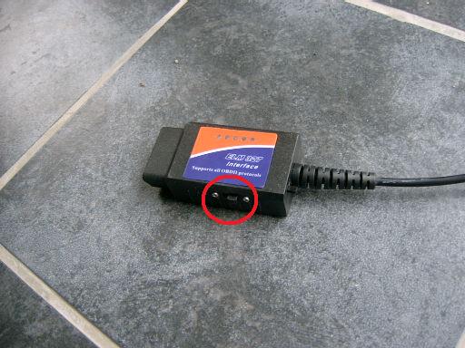

Posted: 13 Feb 2015, 20:10
I have this CAN bus switchover in 2012
as realized
The instructions are in German though, but maybe you can help the
For xenon is simply a solder to make bridge from pin 7 to 12.
- SV300015 CAN Bus.jpg (46.77 KiB) Viewed 10058 times
Finish looked the interface like this
