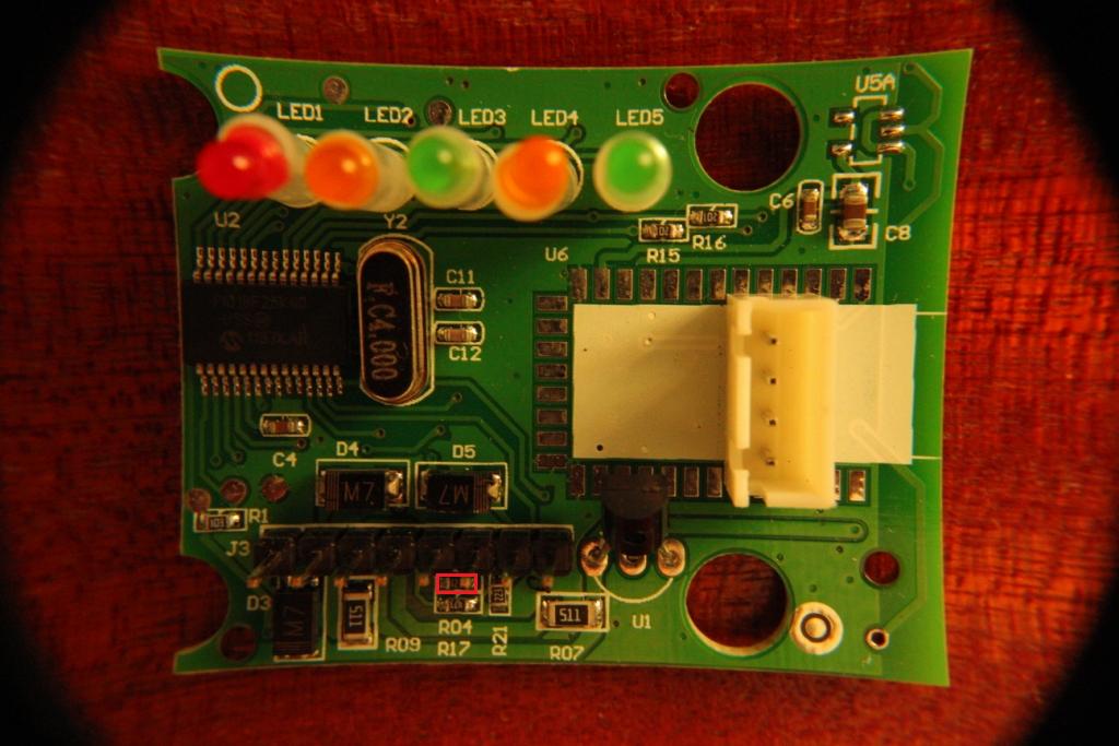

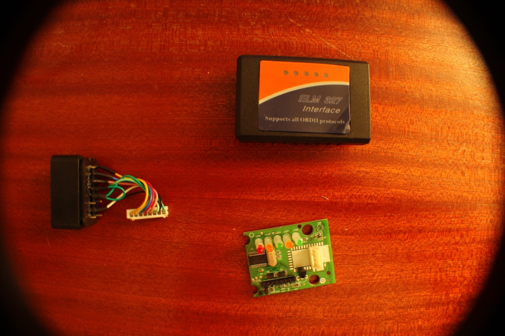

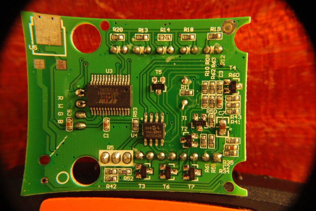

I have an ELM 1.4 usb cable, it works fine with non CAN modules, but i cant connect to the CAN modules even with the adapters, can you tell me what modifications i need to do in the circuit board? which resistor to take off

Hello zredaf
This ELM interface we had had several times already.
You can see it would have been in previous posts
Remove the red marked resistor and then your ELM
also usable with Multiecuscan CAN Bus
