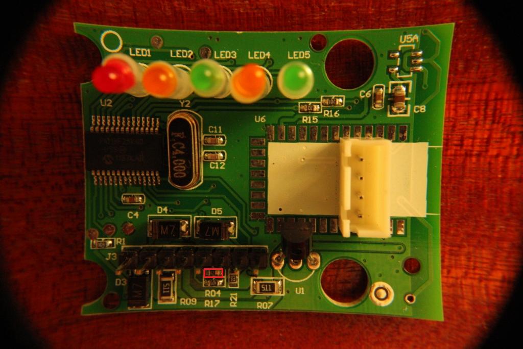

I have an ELM 1.4 usb cable, it works fine with non CAN modules, but i cant connect to the CAN modules even with the adapters, can you tell me what modifications i need to do in the circuit board? which resistor to take off
Posted: 30 Jan 2013, 18:46
Hello zredaf
This ELM interface we had had several times already.
You can see it would have been in previous posts :)
Remove the red marked resistor and then your ELM
also usable with Multiecuscan CAN Bus
IMG_2289 markiert.jpg (102.84 KiB) Viewed 17290 times
