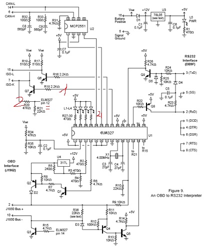

Well ok, you're right , what shall i do now? testing continuity is difficult and there are two branches. I tested branch one but i guess it's branch 2 which is involved here...the only cause I see then is my circuit not being powered or something faulty...or I need a weird set of parameters?....
and so pin 12 involved...
so now i'm thinking: how to check for the pic18f aka elm 327 is working???
Have you checked if this wiring diagram with your interface with a true?
For thine CAN bus connection on the circuit board is also different from the schematic
Check again the K-line connections then your interface should also work if the chip is still OK!

Hello, yes it is the same as mine, very same indeed...
