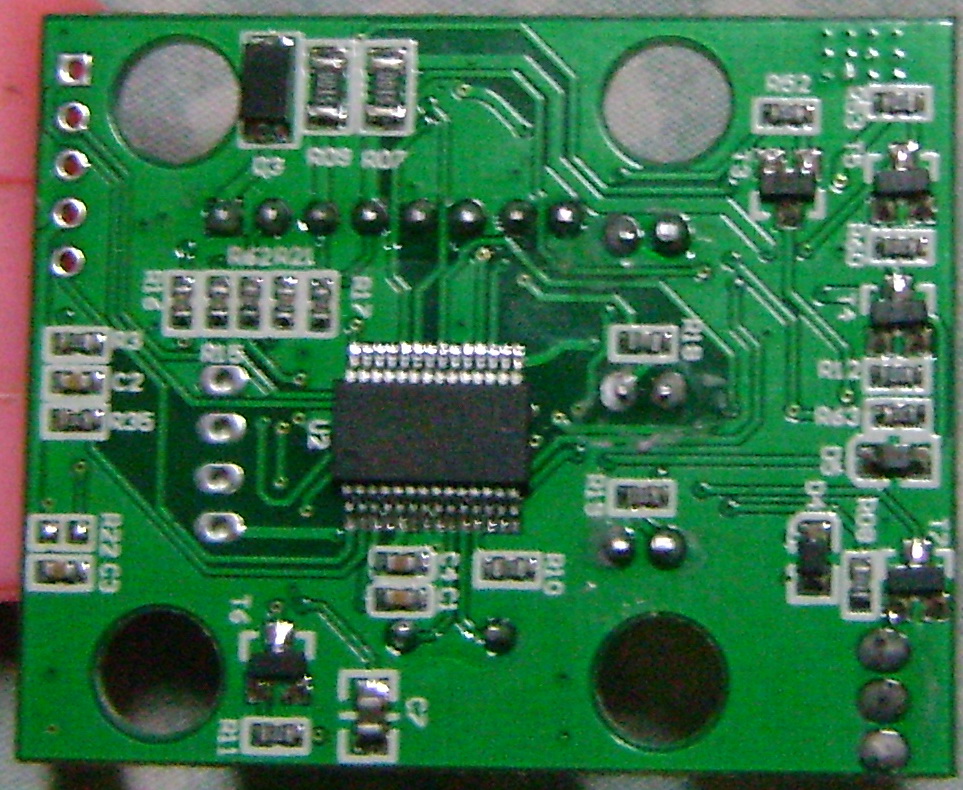

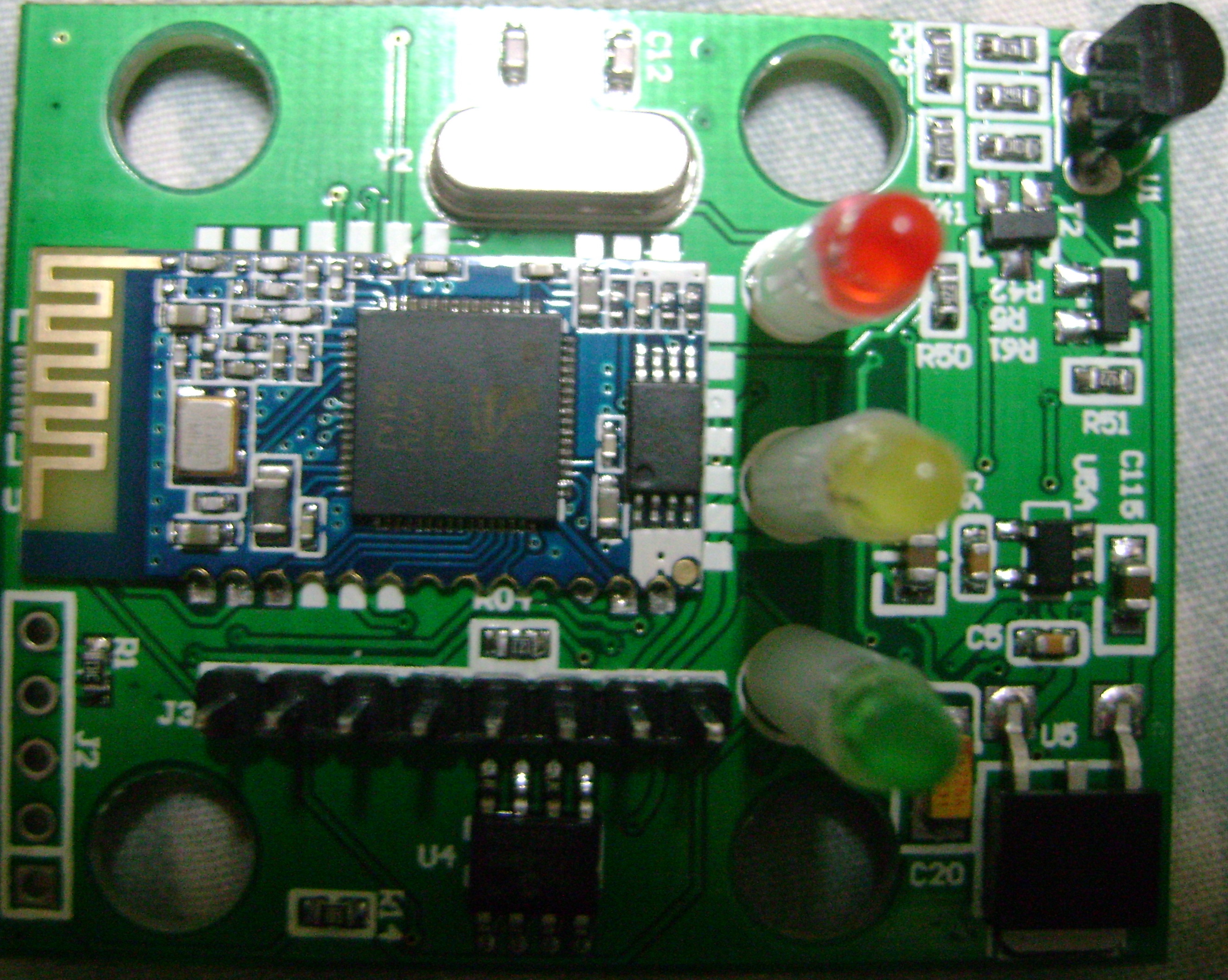

hello Eddy,
i bought this interface and it only access engine, please help me to modify the interface so i can access the ECU and power steering and body computer

Hello Stapy
Sorry, your picture is very unclear, I can barely read a label
What's on the chip U4 for a label?
This is an MCP ...... then R4 should be (121) via the connector strip of the incorrect resistor
But in this picture I can not see anything
yes Eddy this is MCP, shall i remove the R4 121 ?
