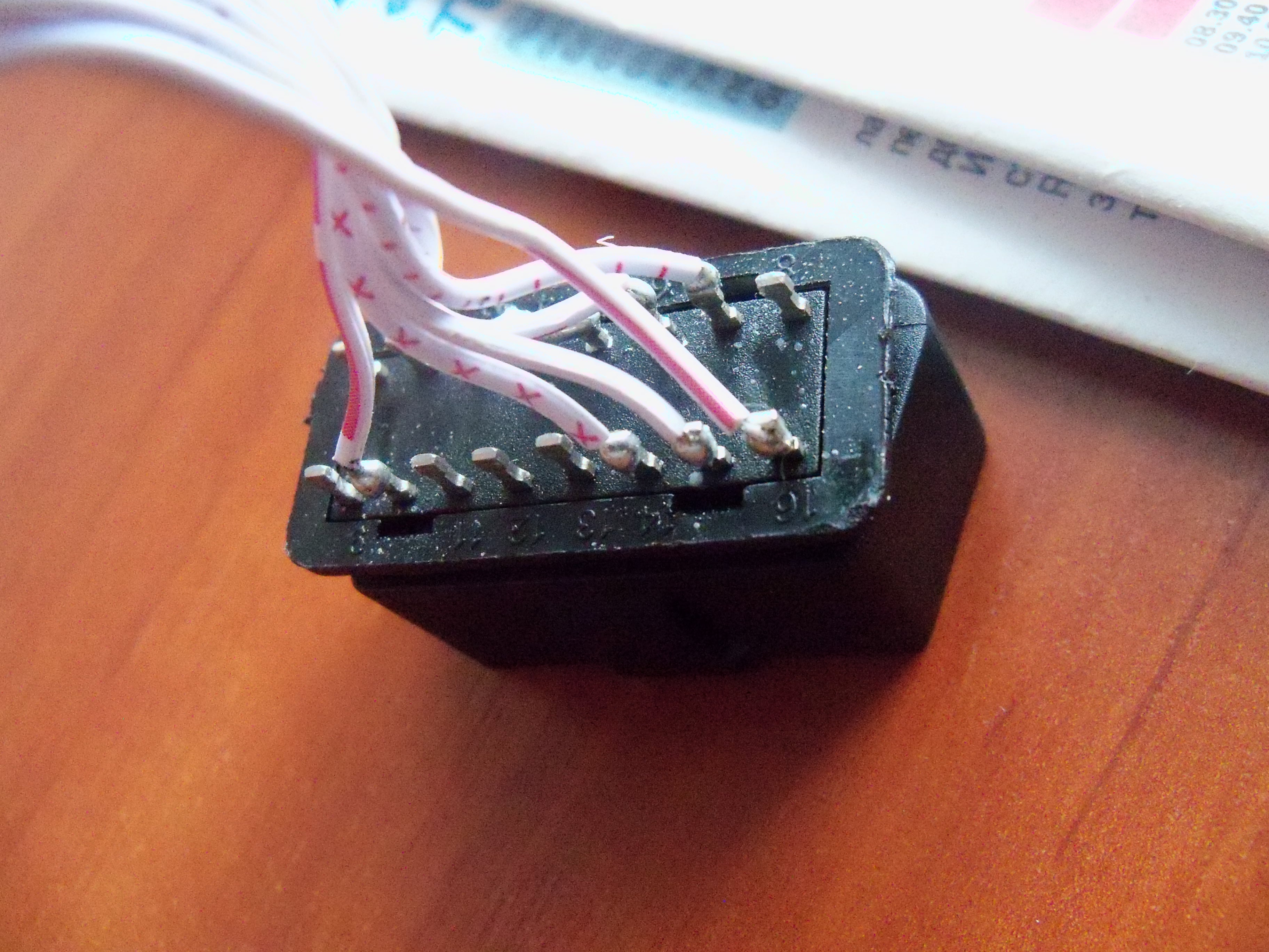

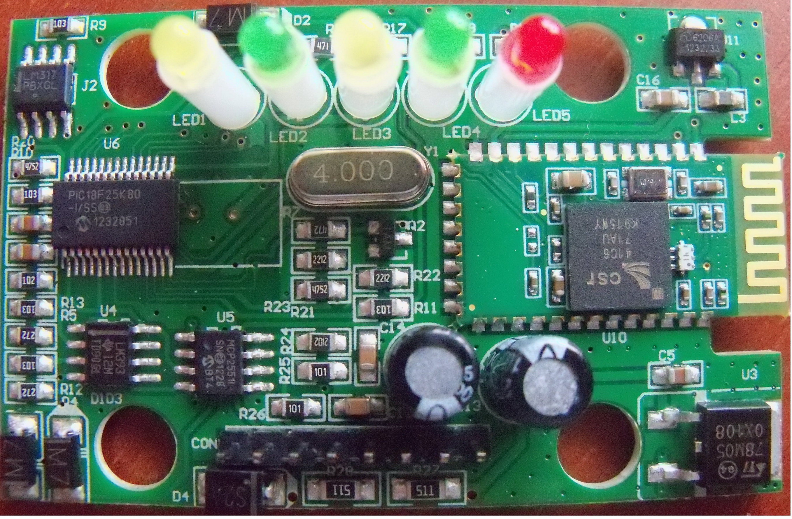

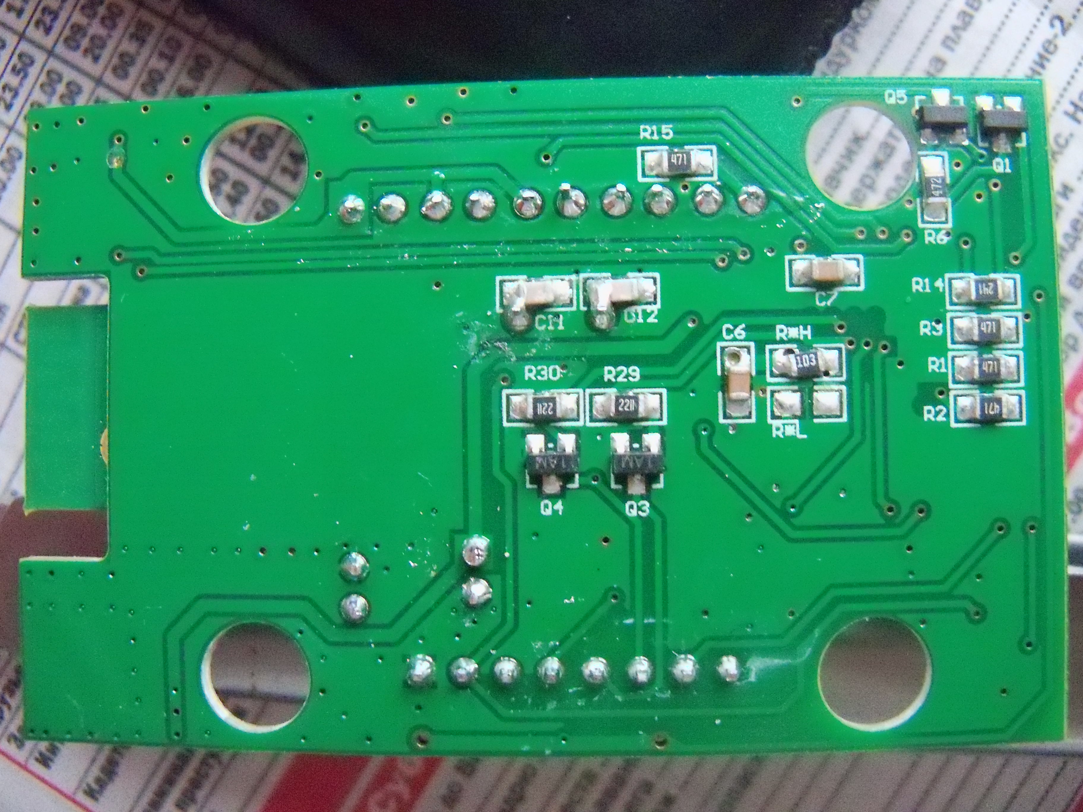

Hello Eddy! My ELM327 sees only the engine and ABS.
Need help.
Thank you.
Need help.
Thank you.

Hello Yuker
Which vehicle do you want to read?
What controls you can not connect?
When I check that board, has not your ELM CAN bus problem

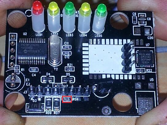

Hi Alfaeddy,
Could you please confirm that if i remove the R04 Resistor i will be able to connect to the Engine Ecu and Can Bus Ecu ?
Diagnostic Connector :- ELM 327 V1.6 (Dated 2012/7/16).
Software :- Multiecuscan.
Car :- Fiat Stilo Abarth.
Circuit Board Photos Attached.
Thank you Alan.
Thank you Alan.

Hello Alan
What engine does your Stilo Abarth?
Which year?
Is the ever support of Multiecuscan?
For access to your engine control unit you should also not remove R04 can
This interface we have often in this thread
Then your image is very bad!
But I have highlighted the relevant resistor red
Remove the R04 and your ELM should be able to read CAN bus
Which year?
Hi Alfaeddy,
Thank you for your reply
Sorry my mistake, i can access (connect) to the Engine Ecu
Answers to your question ;- Fiat Stilo Abarth Selespeed 2.4 20v - Model Year 2002.
Thank you Alan.
Thank you Alan.
