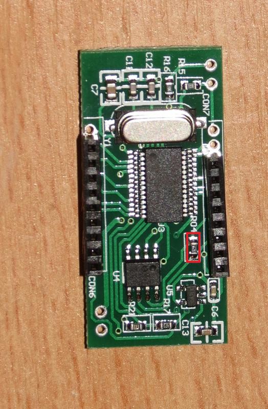

and for the CAN Bus Problem remove R04 and you can read
Body Computer
CAN setup
CAN info

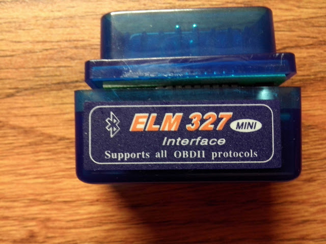

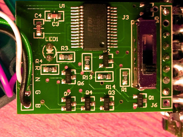

Hi, friends. I have two items - elm 327 mini and KKL Interface switched. When I scan for device (F11) I get error "U 1601"
car: Fiat Linea 1.4 16V T-Jet
Need help. Thanks a lot.
elm 327 mini:
KKL Interface switched:
Sorry if this has already been discussed. )

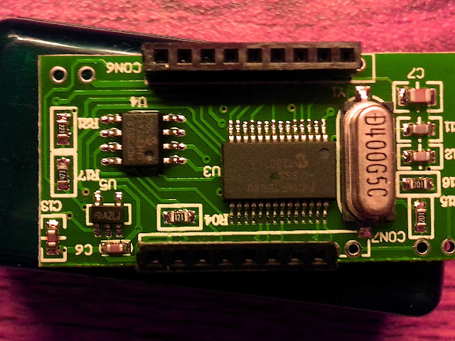

Hello zaka
Your error U1601 means that the settings
Interface / COM port / not correct
Have you installed a driver for the FTDI interface?
Remove the red resistor R04 on ELM 327 mini
Then you can connect to the Can Bus establish controls
The KKL interface No error is present, this can be you
You need the KKL only for your ABS (Switch 1/9)

Alfaeddy wrote:Hello zaka
Hello Eddy.
Thanks a lot for your reply and help. The KKL had a conflict with the settings of usb port on my PC. Now everything connects normally except for one thing. When I connect elm 327 to the diagnostic connector, on the dashboard the control lamp "fiat code" is on and the engine isn't started. if I connected at the working engine, all devices on the dashboard are switched off (except for the fuel level sensor). This is the way it should be? Thanks again.
