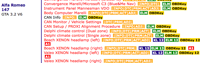

So when activated, connect together pin 7 and pin 12 (making a bridge)? I need just to connect to xenon!

Re: FES won't connect with Adapter Cable 3
Post by Racing Man »
Waltomatic wrote:Racing, you can include 12-7 in it, respecting the disconnection of 7 when linking with 12.
I've tried that way, but it don't connect with the xeno ecu...
In normal operation, just switching the wire 7 from pin 7 to pin 12, it doesn't connect... So, seeing adapter #1, where 7, 9, 12, 1 are linked toghether, maybe to connect with xenon pin 7 and 12 must be joint together to wire 7?
No, according Supported Vehicles you need the same A3. You welded wire on pin 12 of connector?

Waltomatic wrote:
No, I've only put a switch on wire 7, that connects pin 7 or pin 12. Should I weld pins 7 and 12 together? Why the same A3? In this picture is shown A1 :|

Waltomatic wrote:Cáspita!!! Você não disse que era do Alfa, kkkkkkk
Meu conselho: esqueça a adaptação para o Alfa e compre um cabo.
I've written it few pages before, I forgot to repeat it! :P
And that's why I've welded some pins together before!!! :D
I've to try to weld together pin 7 and 12 to wire 7, and see what happens... :D

Post by Waltomatic »
Let It Be...
Well, as I said it would be more accurate to buy the adapter 1, but you may even be able to. Each adapter connects a wide variety of vehicles and systems, and perhaps Alfa not need all the wires together. Hopefully, only 12-7. My diagram allows this option.
