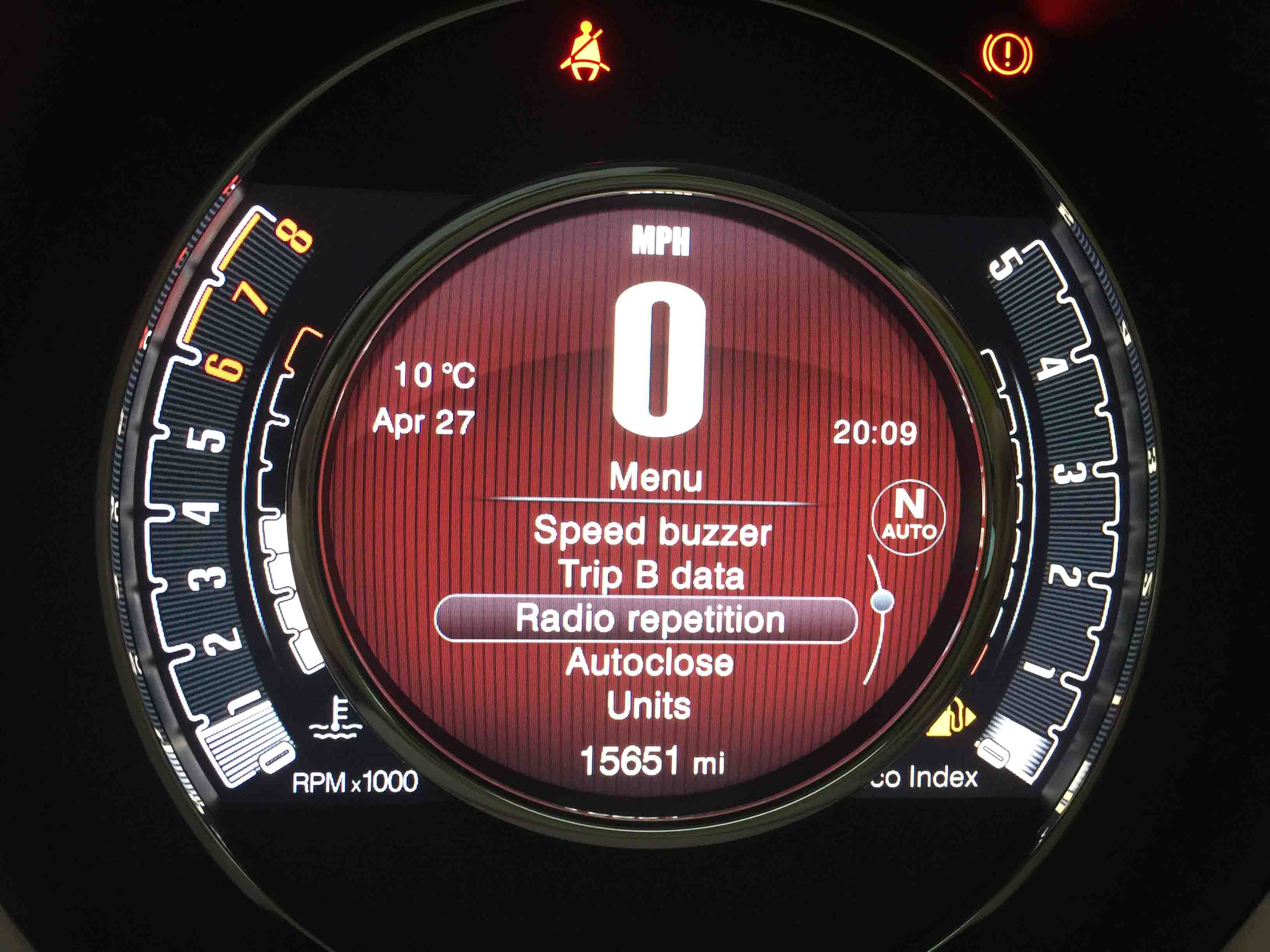

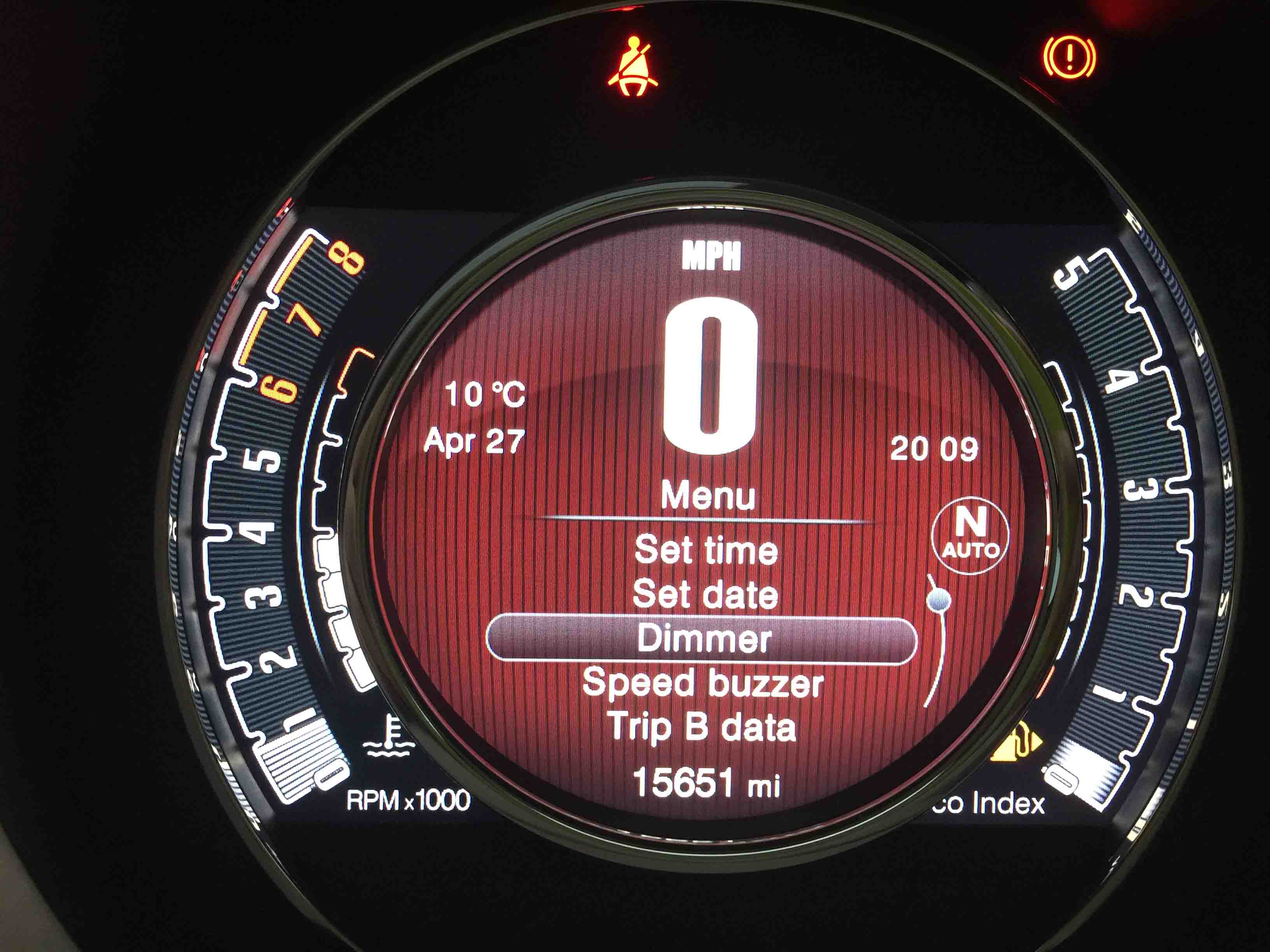

This is just for information, further to what Alex has said.... The photos below are a European 0.9 Twin Air 2014 with standard TFT and old Blue&Me radio. The Custom Proxi screenshot I posted a few days back are from this car...

snowbound_sonic wrote:This is just for information, further to what Alex has said.... The photos below are a European 0.9 Twin Air 2014 with standard TFT and old Blue&Me radio. The Custom Proxi screenshot I posted a few days back are from this car...
Perfect!
In fact we both posted the proxy code of a Fiat 500 0.9, but my is Sport 105cv with SPORT button and turbo indicator in tft,while your is Lounge 85cv with ECO button.
I'm wrong?
Perfect!
I'm wrong?
I have a 2011 Abarth 500 with the 2016 TFT screen. The photos are from my friend's Fiat 500 Lounge.
