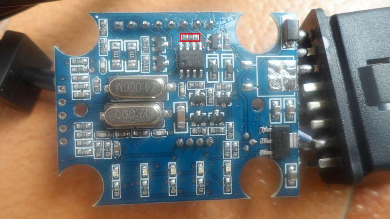

Hi Eddy.
I've removed R04. It is seen on the picture which I've added to my previous post. Is that true? Or was it the wrong one?
Now it seems it connects.
I didn't try to connect with R04. Sorry, I have no info about the original situation.
Thank you for your help.
Hello obk
You must also use the R04 can connect to your ECU!
Just read airbag, service interval, CAN setup, etc. you remove the resistor R04 (121)
The original version of your ELMs is how did you buy it!

Post by obk »
I understood that removing R04 has no disadvantages for me. I'll connect all CAN and ECU modules without R04. I don't need to resolder R04. Am I right?
I bought it from a local seller, the cheapest one in the local market. So I didn't need to buy from ebay. But sure it is a chinese fake clone. It is a v1.5.

Alfaeddy wrote:Hello Giuseppe
Please this time slowly
This ELM interface you can convert without something
on Fiat Stilo read the ECU / ABS / Steering
For the air bag you need a KKL interface
For the Fiat Croma
So you can read without a rebuild your ECU / ABS / xenon
Only for the airbag / Body Comp etc. you may need to change something on the interface.
If you get no connection to the ECU you have the settings / Com port set incorrectly
First check the time settings
I bought un'elm327, and when I go to read, with Fiat ECU scan, the data of ABS and airbags, I find the error that can not be read on the K-line to pins 5 and 7 ....... it seems to me;
how can I change it, I'll post pictures:
Hi Giuseppe
Do you remove the Resistor in the red Frame marked in your Picture
and your ELM Interface read now CAN Bus
52518130123513639238677 markiert.jpg (57.25 KiB) Viewed 7411 times

Alfaeddy wrote:Hi Giuseppe
Thank you,
eliminating this resistance, therefore, can connect on CAN and on KKL?
We must not make any other changes to the pins?
Very smart
Hallo Giuseppe
You must remove an Resistor not the Resistance ;)
The KKL Interface can not work with CAN Bus
So at the KKL is also nothing to change
