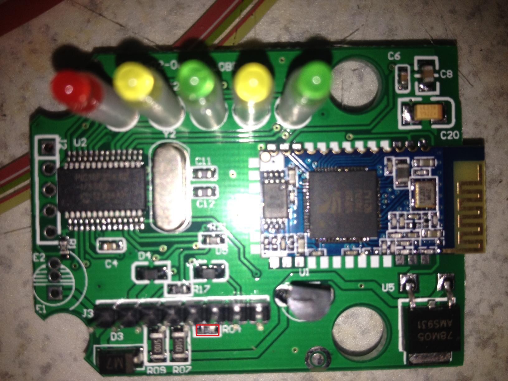

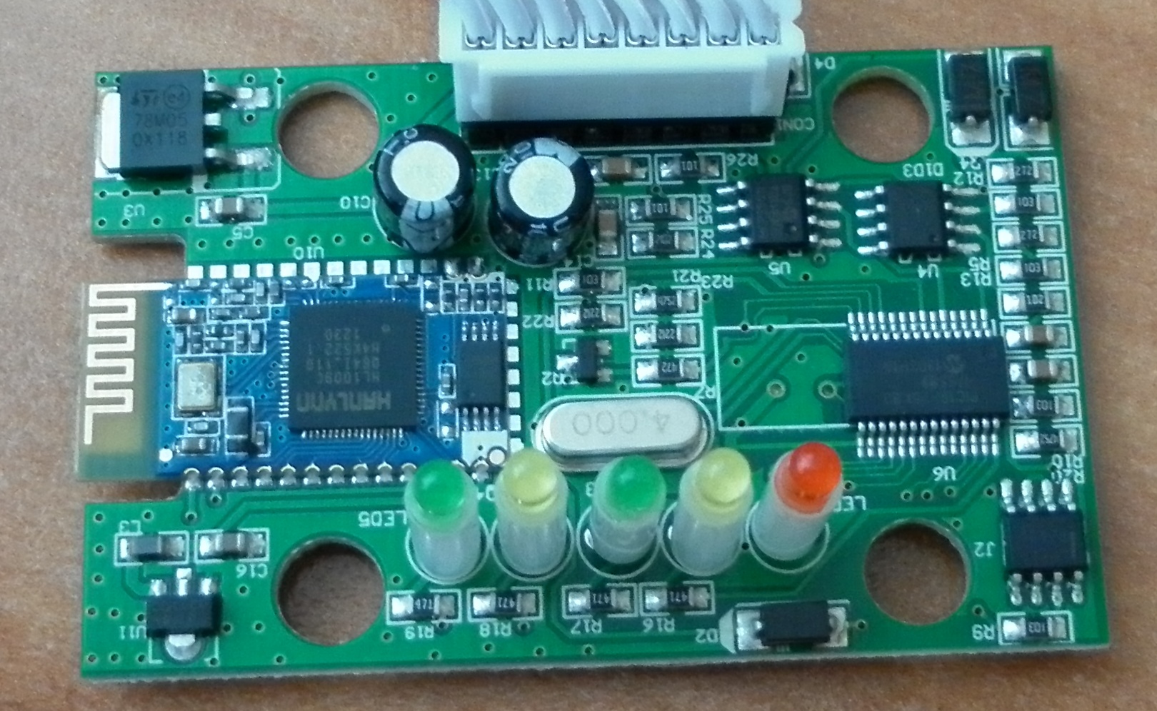

Can somebody help with this interface
Hello Hamirom
Remove the red marked resistor
Since you do not write what vehicle and model you want to read
I guess times on a CAN bus error
Your picture is very blurry but just enough
photo3 markiert.jpg (236.08 KiB) Viewed 8439 times
