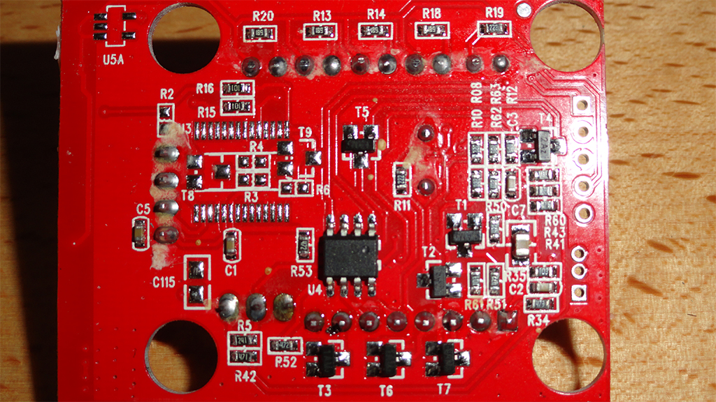

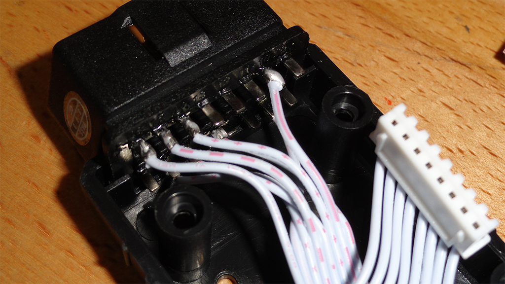

hello guys! nice to meet you, my name is rodney and I live in Brazil.
I would love the help of you, I have a fiat punto 1.8 8v 2008 to acquire a scanner bluetooth, it connects the multiecuscan but can not read any parameters, and I need to align the proxy as it replaces the central blue & me ...
this scanner is of a very small size and has a plate beneath the other .. I took some photos, if you can analyze be very grateful, and excuse the typos, I'm using google translator ..
Thank you all!
hugs
Thank you all!
hugs
Mate
Very easy. Check the OBD pins 6 and 14 with a multimeter and see that with will have 120 Ohm
Then check with the multimeter the continuity to the MCP2551 pins 6 and 7
And you'll find the rezistor called 121 on PCB that it is not showed in your pics becasue you didn't removed adn we don't see it
P.S. - the rezistor cannot be see it if you do not remove the pcb with bluetooth. It is in a position that you cannot be showed if you try to make a photo. But you can remove it without removed the upper PCB

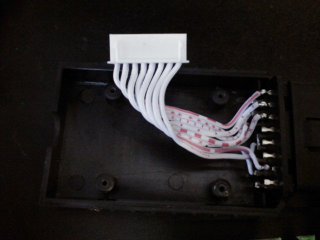

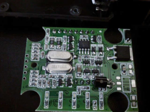

hi there,
i have an elm 327 interface,1.4 and i cannot conect do CAN with her.i can connect to the engine,but that all.i'wd lookt on this forum for the right bord and i'wd thot that it's look like the one from the page 36,from the post of knata.i'wd removed the resistor specifying 121,but now the interface is not working at all.When i connectid to the car today,on the dash bord and radio was saiyng that there is no CAN Notework.I unpluged the interaface and everything became to normale.Is the interface dead or do i have to do something else to her?
Thanks.
I have a Fiat Stilo 1.6,2001
Thanks.
- elm2.jpg (61.11 KiB) Viewed 11260 times
- elm1.jpg (74.87 KiB) Viewed 11260 times
- elm.jpg (93.54 KiB) Viewed 11260 times
Your picture is unfortunately very bad and blurry
But if I am not mistaken is on your board nor the bridge resistor
available
Do something please once again from the third image with a macro function
Because, as I see the resistor of the MCP 2551 is still available?
available
Alfaeddy wrote:Hello
available
The picture is made before removig the resistor.I'wd removed the resistior and the interface gone dead.when i plugit in the usb slot from my notebook it is not longer recognized,the notebook doesent see her pluged.I think that something gone bad when i removed the resistor.
Thanx
Removing the rezisto has nothing to do with the usB
Check it in the Device Manager and see how it is ( yellow maybe )
And instalkl agian the drivers

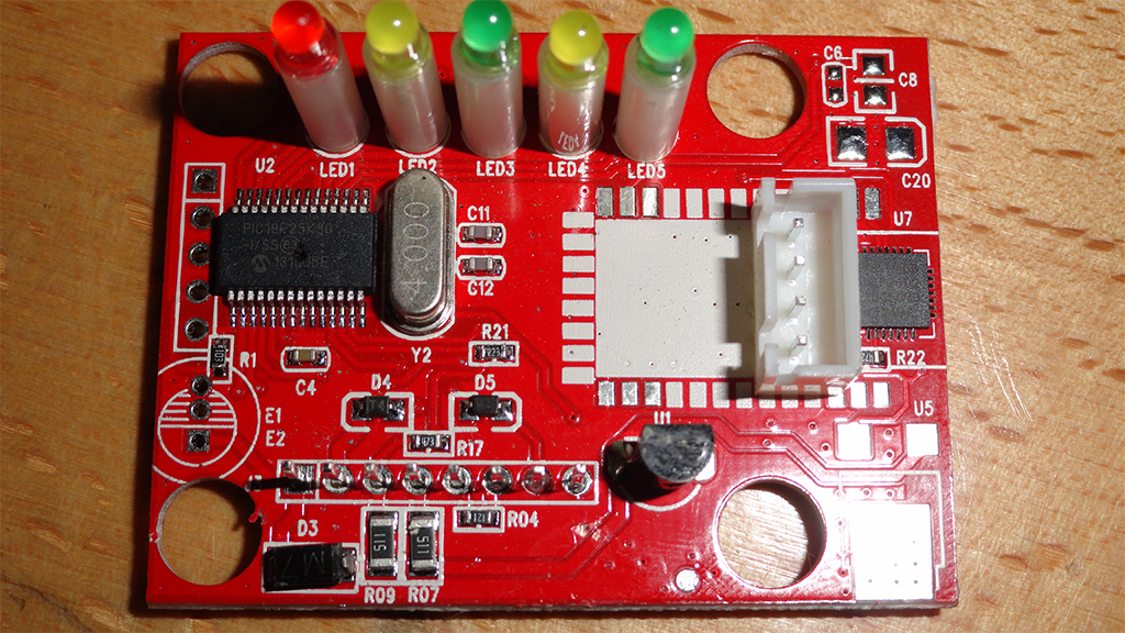

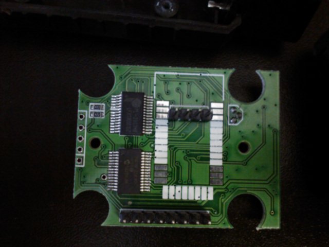

Hello. I have 1 ELM327 1.5, and I have some problems, the elm refuse to conect on my AUDI A4 B5 1997 airbag modul, ABS modul, only engine (I have Airbag light on and I want to turn of or see the error cod), on Ford Fiesta 2002, Petrol same story, ELM conect to engine, but on the ABS no. I attach some pictures with my ELM, please say me what I need to do to can conect at all moduls. Sorry my english. Thanks
- DSC09697.JPG (742.94 KiB) Viewed 11232 times
- DSC09694.JPG (515.72 KiB) Viewed 11232 times
- DSC09693.JPG (710.02 KiB) Viewed 11232 times
Mate you are in wrong place
All you ahve to do it to search in google what softwears you need for Audi and Ford and much more what tools because the ELM327 it is not a good choice.
I suppose that in VAG car you use the softwears that come with interface and that's one have coverage only in Engine ECU
For VAG car ( your Audi ) I recomand you VAG-COm/VCDS
For your Ford you need other softwear and you'll have a better coverage in all controlers
But please you don't need to do any modification in ELM327 tool
