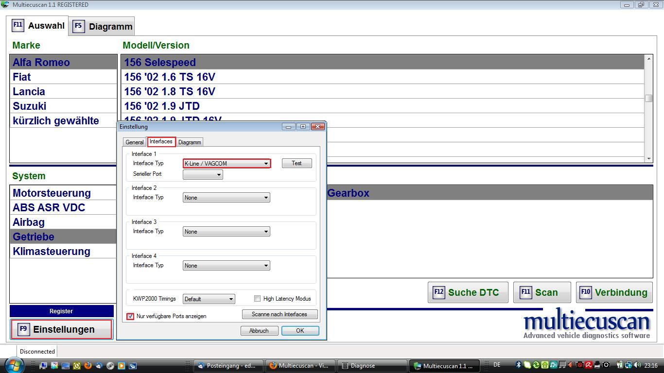

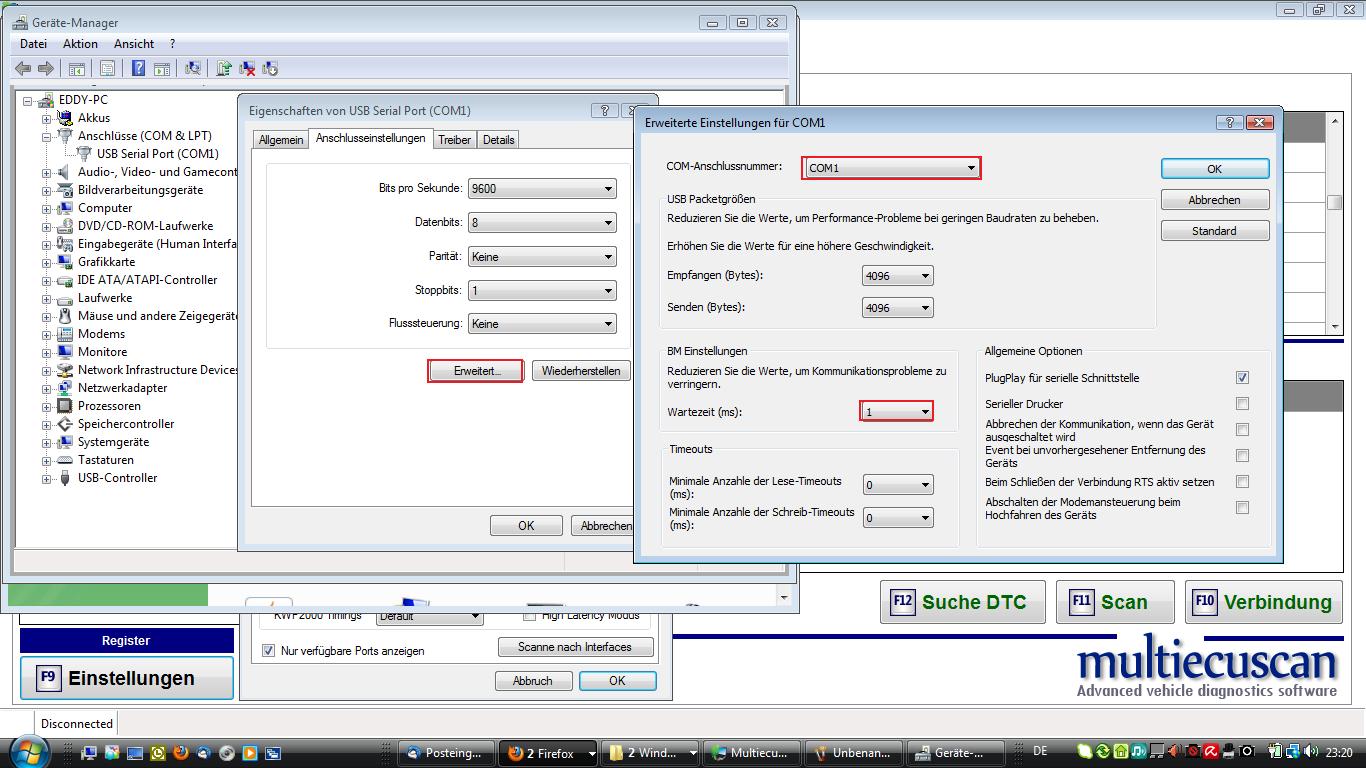

Re: Problem with reading ABS and Airbag
Posted: 24 Oct 2012, 21:35
Hello Tim
Install this FTDI driver for your interface and Windows
And then make your settings are marked as in the pictures.
Einstellungen Systemsteuerung.jpg (173.8 KiB) Viewed 8983 times
