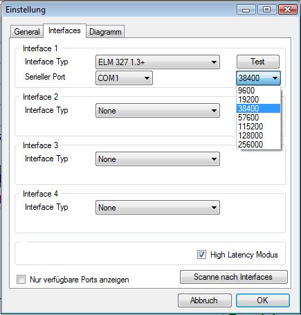

Posted: 02 Mar 2013, 08:46
Hmmmmm???
Strange thing trying some different speeds
instead of 38400
Or other ELM Interface
Otherwise, I do not continue, sorry
ELM Test.jpg (35.42 KiB) Viewed 5937 times
Re: Not connecting to dashborad node
Posted: 02 Mar 2013, 09:40
by Beaniesbcfc
Ok i will and thanks for your help Eddy
