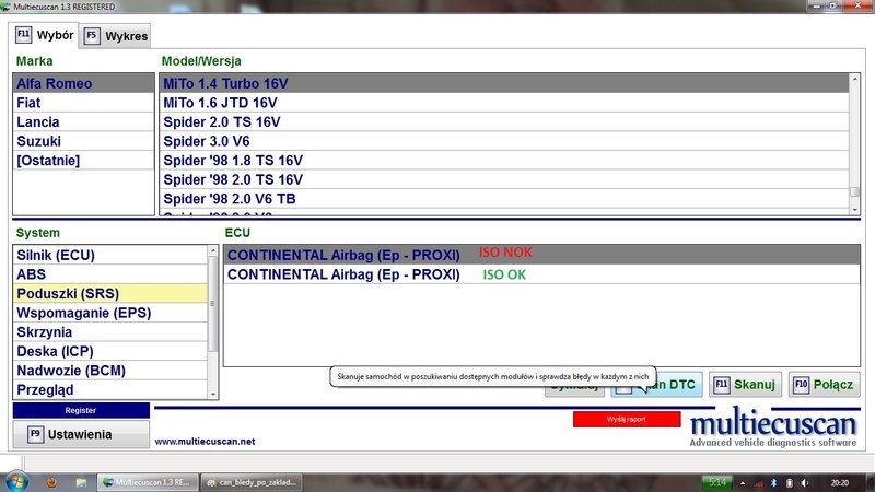

Sometimes I have errors in BC like B1044, B1067 and rare B1044 and B1051 (before proxy alignment). Could that have something in common?
Why when connecting to the air bags have a choice between two control units?
Trying to connect with one gives a message that is incompatible with iso code.

When trying to connect the airbags have a choice between two continental drivers. The first reported error code like a bad iso.
Maybe this is the reason for the wrong alignment proxy? Can you try to swap the selection or delete it at all?
I sent you a full report from the MES.
I care about this because in the future I want to replace BC (cruise control and measuring resistors for low current circuits - LED).
Yani, please try to solve this problem.

Yani,
I found a solution to the problem!
During the proxy alignment may be no seat belt fastened. I have an extension cord plugged in all the time with the child seat belt.
After unplugging the proxy alignment of NAB has been made​​!
I have uploaded the logs.
