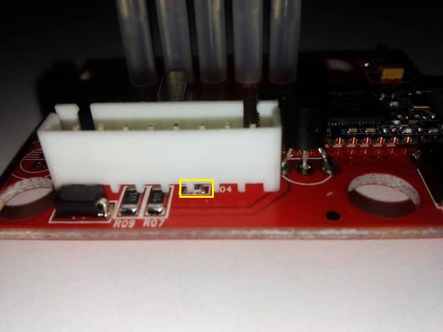

I have a problem ...
without adapters work perfectly, but I can only enter the engine control unit
with the adapters does not enter diagnosis
Re: Problem Elm327 1.5 bluetooth
Hello cerasaro
What car and what control you want to read?
But according to your description, this is the known CAN bus problem
We have described here several times.
viewtopic.php?f=5&t=1493
Remove the yellow resistance and your interface will work
97746110201163325705899 markiert.jpg (27.54 KiB) Viewed 2312 times

after I removed the resistance will still work on the engine control unit?
I would like to use it a bit with all the cars
I bought the 3 cables adapters
after removing the resistance work?
