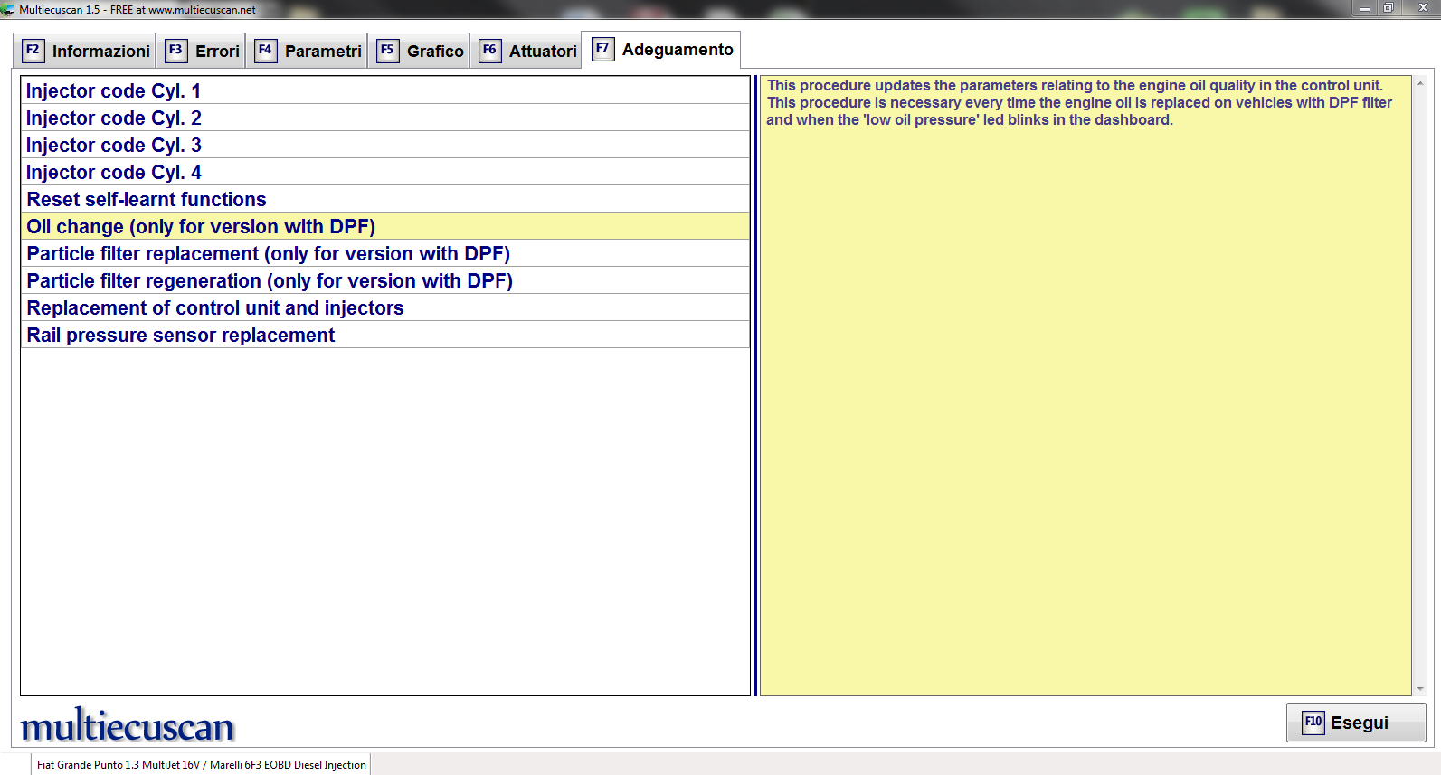

bircastri
Joined: 14 Feb 2014, 10:30
Re: What reset for change oil?
Post by bircastri »
Grazie per la risposta. In pratica devo eseguire solamente questa opzione?? Evidenziata nell immagine?
Thanks for your reply. So I should to execut only the option selected in the image?
s130
Posts: 1067
Joined: 20 Jan 2010, 10:07
Post by s130 »
Yes
