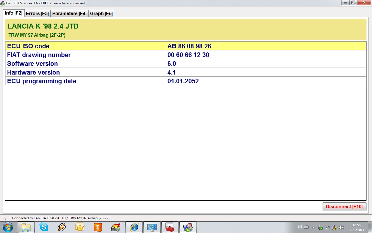

Hallo from Bulgaria,

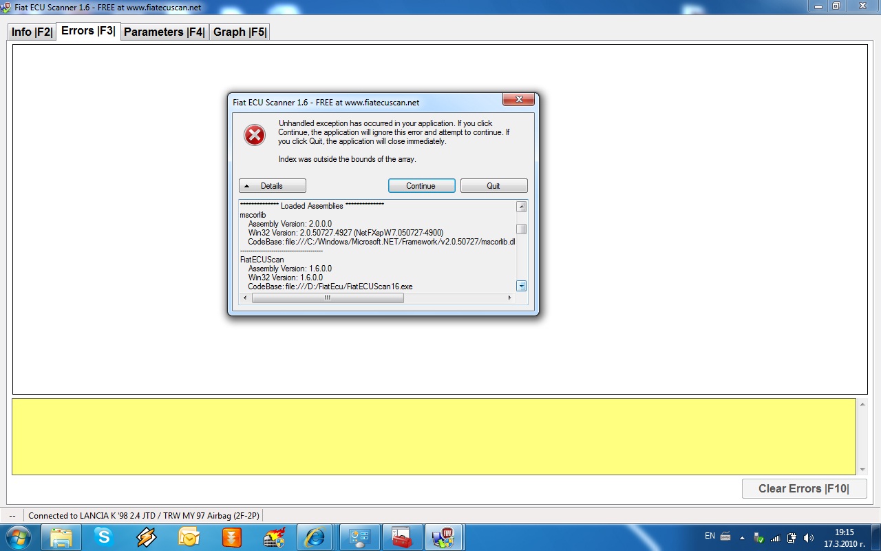

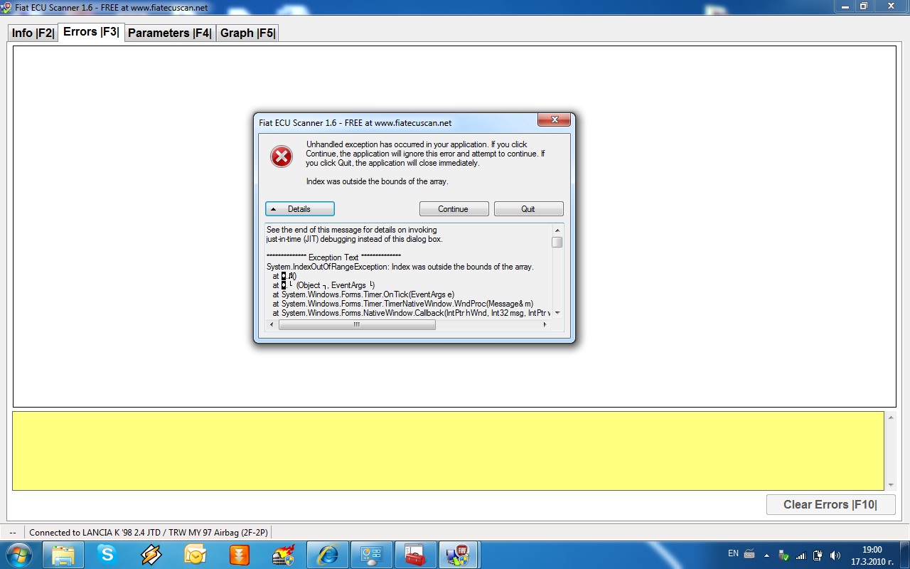

I have problem with Lancia Kappa 2.4JTD at 1998 appears a error massage about JIT debugging and I cant delete the error
Can someone help me what I've to do ?
Please see the attachment files I made some screen shots

hi did you get anywhere with this as I get the same on my alfa 156 2.4jtd airbag
Steven
Re: Problem with Lancia Kappa Airbag
It is a bug in the program. Will be fixed in next release.

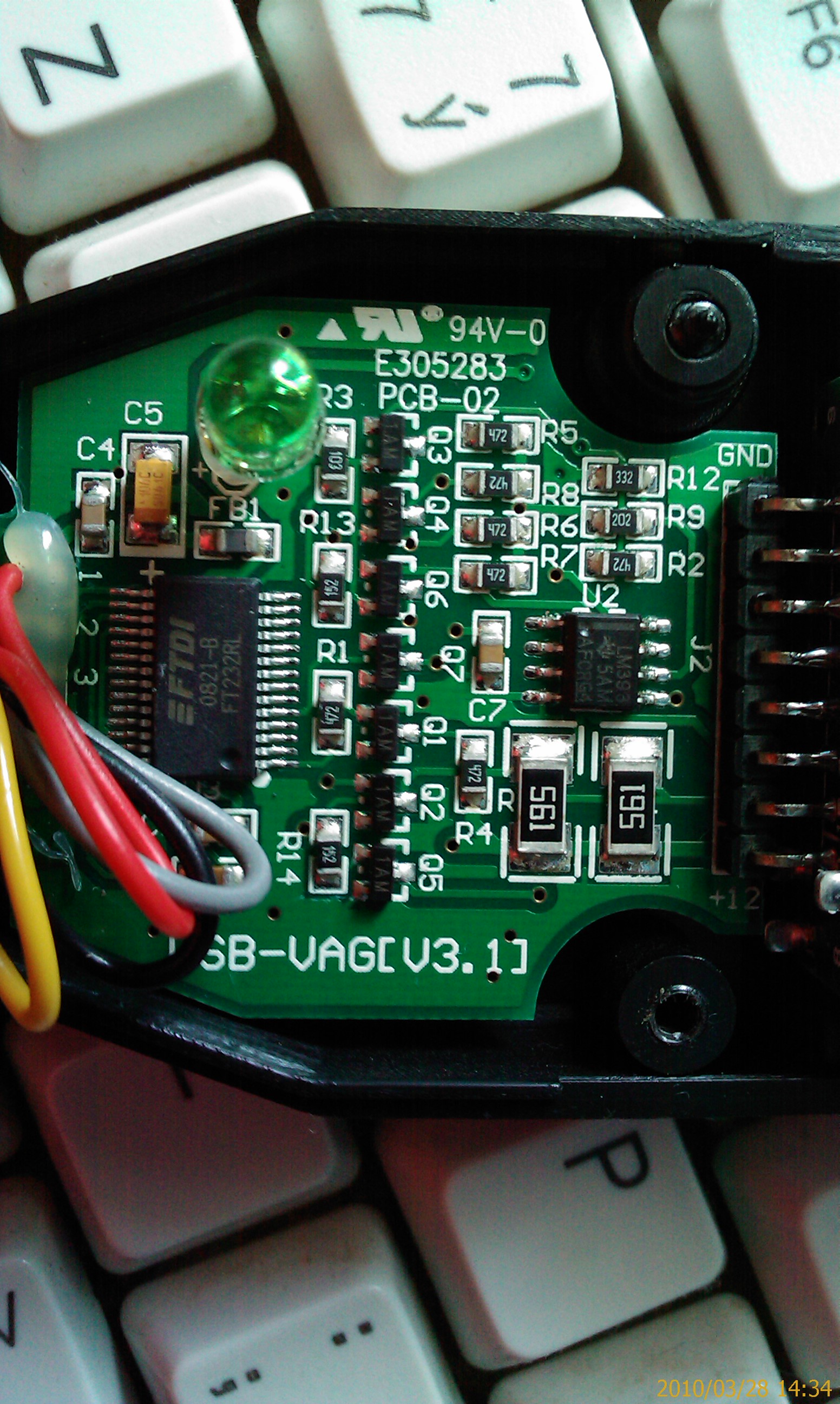

I have joined pin 3 with pin 7 of my lead without the dip switches as i have not yet sussed out exactly how I will make the connections for them inside the lead?
Dropped the ESB port settings to lowest rate as per instructions and hey presto i have communication with both Engine and airbag ecu's
I did make a fix, but the problem still exists in version 2.0.... Hope to have it fixed in 2.1...
