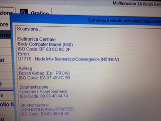

Following a switch from uconnect 5 '' to a uconnect 6.5 '' live I encountered this problem
Finished the physical installation of uconnet live 6.5 i had flashing kms fixed with the alignment
I connected my elm327 and I did the proxy alignment and it happened a strange thing ..
The first is that the parking sensors display (the rear car only) has changed the matrix display now I see the front and rear graphics.
And the other problem is that I have perennially error u1775 node telematic / convergence info (in the central electronics section) I think both blue & me and my car did not see that it is set up with the new uconnet system (my2014)
In the instrumentation section, the new navigation system is unknown / unsupported
I attach photos and ask for clarification

Hello Friend!
In my opinion, they have not completely changed the proxy, but only partially.

I continue with the discussion ..
After erasing the error 2/3 times it has not been reissued again ..
So the u1775 error is no longer
The real problem is that installing on my friend my 2014 an uconnet live my 2016 navigator and activating the bit suggested by yani in private to another alpha forum user for the precision bit has been brought to 90 i changed the graphics Parking sensors ... now I have front and rear while as standard I only have the rear ..
I wanted to know if there is another bit or change the value to still have the live button and the correct graphics
I attach my original proxy without modifications .. maybe yani knows how to explain how to change to have the live features
There is another problem with this navigator
I do not see as an option the synchronization of the time with the gps where the series should be there
Here is my proxy without any changes

I have the same problem, if it finally worked for you could you publish your final proxy if possible?
Re: Proxy problem after alignment alfa romeo giulietta
Posted: 09 Mar 2025, 09:46
by chrener
Hi share your proxi string because without seeing bytes we are not able to fix your problem.
The best way is load whole FESlog file or copy/paste it here on the board...
Regards
Posted: 27 Mar 2025, 22:42
by carletes45
30 34 31 39 31 30 31 36 30 39 37 4F 55 54 50 55 54 2D 4A 49 54 20 13 09 18 4F 04 00 05 10 00 00 00 09 04 00 04 10 00 00 00 C7 C7 51 07 8F 00 3C 20 00 00 00 16 00 07 01 9C 06 2B 03 46 00 00 92 40 3A 41 0A 7C 00 00 00 00 09 01 00 00 00 37 01 E1 01 38 00 40 00 00 00 00 40 00 00 00 00 00 00 00 00 00 00 00 00 00 00 00 00 B1 00 00 00 00 00 10 8B 12 00 10 00 00 02 41 00 17 00 00 00 00 00 00 03 F3 00 D3
giulietta 2.0 jtdm 2015
install u connect 6.5 live
PROXY CORRECT?
