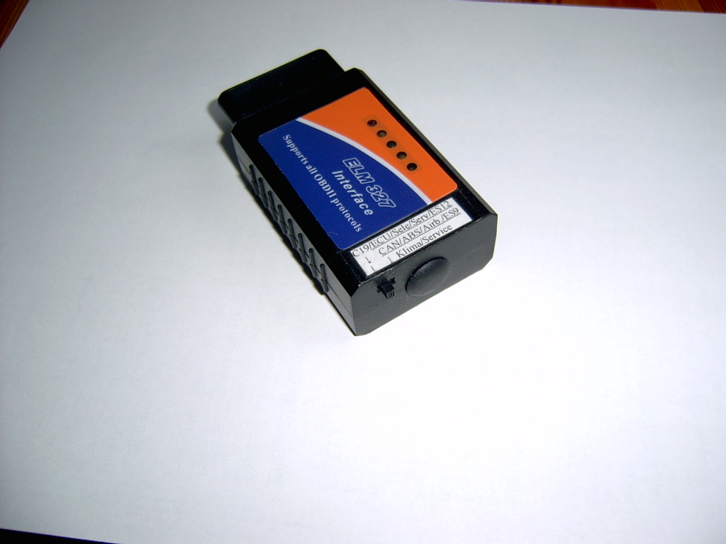

You need an ELM 327 Interface and for some controls
in addition the yellow adapter.
The other adapter (green and red) you do not need for your Punto
That you can buy in your linked Store.
http://www.idiagnostics.co.uk/
Only to view the links of a dealer I know.
http://www.ebay.de/itm/Interface-AutoDi ... 257c25ea0f
http://www.ebay.de/itm/Adapter-A3-Multi ... 23293c4381
Compatible with Multiecuscan means to this interface were modifies
a CAN bus read error to get around.
With the normal ELMs commercially MES is not possible CAN bus to read data.

I also bought some of them in China and some of them died and some of them I could only work only engine or CAN system... :D
