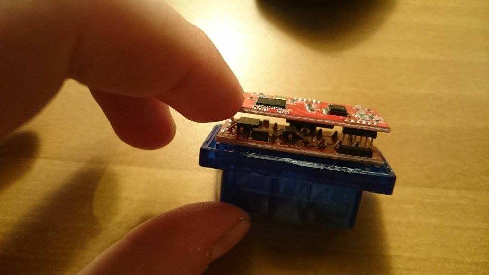

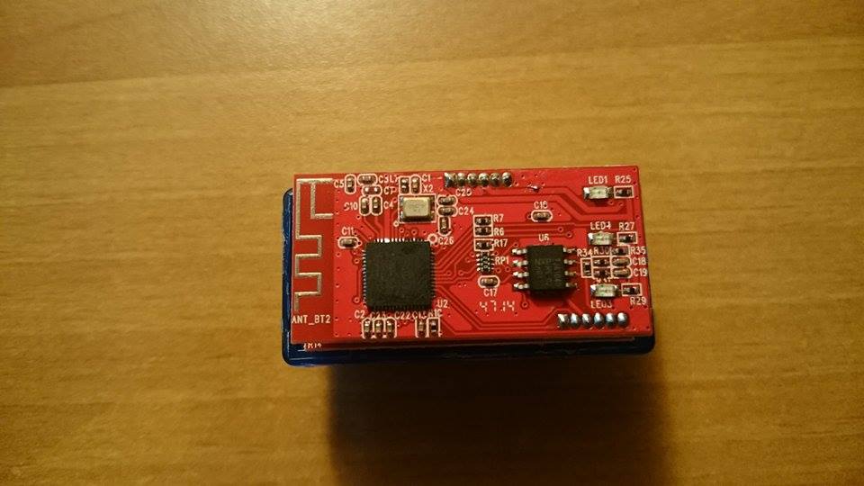

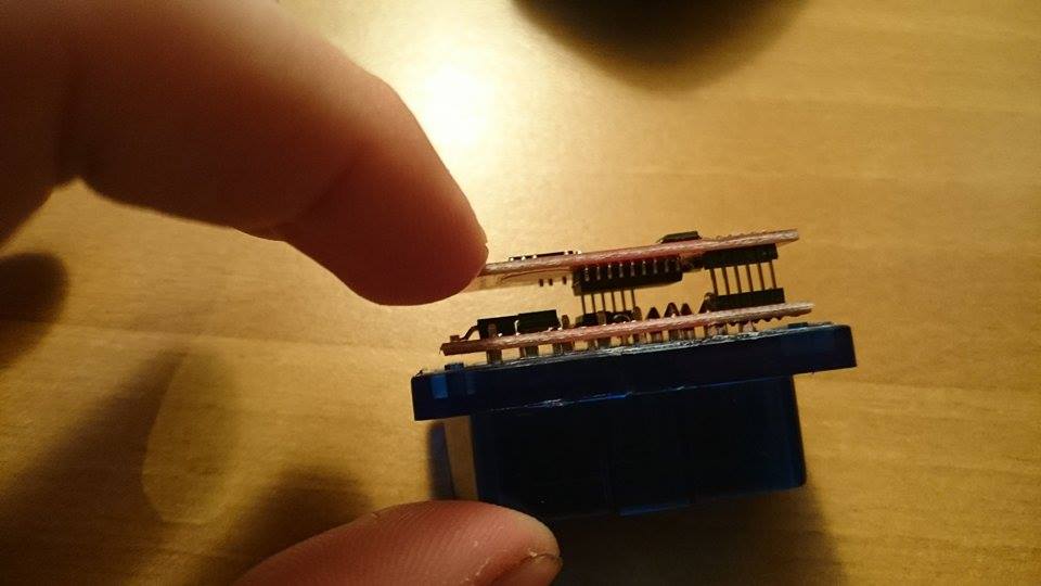

Hello everyone, can someone please tell me how to make this ELM327 BT mini work with alfa romeo 147 2007. jtdm ECU Bosch EDC16C39 CF4/EOBD, it cannot connect to the ecu. As im informed i need to remove a resistor but i dont know which one. It works absolutely fine on Toyota Yaris. Help please

Hello King Ra 2
The same question again
What car?
What year?
What control?
Edit:
Your ELM has no bridge resistor, this would be the usual way to R4
But why is marked on your image before R4 with red frame ???????
This I do not understand?

The problem is that I cannot connect to my ecu at all via bluetooth over AlfaOBD, Torque, DashCommand etc. It connects to my adapter but not to the car (no response from ECU problem). When torque is trying to connect to the ecu, my instrument cluster has gone crazy, randomly turning on and off, car had hard time starting. My friend al Alfa forum in Croatia told me that he had a similar problem and he removed a resistor and everything was fixed. So I try to remove R34 and try to connect to my car?Alfaeddy wrote:Hi Frosty 984
Also this answer has already been answered several times.
The engine ecu of the Alfa 147 is not read past the CAN bus protocol
Thus, no resistor may be the problem.
but only settings or drivers
And since I do not believe that the software (MES) has been changed in any way
it can only be other errors.
At your Toyota you use other software, so it's also another problem![]()
Edit:
To control when read with a CAN bus at your Alfa 147 (body, service, CAN setup ...... your interface was described on page 155
Hello Frosty984
You may like to try and remove R34
for CAN bus protocols must be removed the.
But this is to read the EDC16 useless
No success. Seems like I'll have to order a different adapter. Any suggestions for EDC16 in the similar price range as this one?
