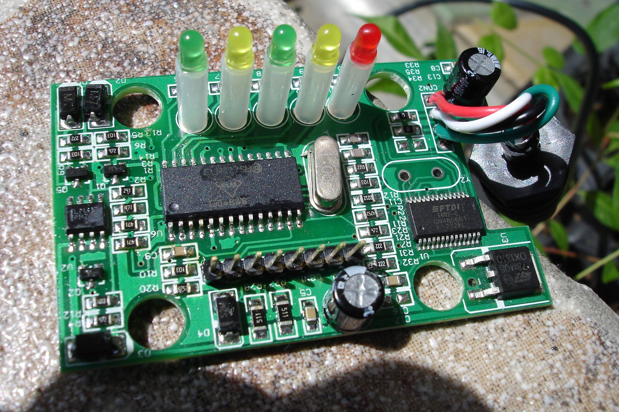

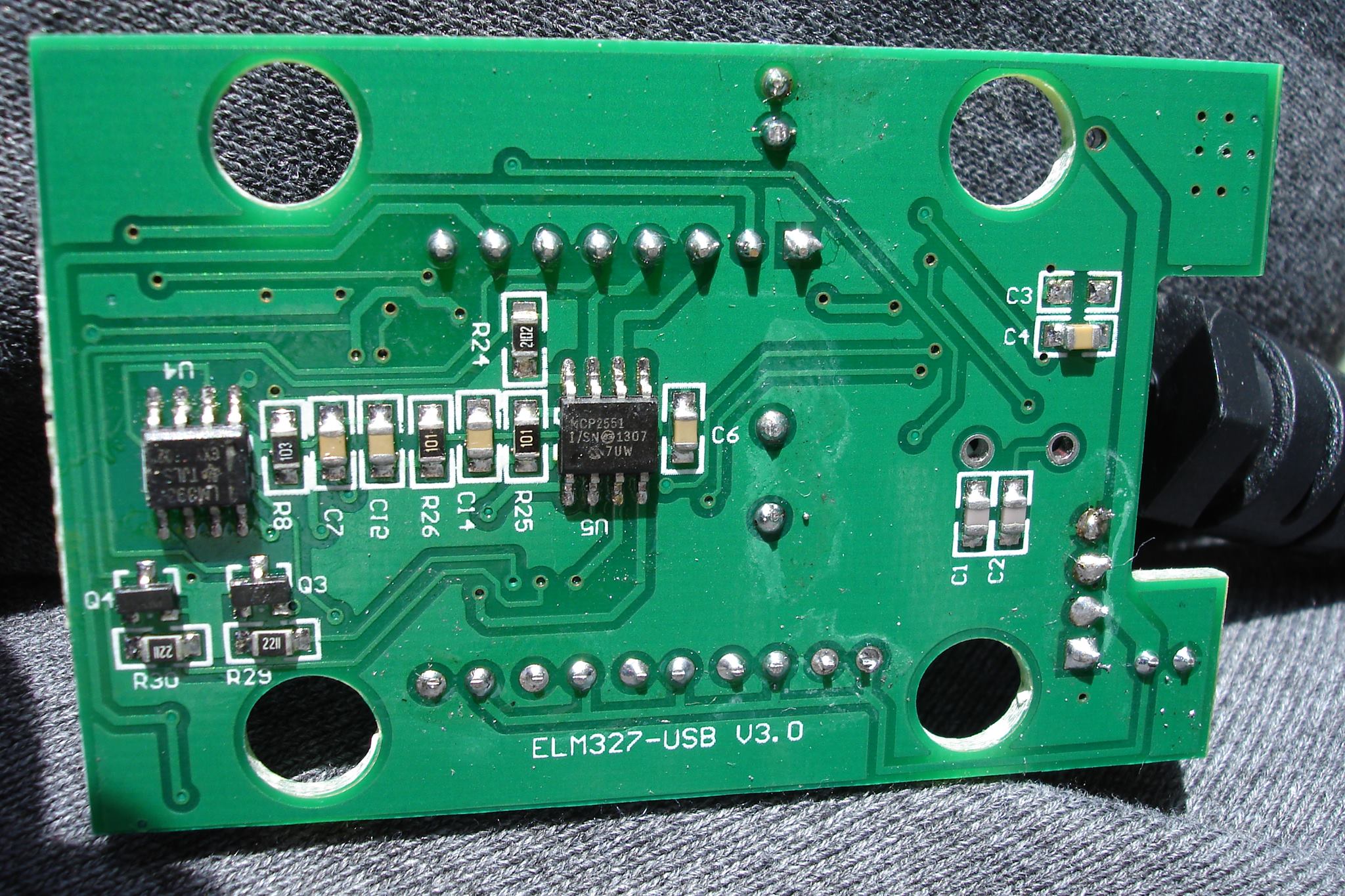

Hey, i read all the post on this topic, but no luk for me.
I have a big problem, I buy a elm327 v2.1, It connect only to engine ECU, not to other ECU.
I want to connect with the wath, to make a proxy aligment.
How I can solve?
Pic:
How I can solve?
Pic:
- 11241033_559218650882829_923512892217970435_o.jpg (437.17 KiB) Viewed 10460 times
- 11206889_559218447549516_7323772240175346914_o.jpg (519.08 KiB) Viewed 10460 times
Hello Tavi
With Interface versions v2.1 is no connection
possible with Multiecuscan or AlfaOBD
You should buy another interface
