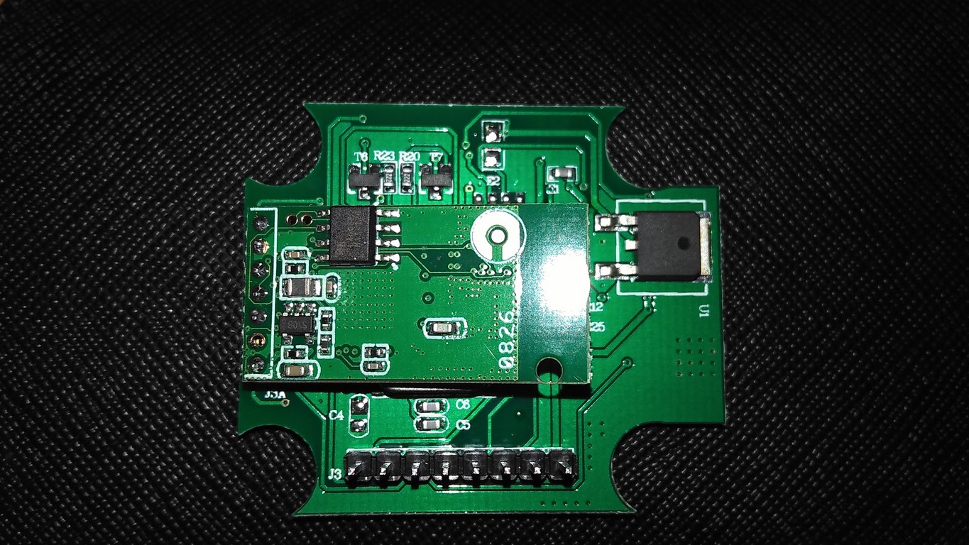

Here is the board layout:

I initially could only connect to the engine module. MES connected successfully to the ELM without any error. I could already connect to the Engine module and read / clear the errors. I could not connect to any other module though. I can also connect with my iPhone using some free OBD II utilities.
But I wanted be able to reset my Service indicator. And to do that I needed to connect to the Service module.

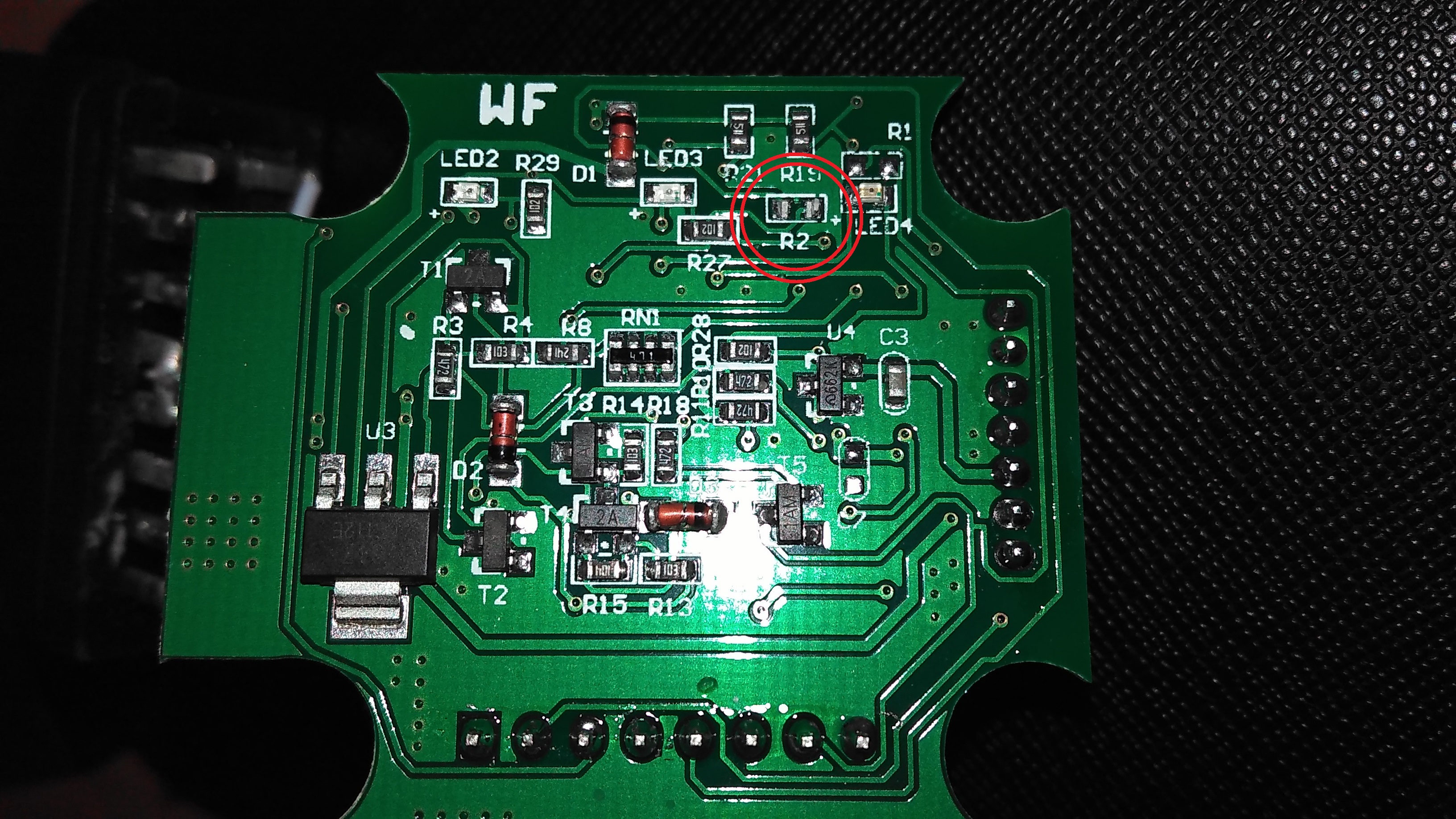

I have already opened the box removing the four screws under the orange stick and I found this:
mounted (Copy).jpg (274.14 KiB) Viewed 13422 times
This is the pcb without the white connector (I think the little board solded on the main board is the WiFi Module):
front (Copy).jpg (338.42 KiB) Viewed 13422 times
And I see this (rounded by red circle) R2 Resistor (it reports 121 on it) on the back plate of the pcb but i'm not sure if it's the cause...

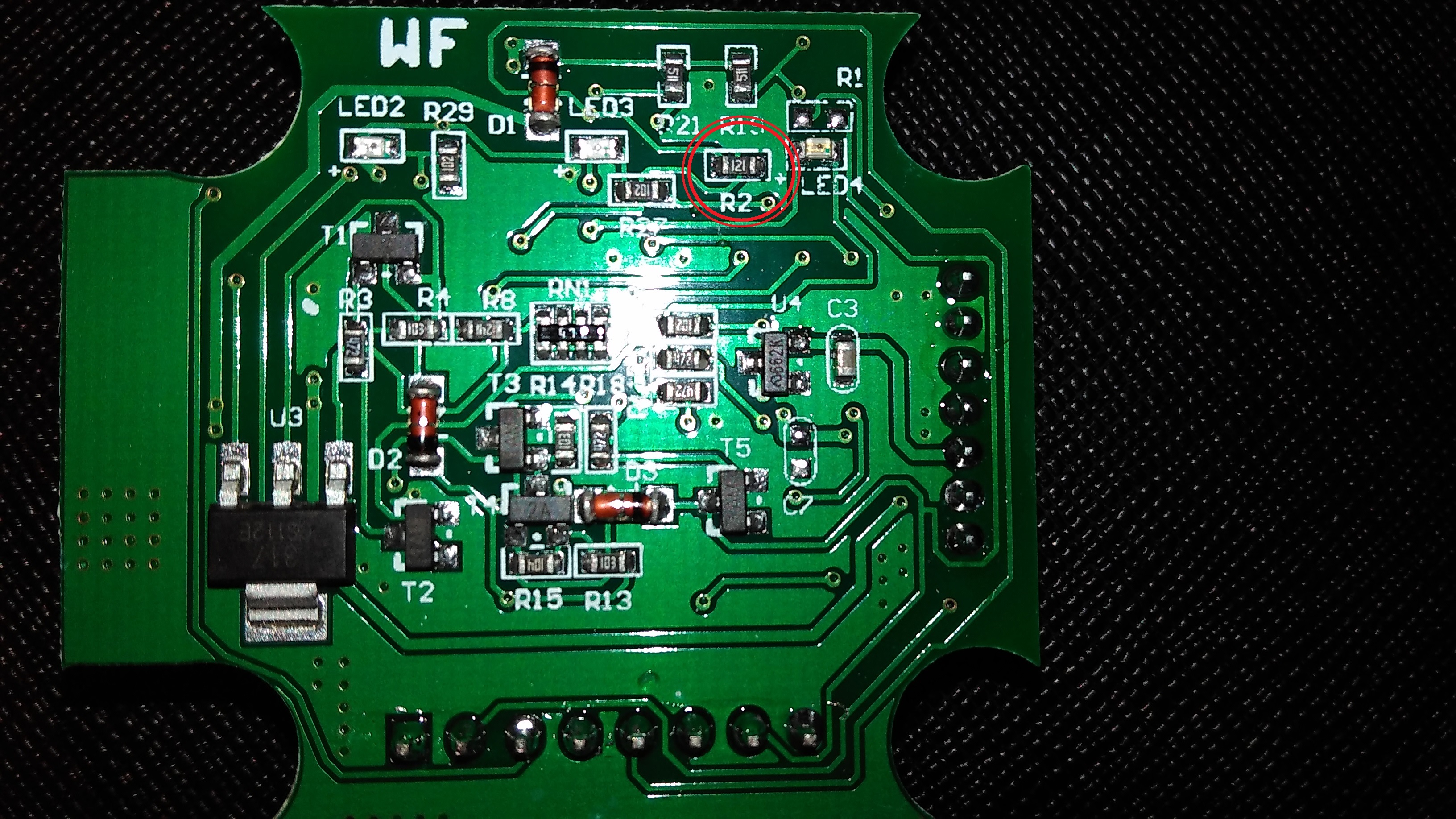

Finally I decided to risk and remove that resistor... and now everything works fine!
Nothing changed connecting the device without A3 cable (I think it is an hardware limit), but now when I use the yellow adapter A3, the program let me read all of the other ecu and I can reset service, alarm belt, modify kilometers counter (increasing), test every lights on the instrument panel, check for relative errors and other stuffs.
Here you can see the R2 (121) resistor removed (Red rounded):
Hope this could help everyone with the same issue... Bye

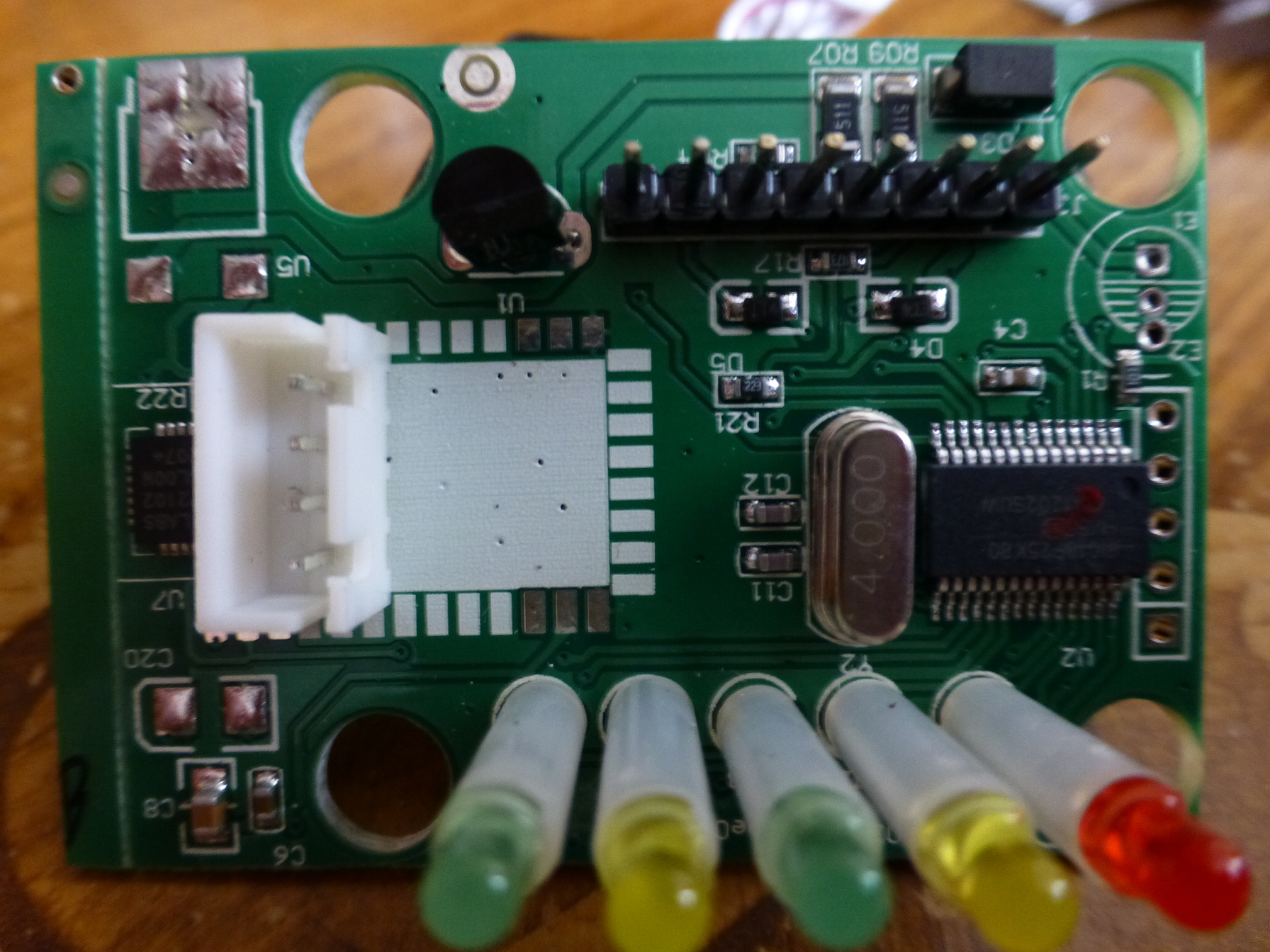

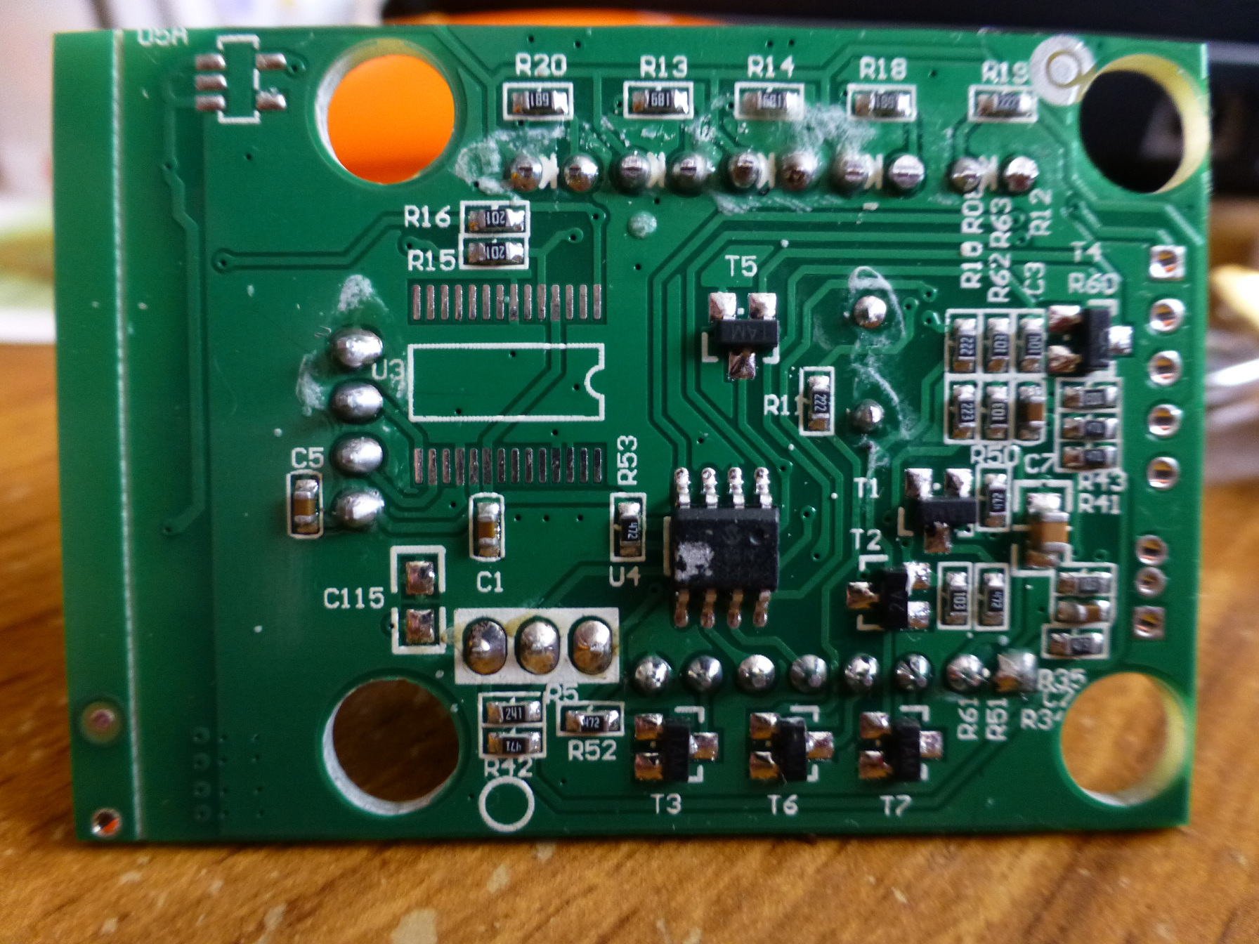

Hi szes30, I've just watched your images but I can't see any resistor that reported 121 on it, what kind of device do you have? brand, version etc...

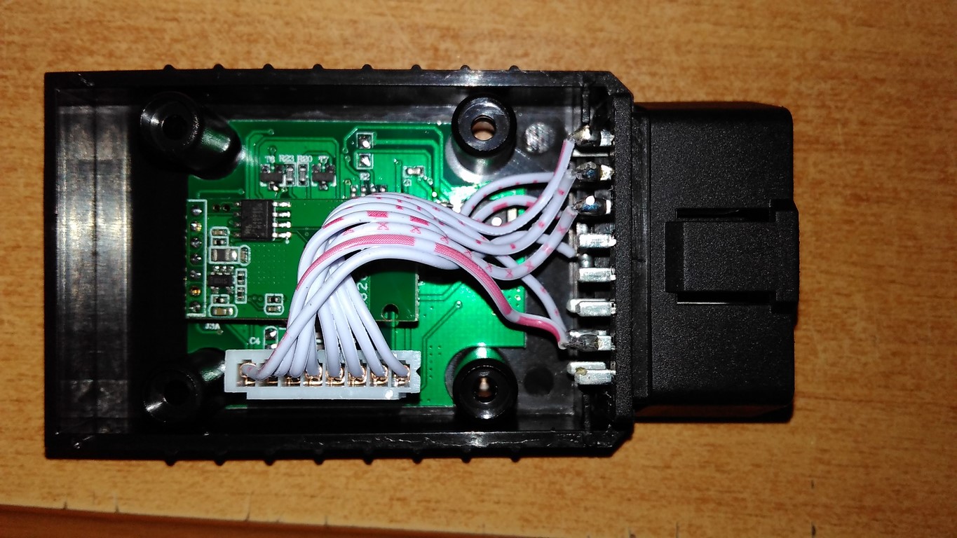

Firstly about ELM327, it was sent from Greek guy to remap my Citroen
DS3R in 2012, so I have no idea where it is from. :(
But I have another ELM327 device, I will upload some photos of it later
today.
Then about adapter cable, I have ordered it but I still have not receive
it, so I modified inner wire of ELM 327. For example, wire which goes OBD
connector #6 was changed to #1, also #7 to #12 and #9 to #14.
I think this works but it doesn't. :shock:

Post by alexandertrask »
