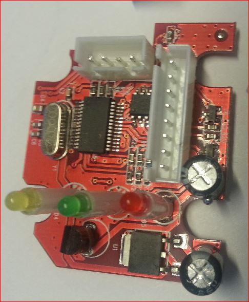

hi following my card. connectin motor no problem but doesnt connect to CAN.
What changes should I make on the card. help please. my car is fiat punto evo
- card.JPG (55.48 KiB) Viewed 9943 times
You can check here what controlers need adaptor A3
http://www.multiecuscan.net/SupportedVehiclesList.aspx
Then your pics is not such a good. I cannot figure it out where is the rezistor that need to be removed.
This is for CAN Bus but as I said you will need adaptor A3 too for controlers on CAN B ( pins 1 and 9 )
Share better pics both sides of PCB first

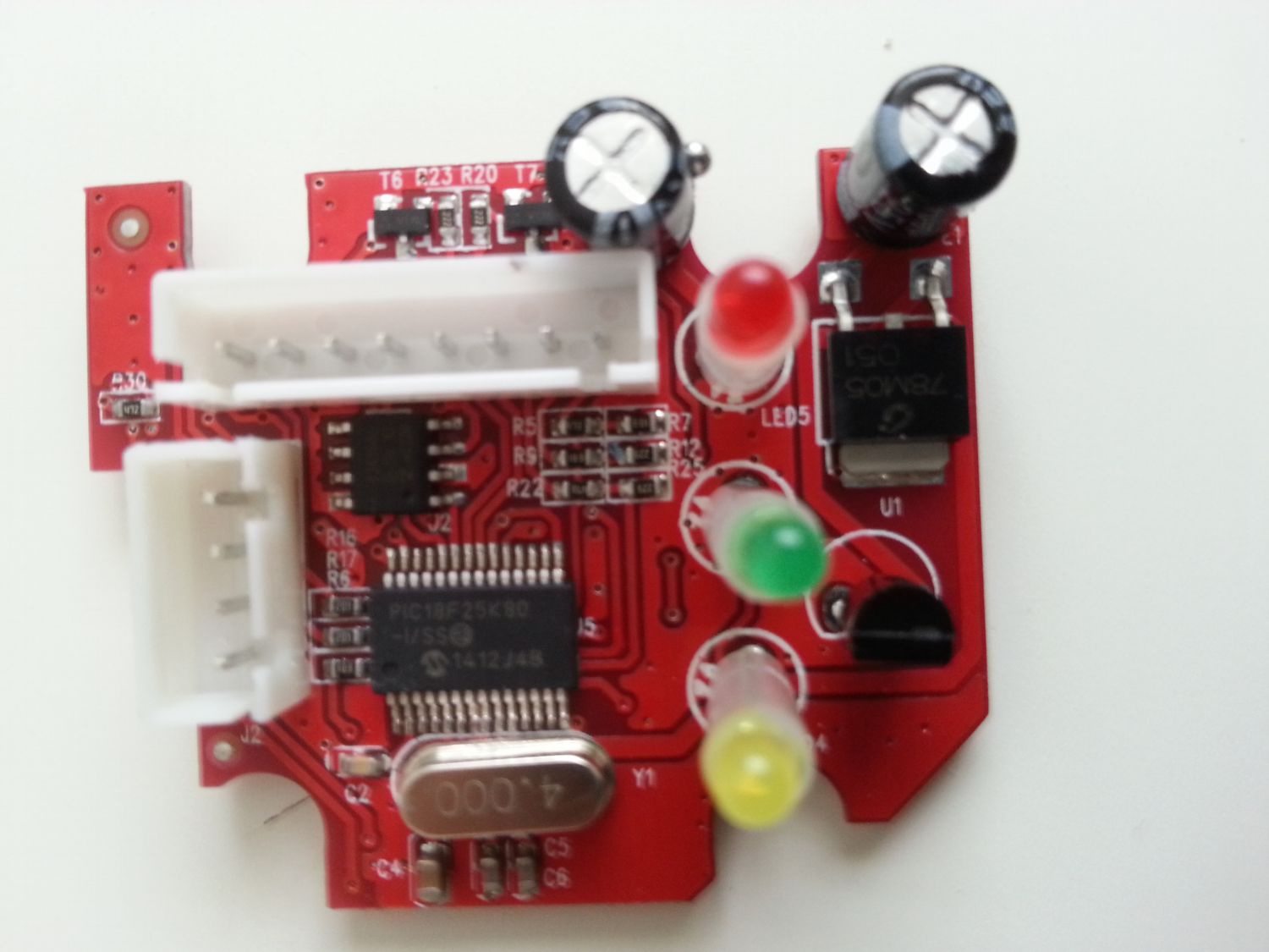

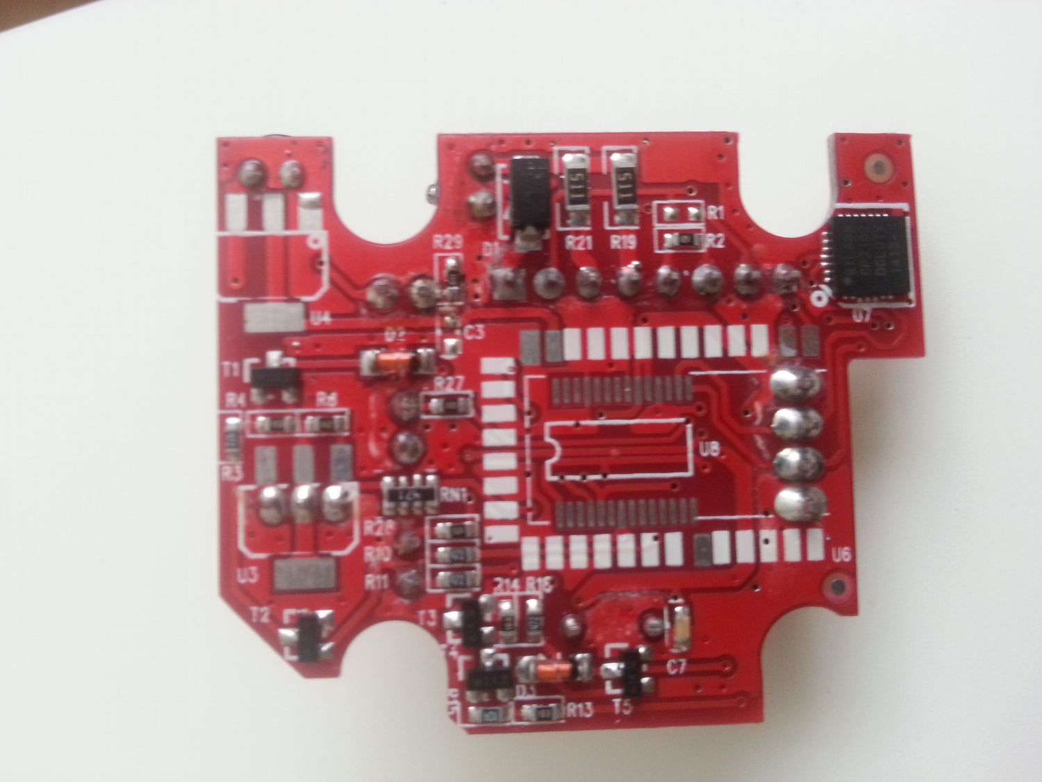

mitix wrote:hi following my card. connectin motor no problem but doesnt connect to CAN.
detailed pictures
- 2.jpg (119.58 KiB) Viewed 9931 times
- 1.jpg (115.47 KiB) Viewed 9931 times
Hello Mitix
Unfortunately, your image is not very clear
But if I am right should be on the back of the bridge resistor R2.
And make time a screen from the MES Interface Test, and please put the one here
let's see if MES can work with this ELM.
Because now there are many interface that can no longer work with MES or AlfaOBD
