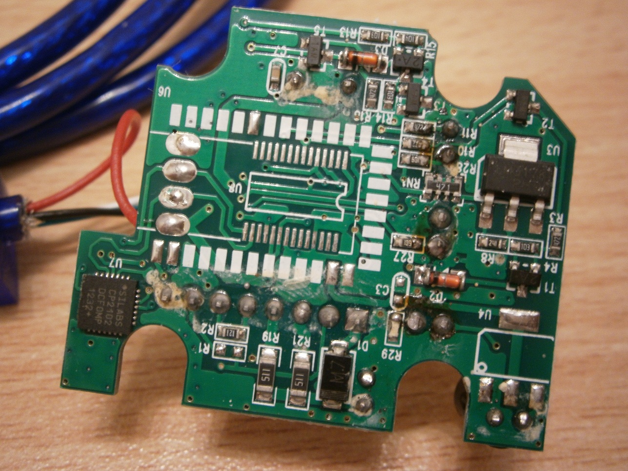

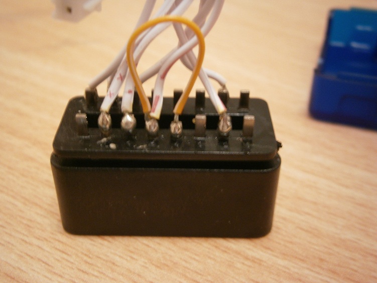

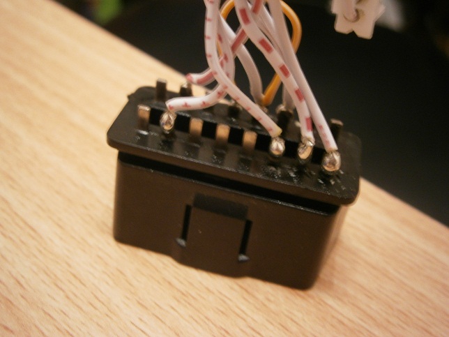

I´ve got an ELM327 interface and I can connect to ECU, but I can´t connect with the service reset or instrumental panel. I have a punto international and a grand siena. In both of them I can read and check ecu and errors, delete them and use actuators and adjustments. I ´ve spent a lot of time reading these posts but I don´t know what to do, should buy a new Elm device or fix (how?) this one. Also FES dashboard didn´t work too. A pictures of the device and the connections.
Thanks a lot.

Another two pictures. Thanks again !

Should it be an older ELM (> 2015) remove R2 (121) if you're lucky
Then you can create a connection

In the rest of the modules are diferent, but I can scan a big part of them with your solution (fixing the device)
I could reset service in both cars.
Thanks you a lot, bye
