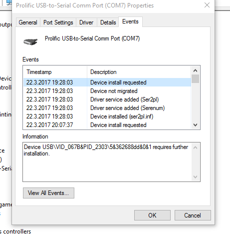

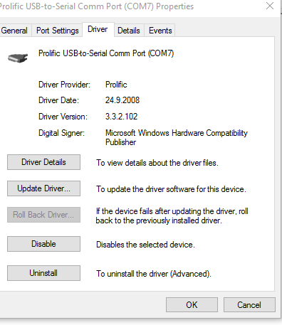

Hello i bought elm 327 1.5a and i first i thought is the driver problems i didn't know unless i saw this thread.
I cant pass the last test on Multiecuscan v3.1.
U can see the problem is it in the second picture
I tried with different ports speeds and its fails in the first test.
Also when i connect to the car its says also that operation has timedout and check ports and cable...
Doi have to remove the resistor ?
- IMG_1124.PNG (30.61 KiB) Viewed 11645 times
- IMG_1123.PNG (50.39 KiB) Viewed 11645 times
- IMG_1122.PNG (16.75 KiB) Viewed 11645 times

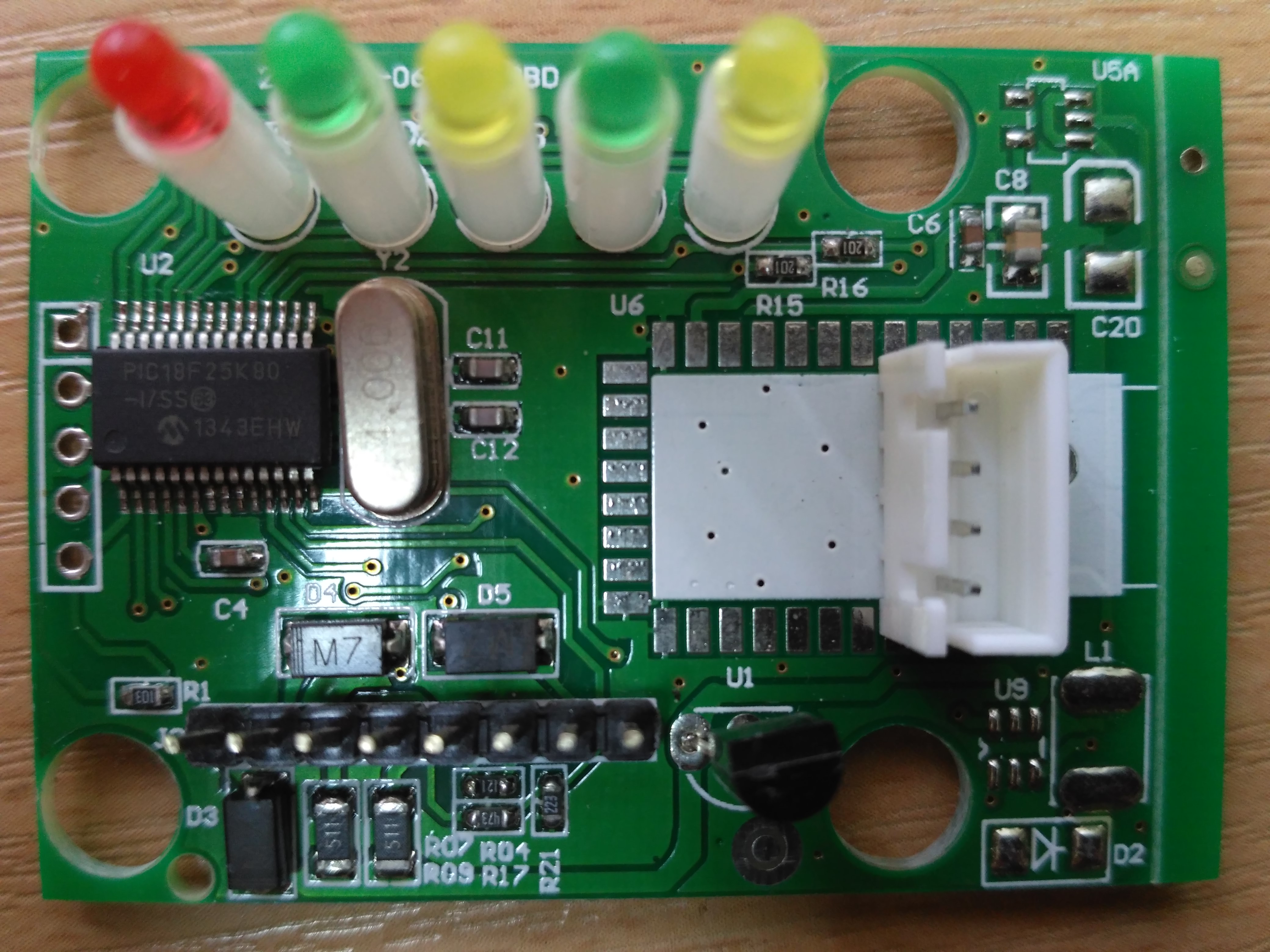

Can anybody help me identify the wrong resistor on my adapter board? I'm having trouble with it.
Car is an alfa 159 1.9jtdm 150
Multiecuscan
CAN pin 6 and pin 14
Remove resistor 120 ohm
Video:
https://www.youtube.com/watch?v=emzyE-zkGmw
Video:

I played with an old KL interface little bit and found out the AutoDia E327 interface has defective the FT-CAN (pins 2+10). It somehow cripples CAN bus of the car so ECUs store errors of the CAN. Supplier KWP2000 (ebay diadig) have not responded so far, so I cannot recommend purchasing it. So if you connect the interface to your car and all lights are on, do not go off, the interface is not good.
https://ibb.co/ijuybF
I would not say that an interface is synonymous mal mal !!
But I know some who bought this ELM and have no problems with it.
Otherwise one should buy the OBDkey interface or here the complete package
With the CANtie Interface !! At a completely different price
At pin 2 + 10 is not a bus or is your Fiat not from Europe ??
Since these pins are used for the SAE1850 protocol.
If your interface is broken you can return it.

Hello Eddy, thanks for response. The interface has connected pins 2 and 10, which according to http://marco.guardigli.it/2010/10/hacking-your-car.html provide FT-CAN (probably B-CAN?, also http://www.alfaobd.com/AlfaOBD_Android_Help.pdf mentions Bus). It confirms errors related to CANBUS if it is connected. You are right Interface is cheap, so it is easier to disconnect these pins inside.Alfaeddy wrote:Hello
I can unfortunately not follow your information?
Again, PIN 2 + 10 is not the B-Can
This is at Pin 1 + 9
Pin 2 + 10 is for another protocol (SAE 1850)
I have written this here

Can anybody help me - where is resistor that must be dissassembled?
my avto is Fiat Panda 2007 year 1.2
adapter is usb elm327 (ftdi chip) with fiatecuscan program
I can see only engine and Gearbox selespeed cfc 228f
