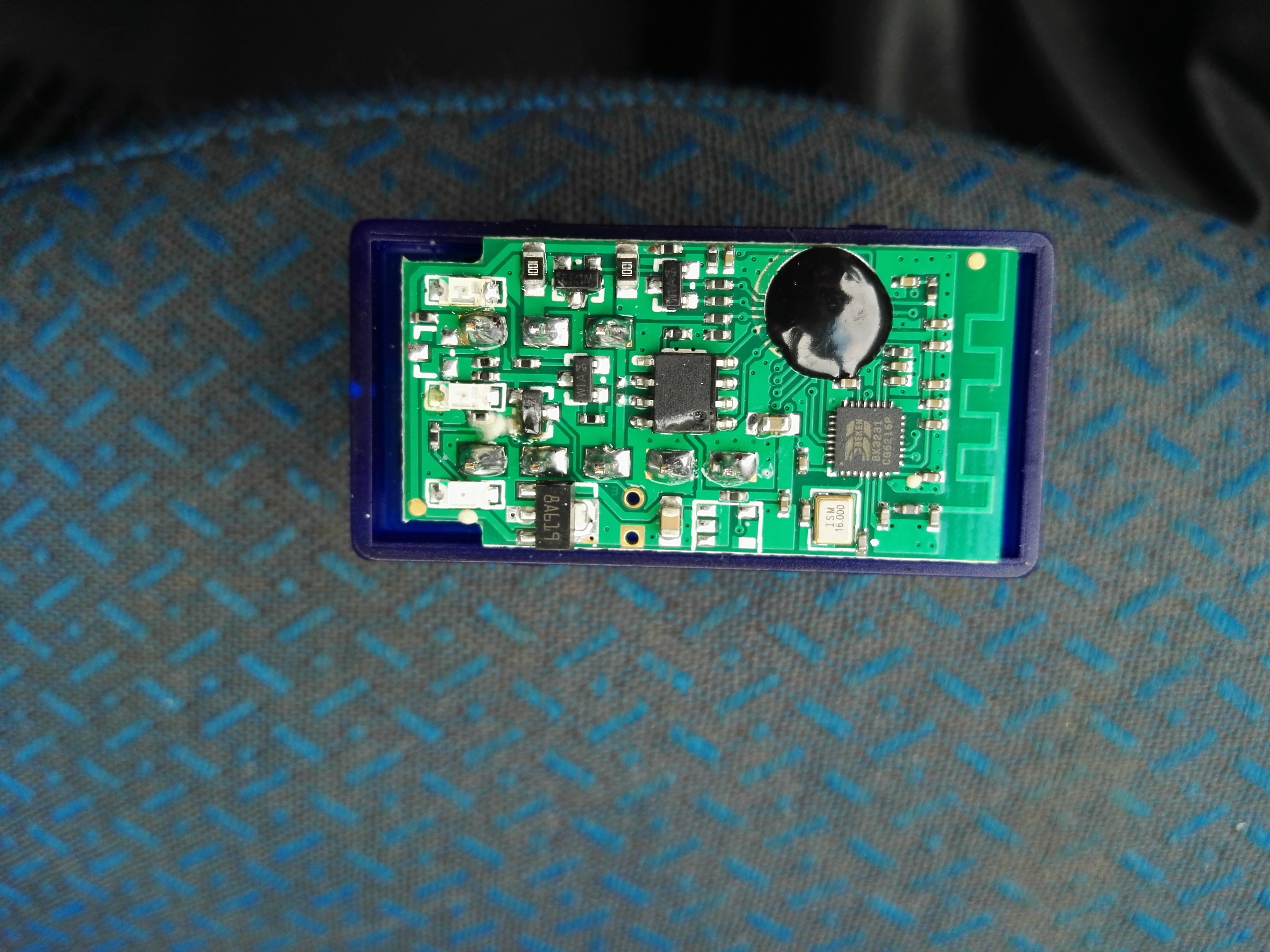

This is mine! It refuuses to connect to the ECU of my Alfa MiTo 1.6 JTDm. Can you help me?
I have to remove the R2 resistance marked 121, correct?
http://hpics.li/5c7ba55
http://hpics.li/2321e8c
Thanks!

Post by cxem »
If U1, CAN then YES.

Post by cxem »
CAN BUS:
TJA1050
MCP2551
PCA82C250
NCV7342

Please, help me! What resistor need to remove in my elm327 bluetooth?

Post by Matchigo »
Matchigo wrote:Hi,
Thanks!
So, I took off the resistance R2 and nothing changed... Any idea?

Post by cxem »
You have the main chip STM8S207
You need the main PIC chip
https://youtu.be/TeeUCoppzJc

Post by Matchigo »
You say I've got the wrong chip, that's it? There is a specific chip for Alfa Romeo?
